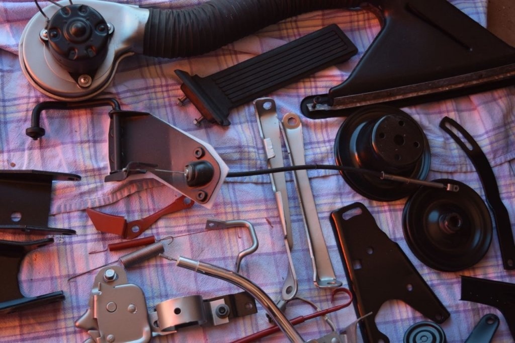

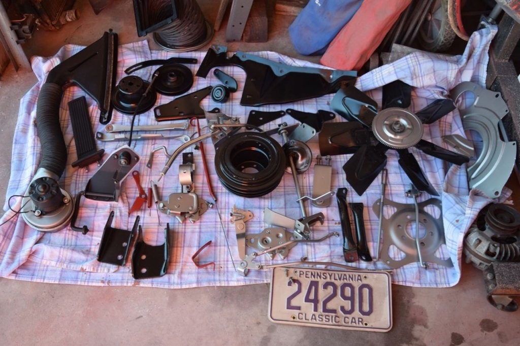

But they will look pretty........Jim, just an FYI on your engine pullies. If you find your belts squeal after installation and no amount of adjustment gets them to shut up, you'll need to remove the epoxy from the sheaves.

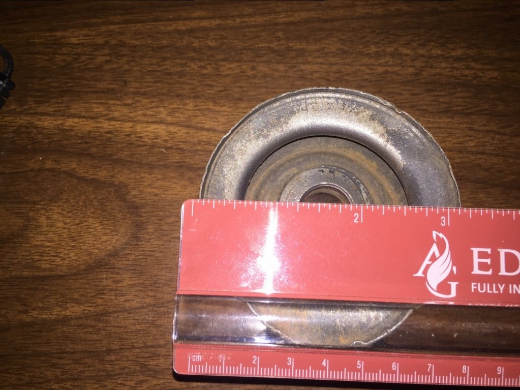

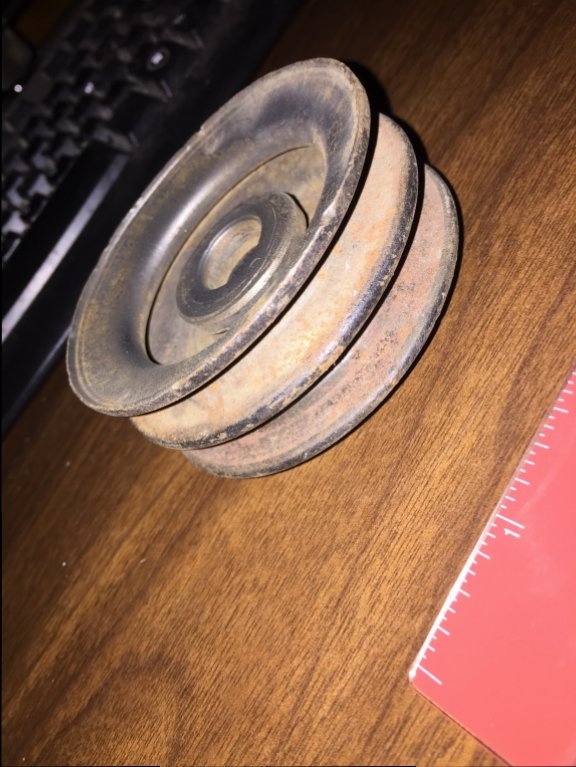

Do NOT tell me that. It is a 2095059, the hub that you use to pull it off is recessed into the dual pulley. The typical/later non-Hemi ones you can see the puller hub if you look at the pulley from the side as it sticks out beyond the pulleys, this one you can't. Oh and they are a bit over 3" around. The others are just under 3" (that is the reason it is possible to recess the puller flange it is bigger around).From the looks of it, I won't tell you I might have one at work. I am going to see tomorrow if I do....

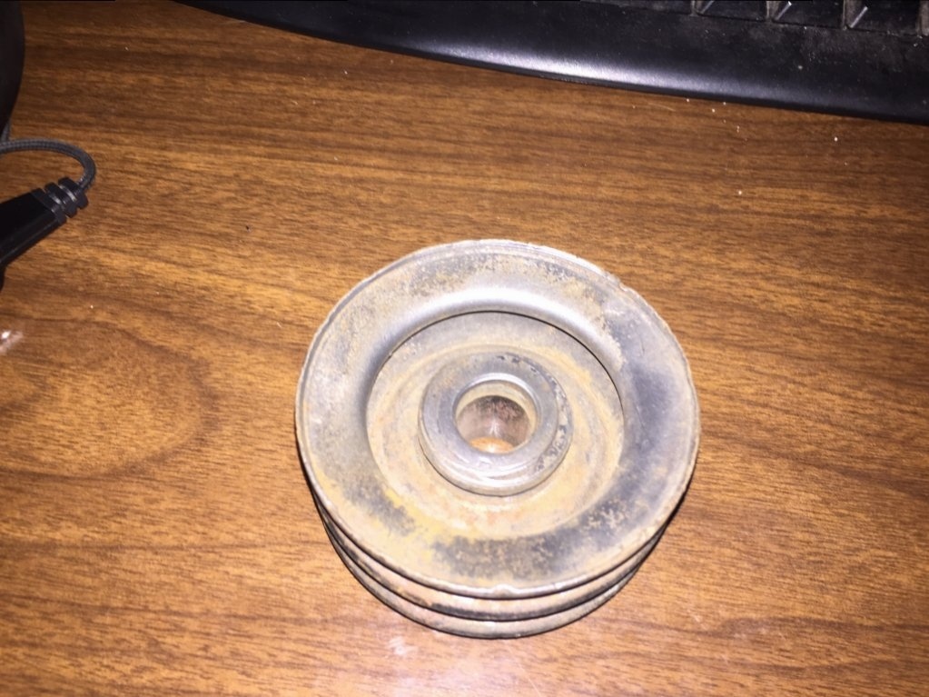

Know what that is worth?View attachment 372208 View attachment 372209 View attachment 372210 I actually had one here, and I will look at work tomorrow, but here is what I have. This one is a dual groove, recessed pulley with a dia of 3 3/16".
If it has the part number I stated clearly stamped $175Until now, I would have thought $10 ish
If not I'll give you $10 and put the one I have back on eBay!If it has the part number I stated clearly stamped $175
I'll leave the Hemi pulley. It will be a good story at car showsThe complete number is hard to see, but 28757xx A previous removal attempt has messed up the last two
