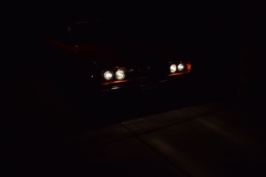

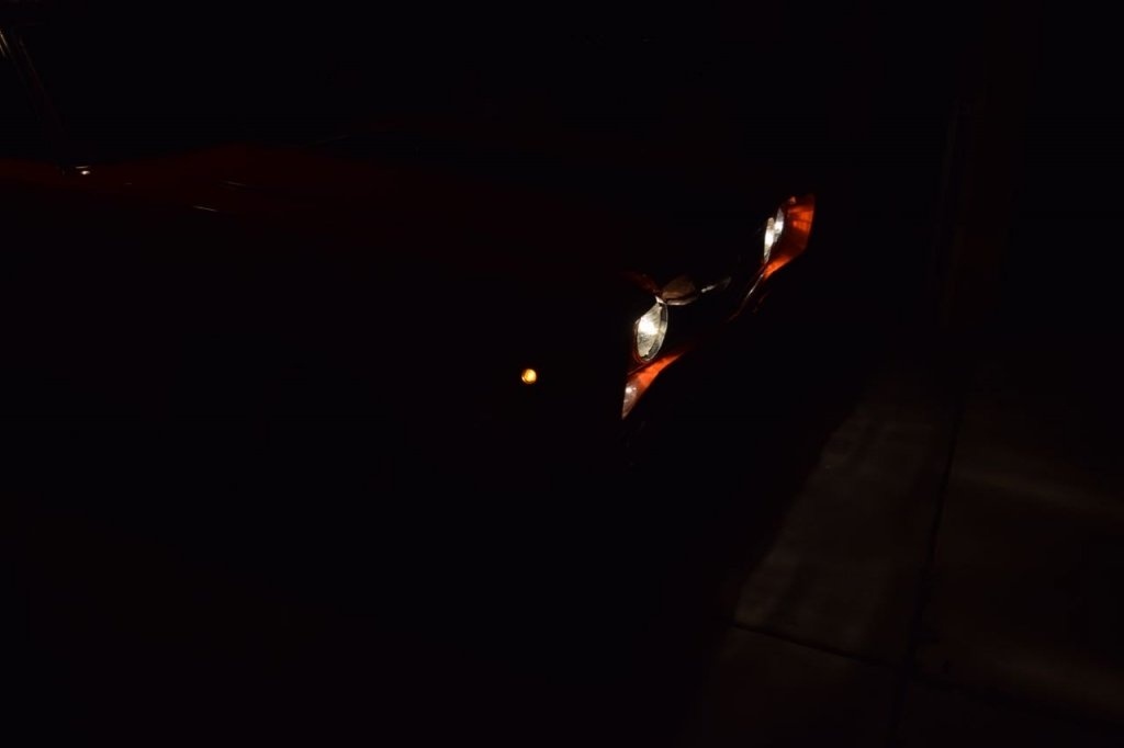

Headlights, all but one marker light (seems like the new Year One harness problem but too dark to debug), console lights, map light, glove box light, ash tray light, key light (but timer never turn it off), radio light, dash lights, 3 speeds on the wiper motor, 3 speeds on the blower motor, AC clutch locks up, the ever so important in Arizona rear window defogger works, brake lights, turn signals, hazard flasher, radio (but does not get any stations in the garage), oil light, parking brake light

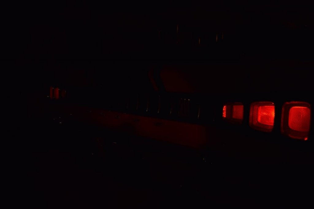

right hand fender top turn signal (forgot to buy bulbs for them, duh) - FIXED
right front marker light - FIXED

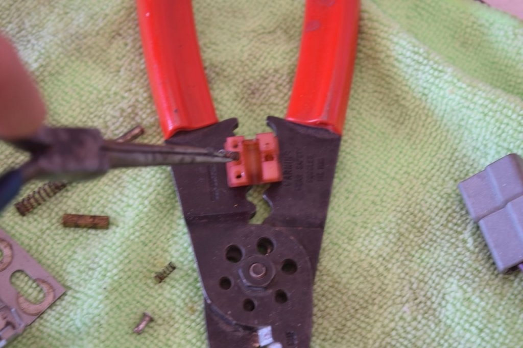

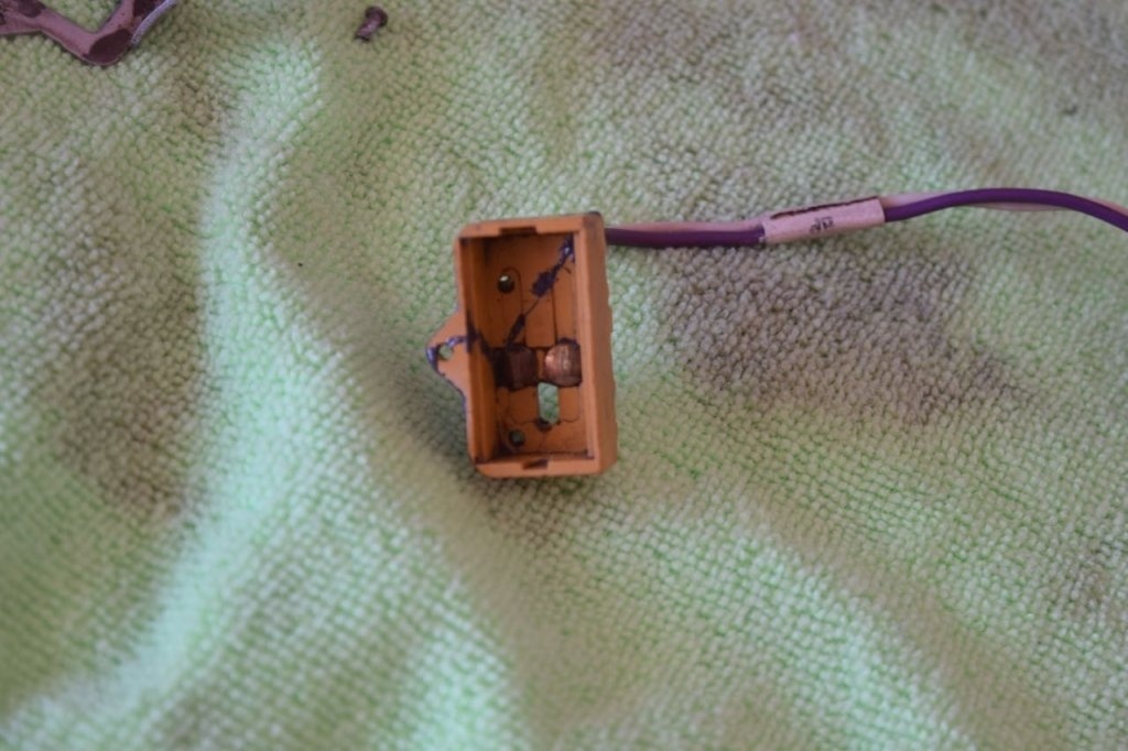

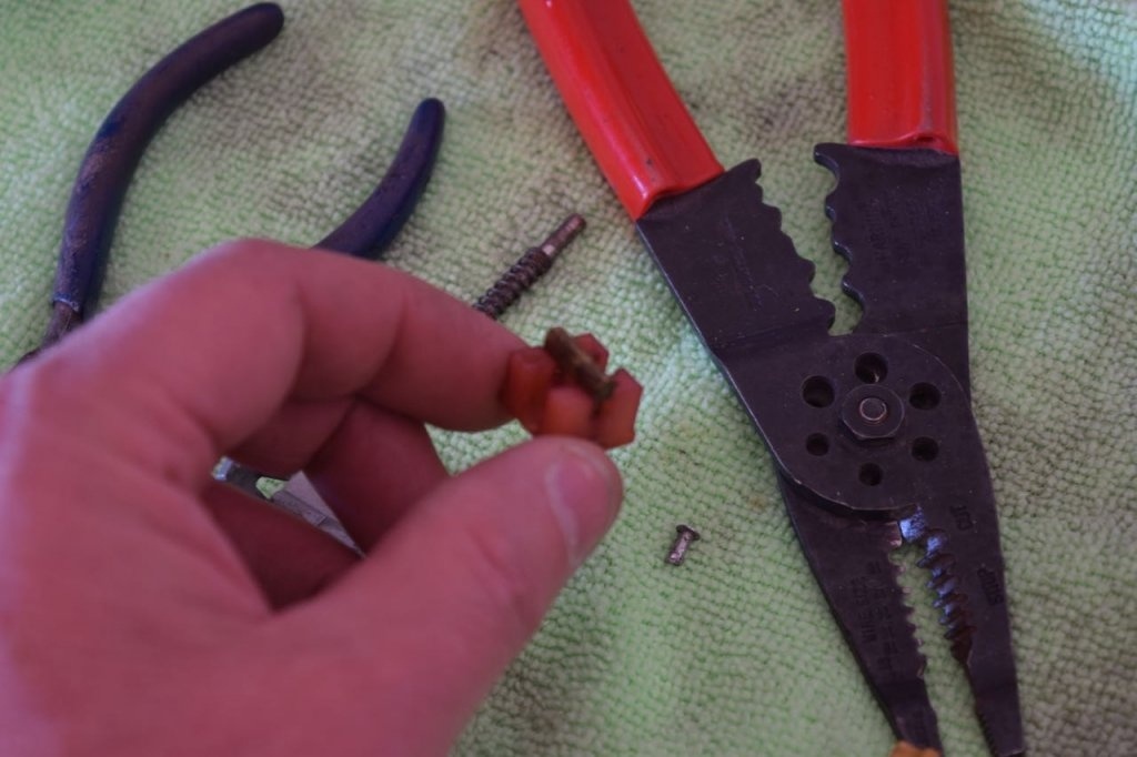

Someone needs to keep me out of the garage! Ok brake light switch adjusted and brake lights working now. Backup light switch is disassembled, cleaned up and the JB Weld is curing to fix the cracked ceramic case. All the parts were still there so I can assemble it tomorrow.
Right fender top blinker and Right front marker light fixed. Corrosion causing bad grounding in the housing. Needed some TLC and DeOxit.

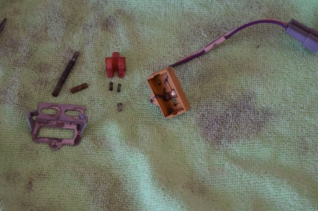

Busy night! Assembled the backup light switch. It was clear the ceramic body was super brittle. I ended up coating the entire thing in JB Weld to give it strength..
It is a cute little design. The bar slides back and forth and when over the 2 tabs in the body it shorts them completing the circuit to the bulbs.

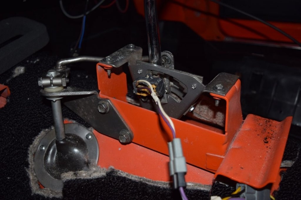

All installed and adjusted with the shifter linkage installed and torqued.

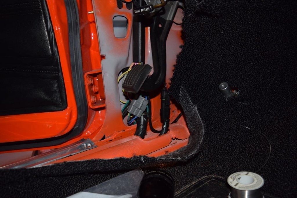

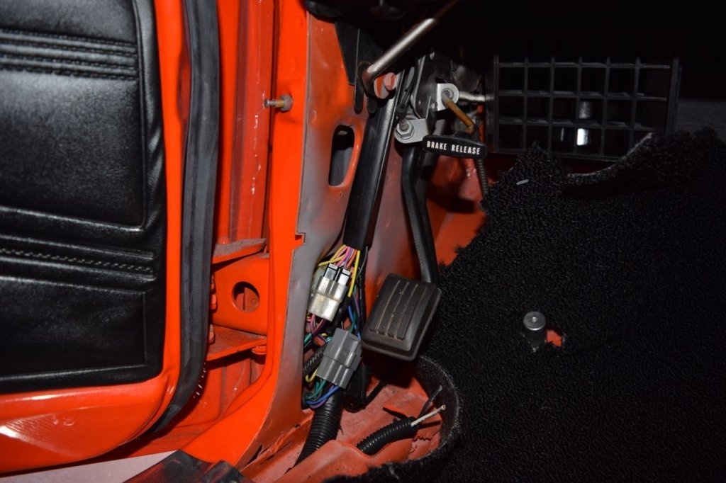

Worked on getting the rearward going wires cleaned up. My understanding is the plastic chase is not reproduced and boy it should be. Without it making those wires clean past the parking brake would be painful.
Finished up by installing the Delco Weatherloc on the 10 gauge coming from the fuel pump to connect to my dash harness.
All done ready to button it up once I am sure I am done rolling the dash forward.

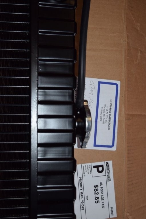

Radiator was sent from Glen-ray yesterday and should be here on Thursday.

No DeOxIt in the back up light switch??!!??
Not needed. It came apart to pieces I could polish with steel wool and metal polish.
Its the Z MAX of contact cleaners. It cleans, coats, protects against corrosion, increases contact life, reduces resistance, adds coulombs to the current, etc, etc.

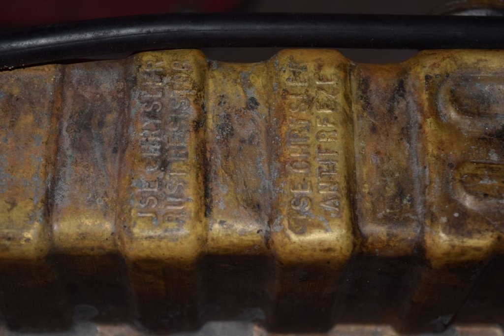

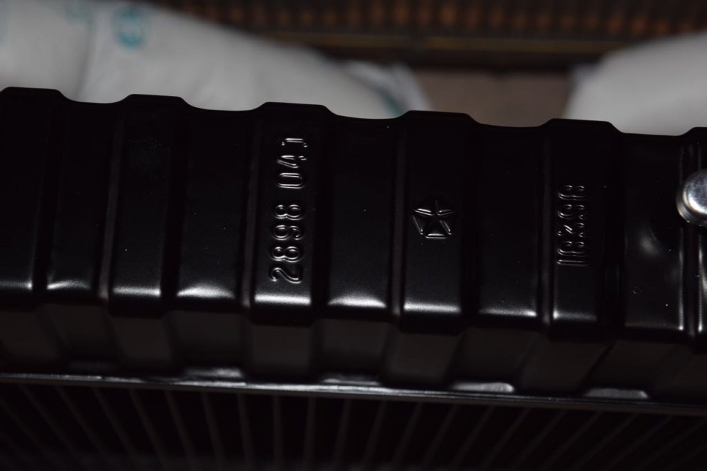

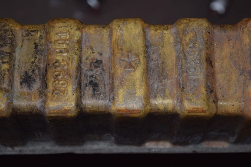

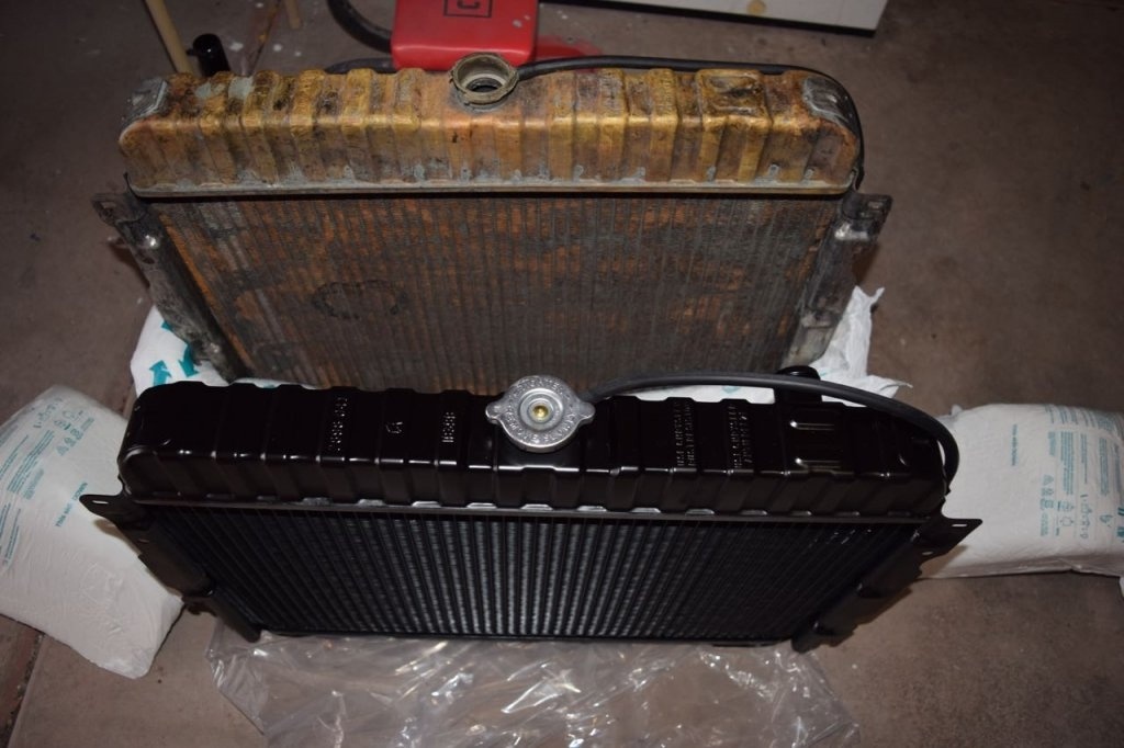

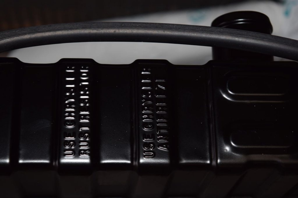

Wow, Bob sent it Monday afternoon from Wisconsin and it arrived today! It is a perfect replica with all factory lettering and he date coded it for me like the original. Not sure there is any reason to send him the original someday..... Glen-ray is the place to go for radiators and heater cores.
It was a perfect evening till I tried to install it (after repairing a crack in the shroud). It is clear why the side bracket was broken free on the original. The cross frame under the radiator is twisted a bit so the radiator hit it and you have to press down on it to get the bolts in. Too much tension on the brackets. I tried to bend it with a block of wood and hammer. Barely moved it and it was getting dark. Need to rethink it when there is more light.
I used connector grease as there is a lot of mechanical movement in this switch.

I ended up back in the garage did a bit of sheet metal tweaking and the radiator and shroud are installed....
I don't even think I would install that radiator, just put it in a glass case and look at it. Beautiful!!!!!
Mmmmm small glass case with a radiator inside the big glass case with the Coronet..... Starting to sound like art....
