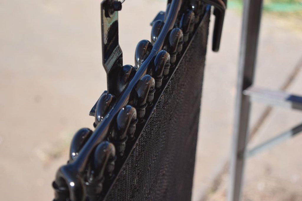

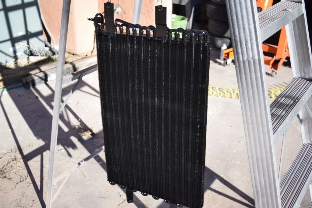

I am so close to starting it but I want to finish up a few details first..... Painted the condenser with SPI black epoxy primer for a tough finish.

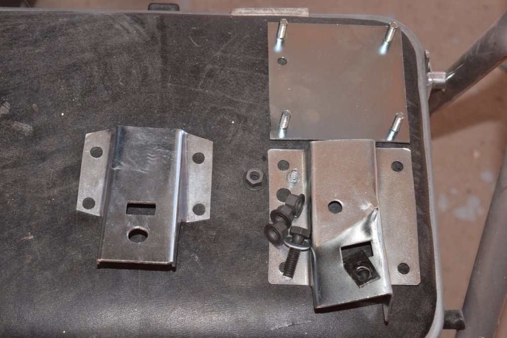

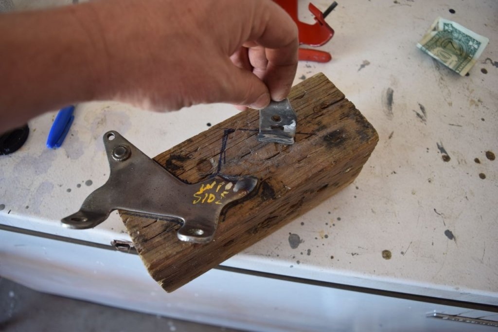

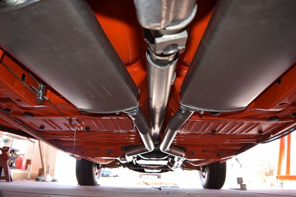

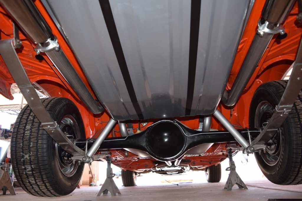

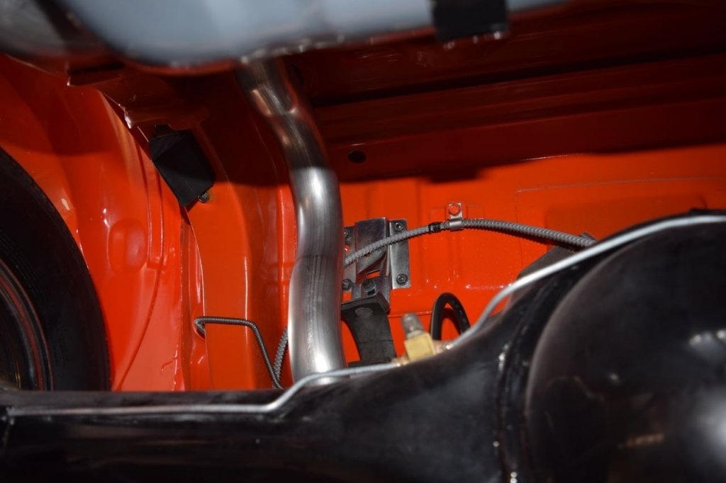

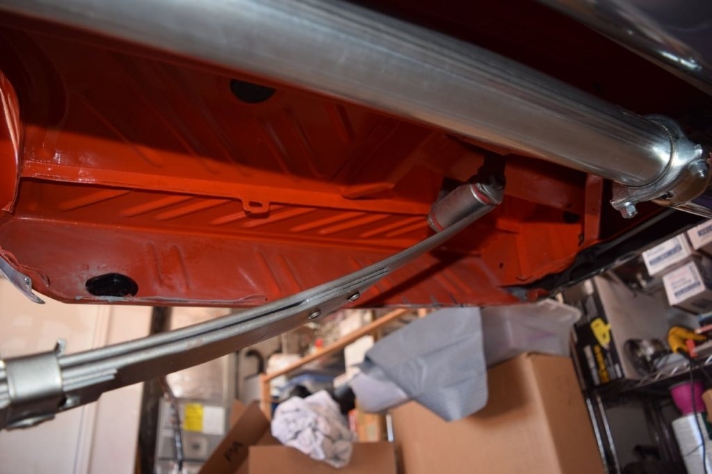

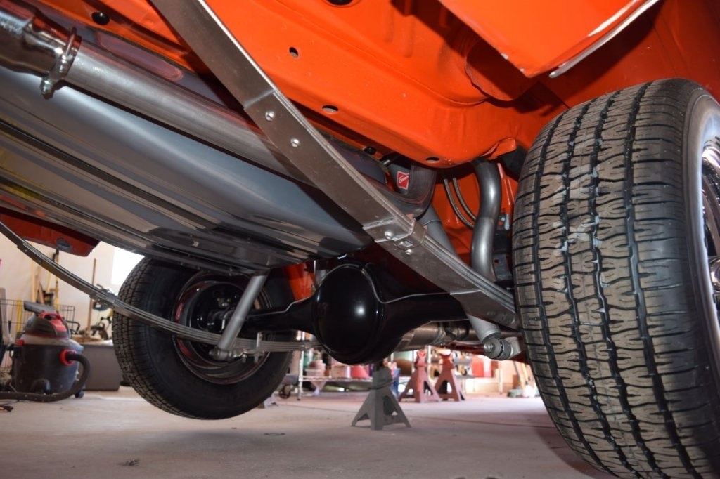

Next moved to the backend. I have been dreading drilling holes in the virgin body but I finally did it. I did not like the Accurate Exhaust universal bracket for the dual exhaust so I bought a reproduction OEM bracket. Here is the difference. Universal on the left and the OEM reproduction on the right. No comparison in strength.

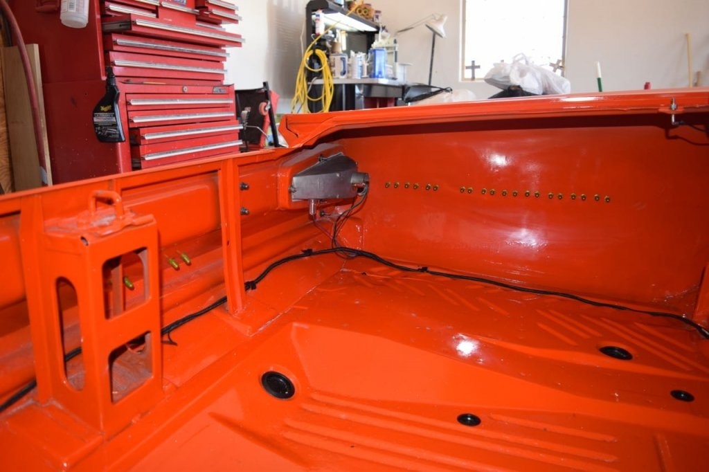

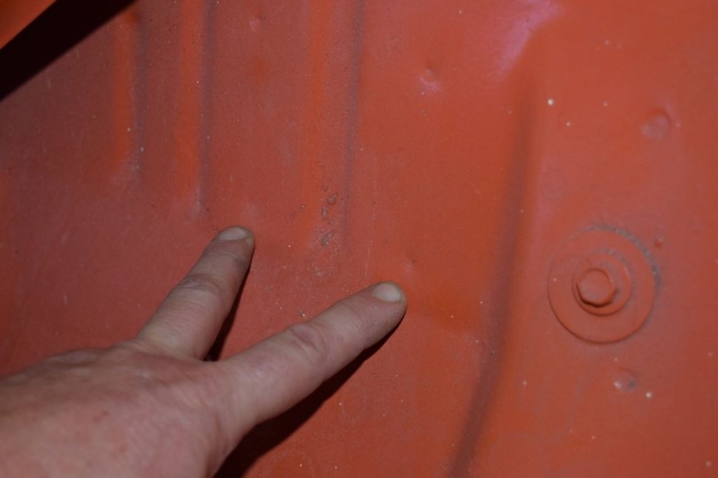

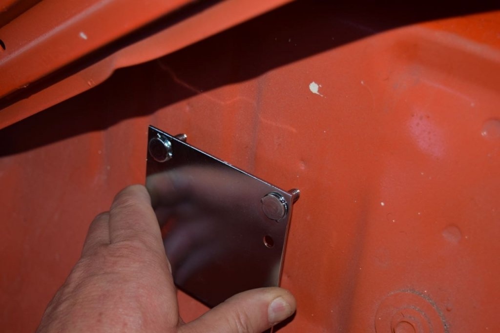

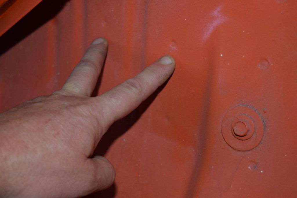

The body has the dimples for the assembly line worker to drill the holes if the car was going to be a dual exhaust.

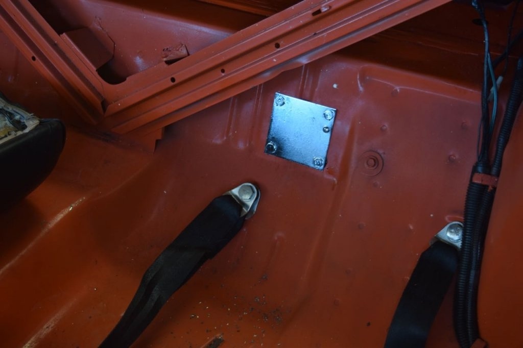

There s a screw that screws in from the inside to keep the plate from falling back inside the car.
Now that is a strong hanger! Exhaust is done dude!

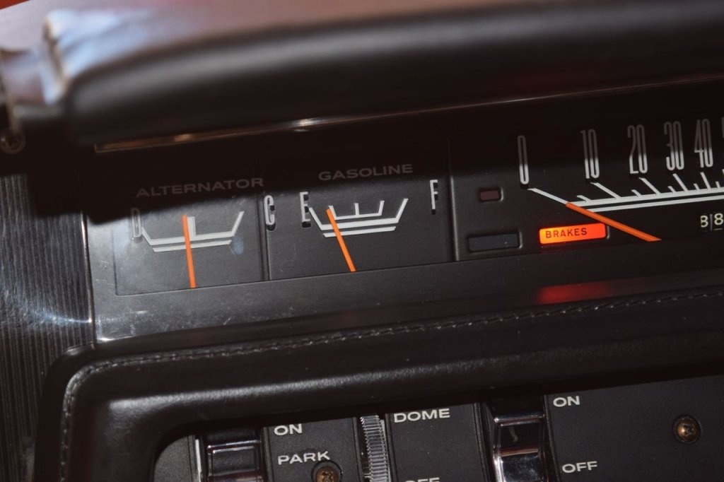

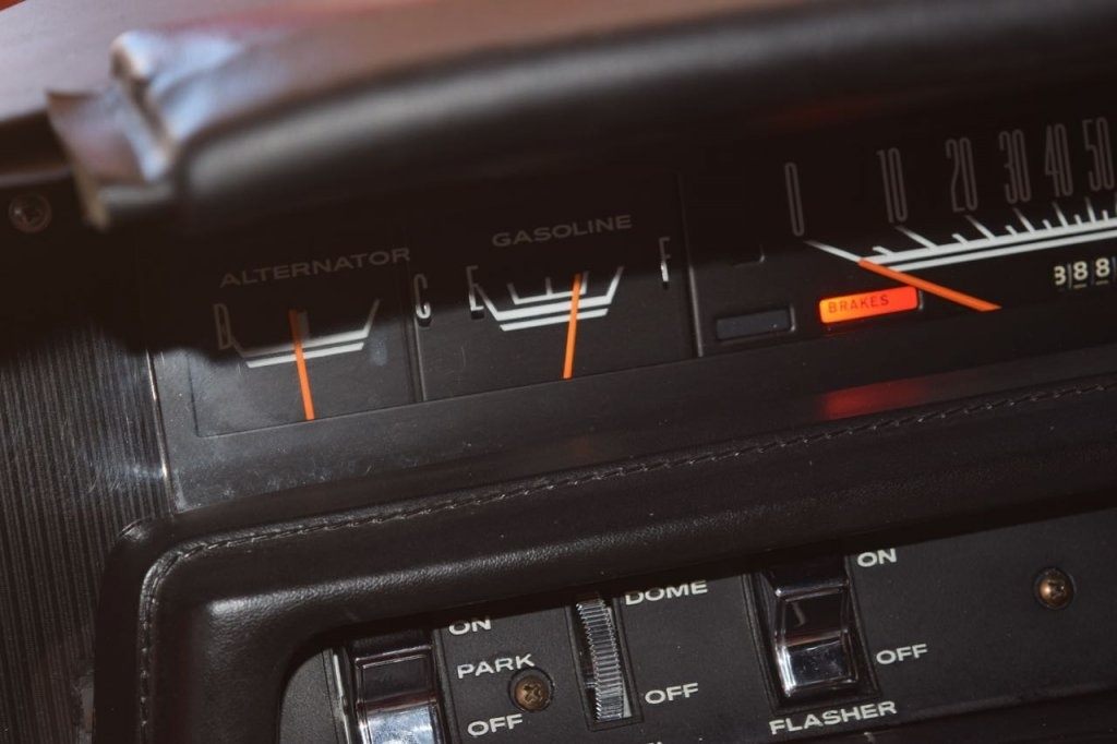

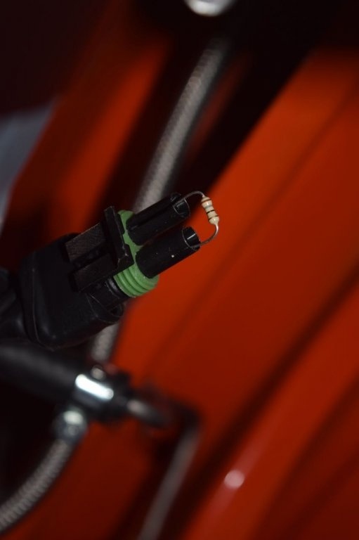

While I had the rear end up it was time to test the gas gauge. I installed a few different resistor values to verify the fuel gauge worked. A Mopar has a range of 10 ohm = full and 78 ohms = empty (or open circuit) I installed a 18 and 40 ohm resistor and it read 3/4 ish and 1/4 ish so it is functional. That is why I put the connector at the fuel gauge :)

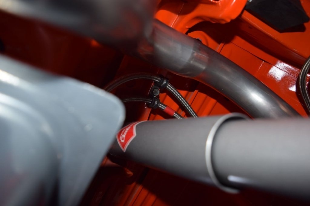

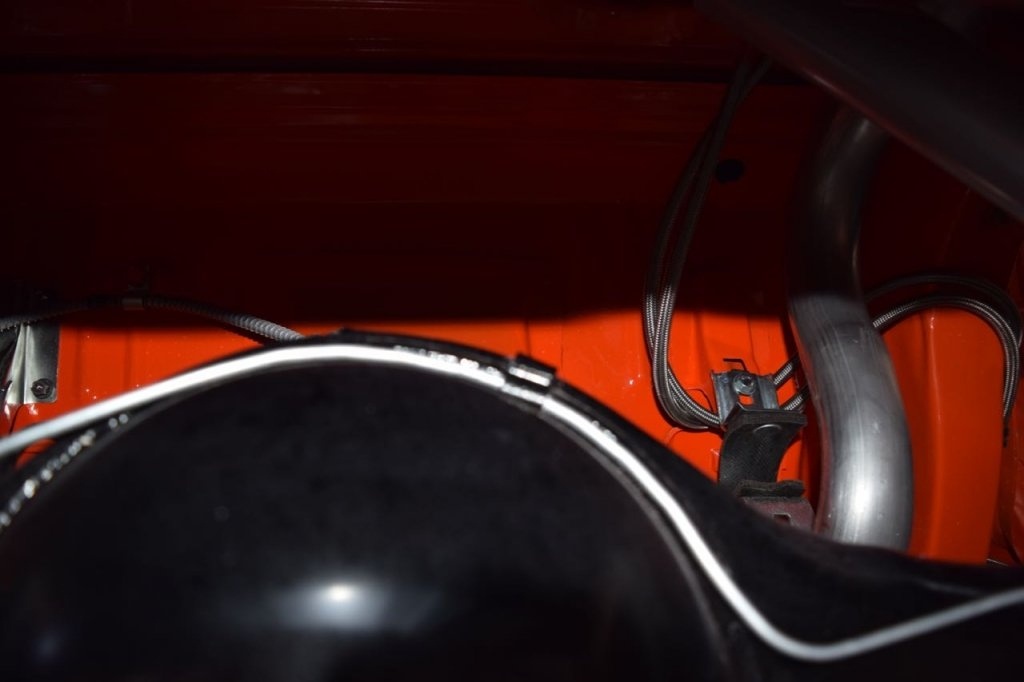

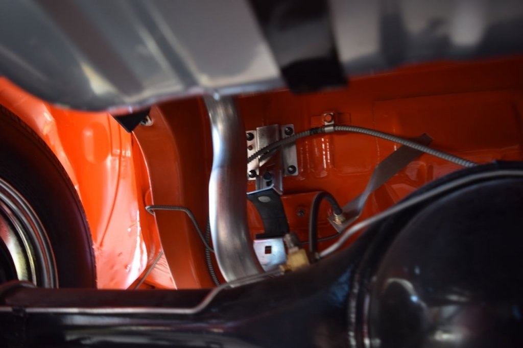

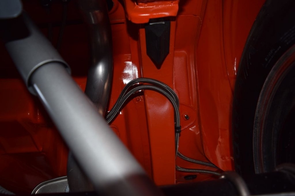

Next I finished mounting the fuel lines for EFI. I routed them around the exhaust bracket and drilled a new hole in the shock frame and used the original bolt from the steel line.

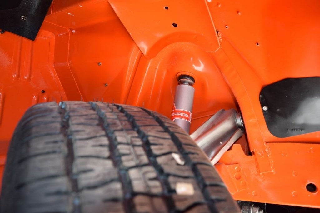

Installed the KYB Shocks.

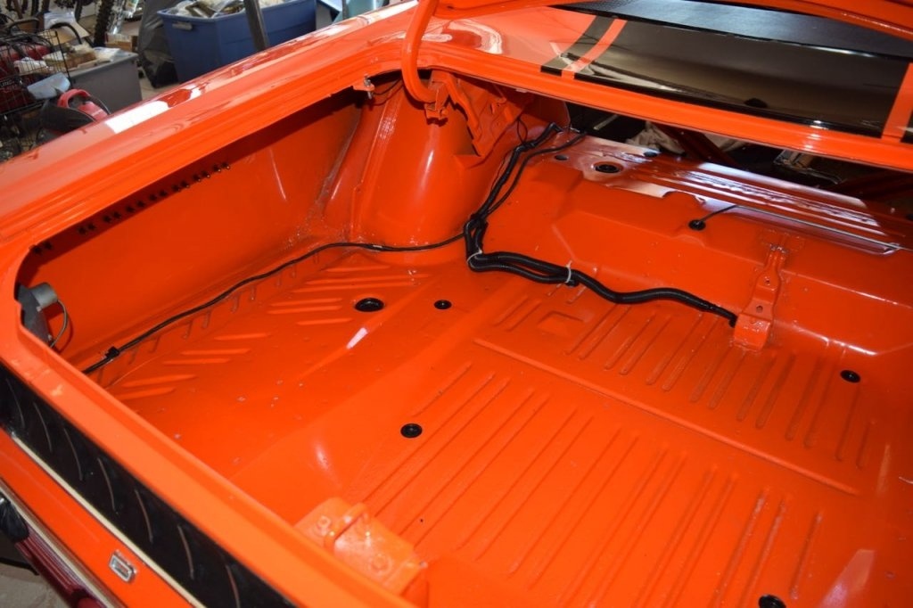

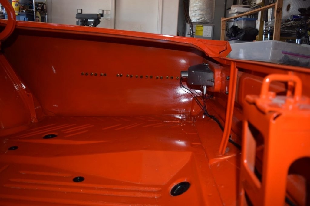

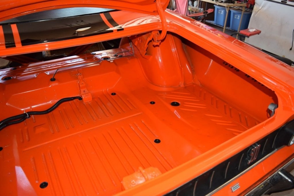

Lastly I installed all the body plugs in the rear of the car and buttoned it up for the last time (I hope)
How many Pennsylvania B-Bodies can say they have the original trunk and floor pans! Now that I understand this hobby more I can appreciate how absolutely fortunate and lucky I was to find this car in this condition....

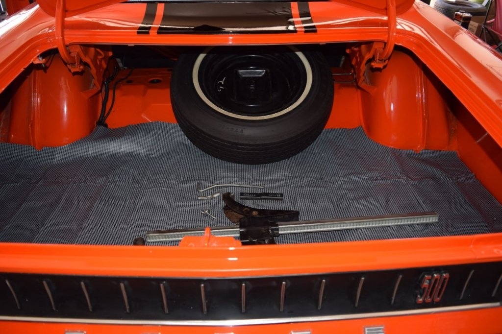

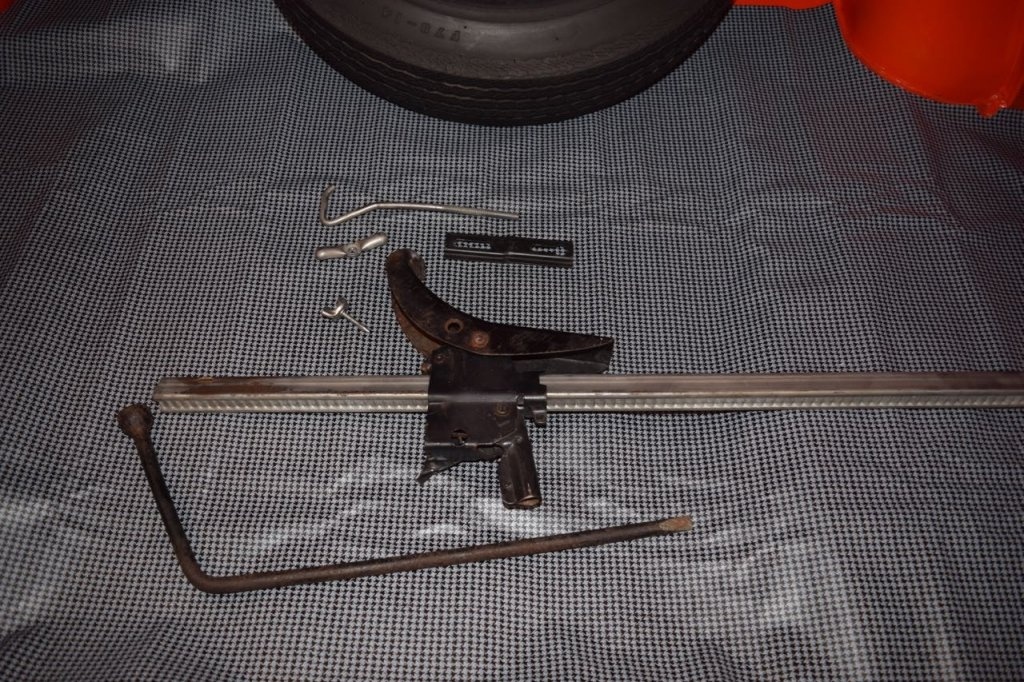

Now how the heck does this jack work.... It is very probable this is the original F78 spare tire...

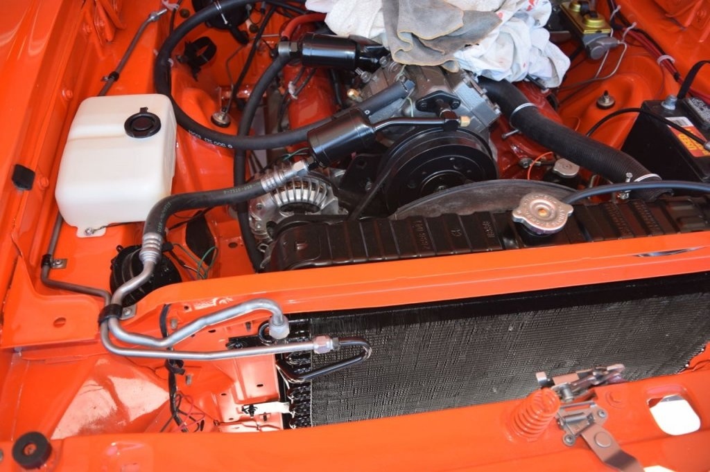

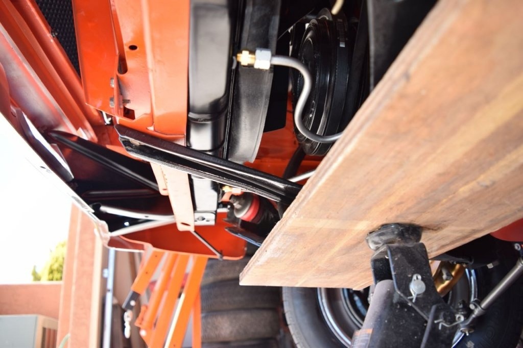

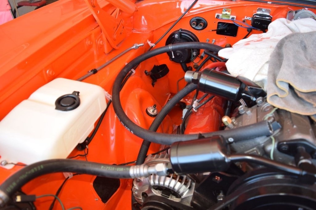

A little work on the AC lines now that I have the Condenser in.

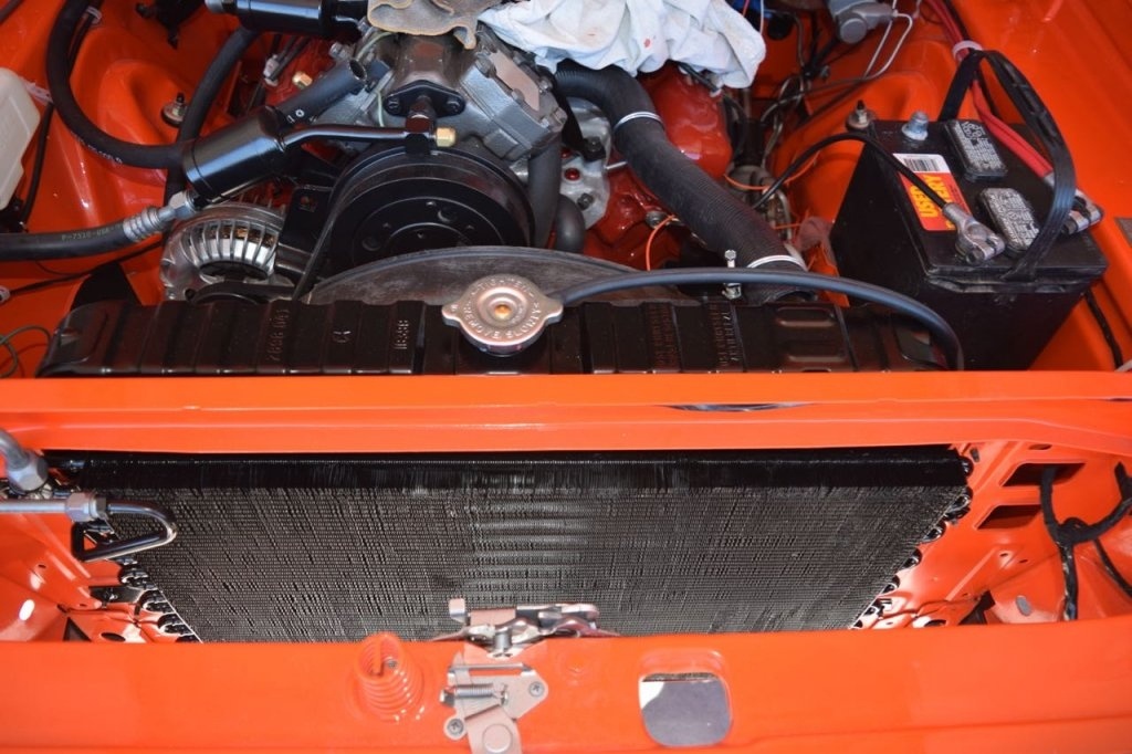

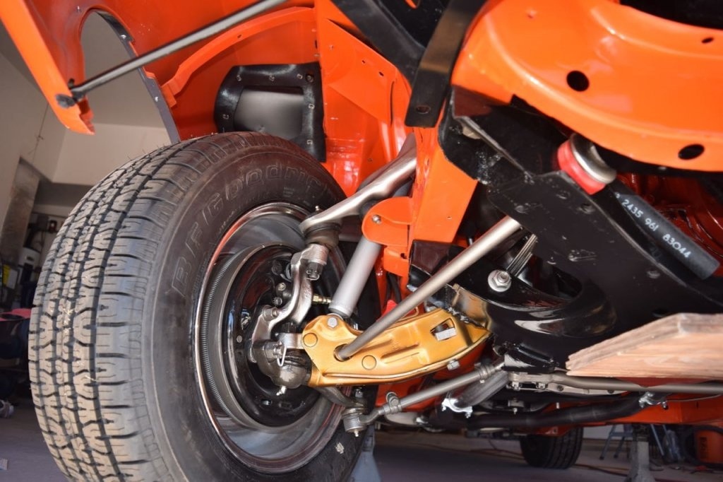

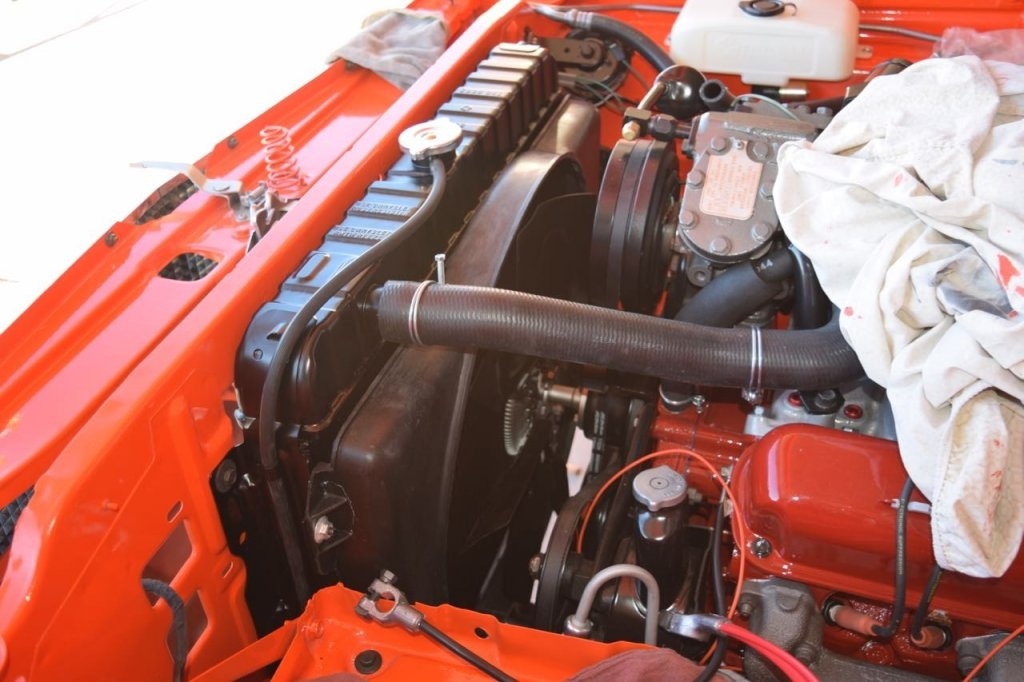

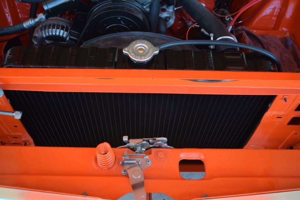

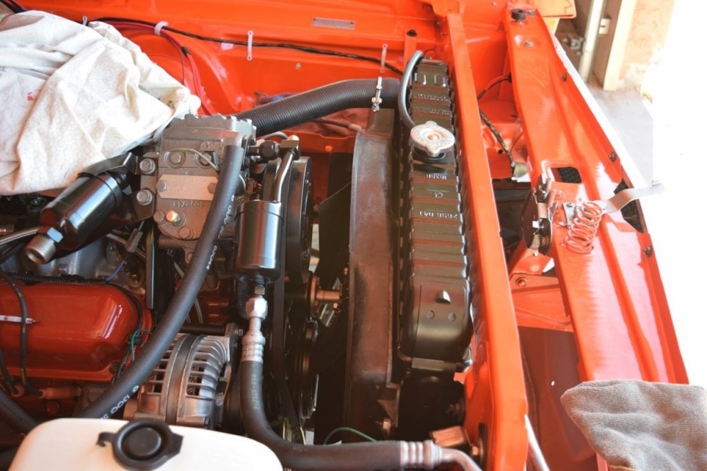

After jacking up the front of the car I finished up connecting the Glen-ray radiator and installed the KYB Shocks and did an eyeballed toe in adjustment.

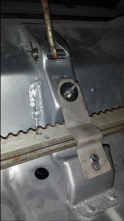

That jack hold down bracket goes down something like this. My bracket is a 1 of 1 experimental piece that I found in my scrap pile!

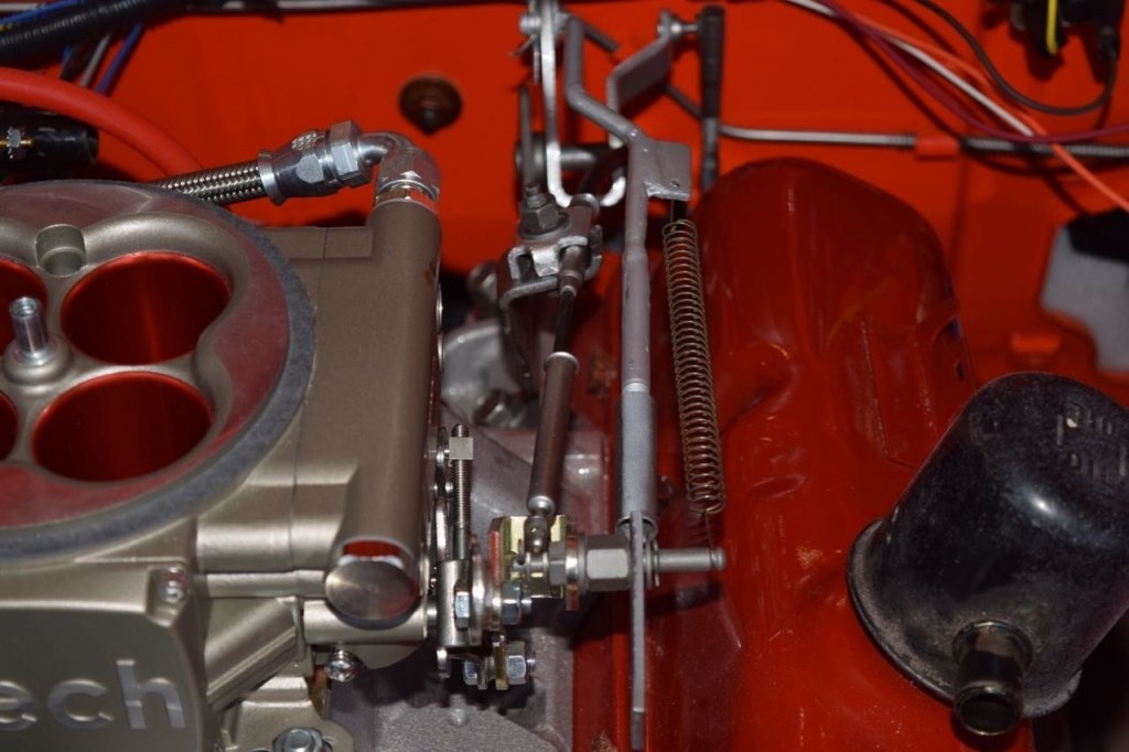

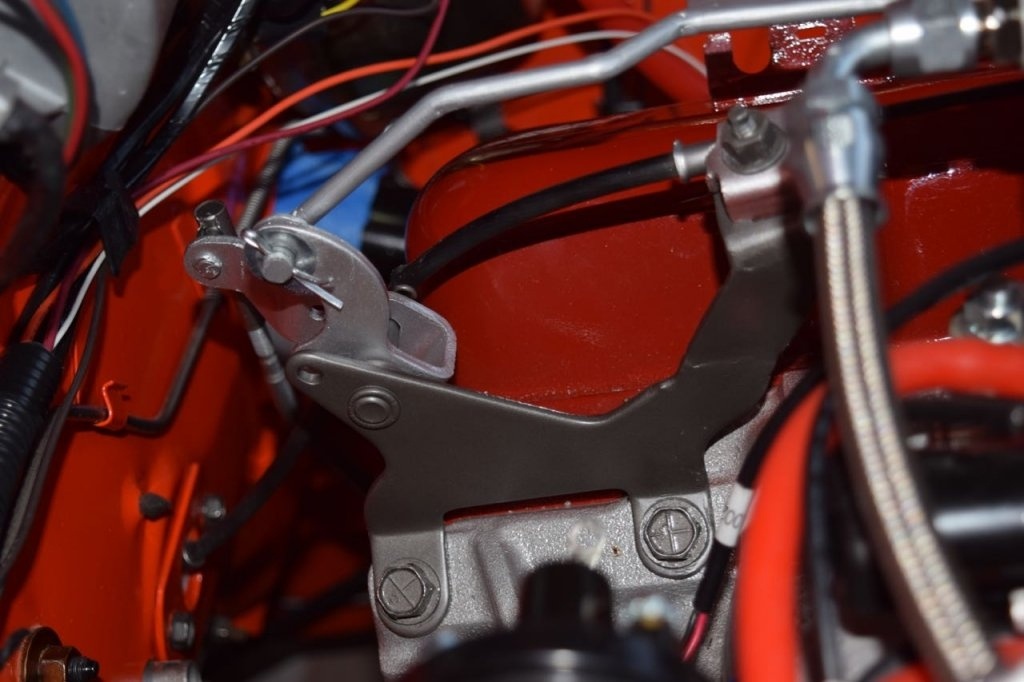

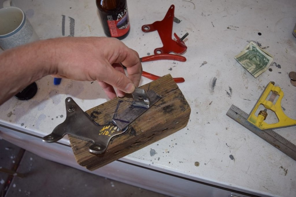

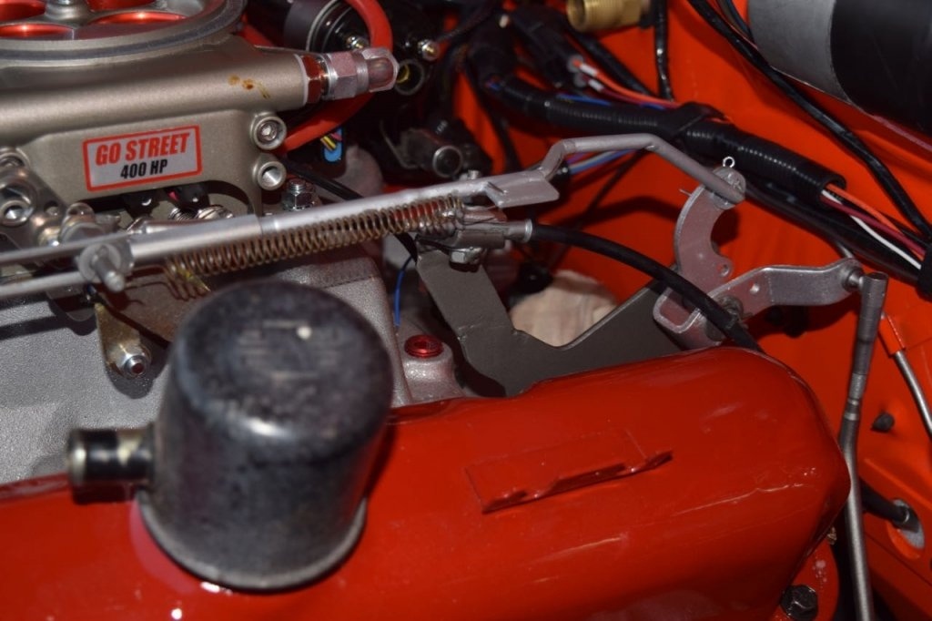

Did not do much on the Coronet today as we spent the morning in town and the youngest was sick at home but I did get the last fabrication item finished. Most of the afternoon was spent power washing the house to prepare to paint it but I got tired that that and went back to the Coronet. I bought a throttle cable bracket from a FBBO member (Wolfie's Cars) that had already had the shelf area cut and welded on reversed for some sort of 4 barrel. I mocked up the throttle and decided that the place the cable clamp needed to go was 1.5" higher and 1.5" forward. I made some templates and cut out a piece of flat stock I had and welded it up..
After welding it up I shot it with the sand blaster and painted it cast blast instead of red.
So here we go. It works quite well and will get the plates .....almost.... wide open without a problem. If you stomp it it will overcome the last few degrees and go WOT.... My daughter it pressing the peddle with her hand and she was not really getting into it...

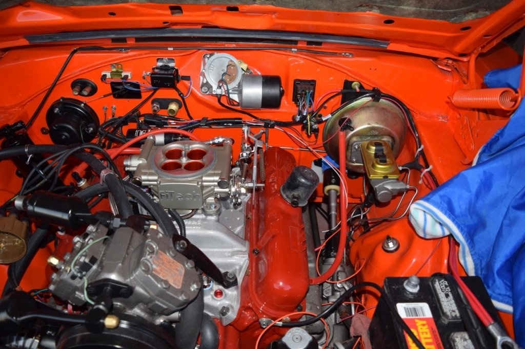

All right I'm feeling crazy today! If I get more than 5 agrees by noon I'm going to try to start this thing today so it's going to be up to you guys whether I start it or not
Bring that mopar to life...looking real nice
If you have checked everything at least twice you need to fire it up! I do not want you to rush in if you have not.
Check your transmission lines too!
