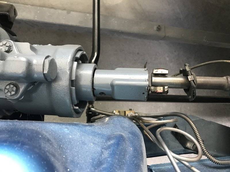

Okay, I'm stumped on this one.
Of course, I neglected to take pictures way back when I took it apart.

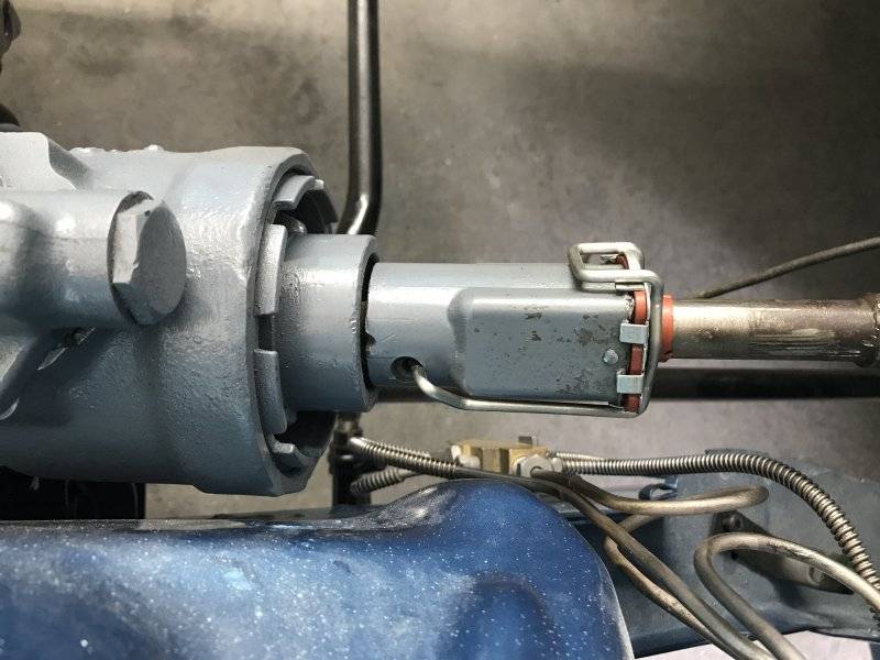

This picture shows that I am about 2" short of where I need to be. The steering column is adjusted all the way out, any farther and the bracket slides
off the retainers.
They should or will go in either way. But the wrong way and it has all kinds of slop in the steering because the shoes are too narrow and move around in the coupler body.
Saved the pic and ordered the kit.
The seal was pretty much shot anyway and now I will know for certain it is done right.

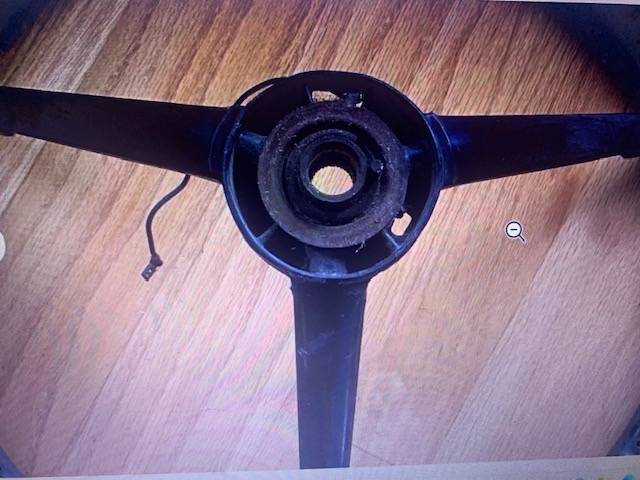

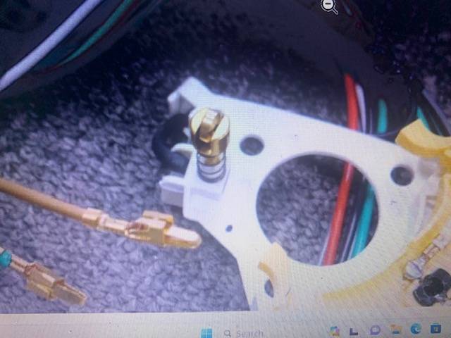

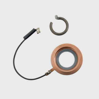

Do you happen to have a diagram/source for the horn button contact. The brass looking circle that has some kind of backing on it?
The backing material is all cracked and fallen off of mine and I cannot remember how it when in there.
Does this show what you need?
Pulled it back apart. They were in the wrong way and there was no spring to be found either.

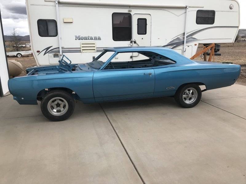

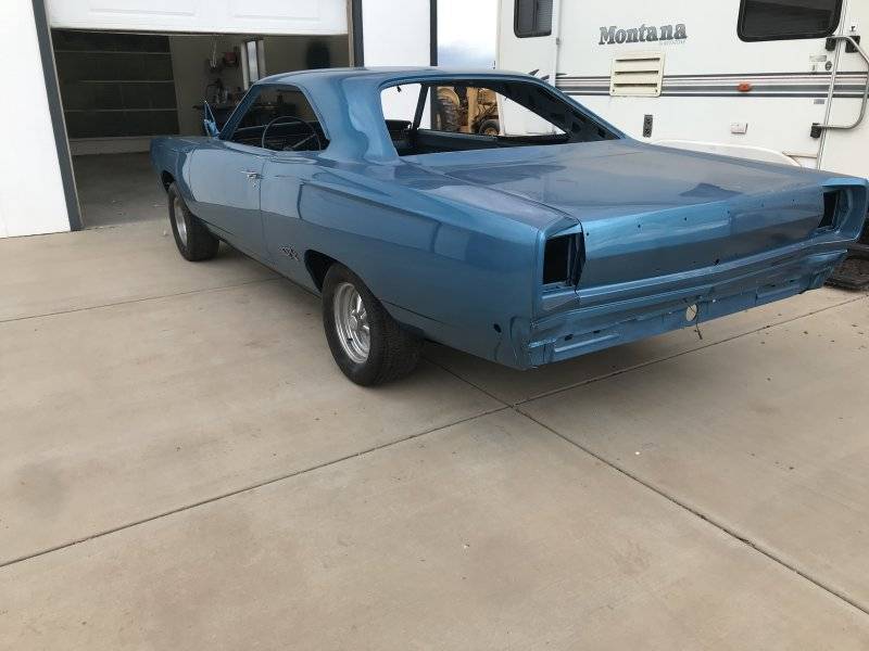

Rolled it outside today so I could rearrange the work area.
These are the wheels and tires that came with the car. I was surprised they still hold air.

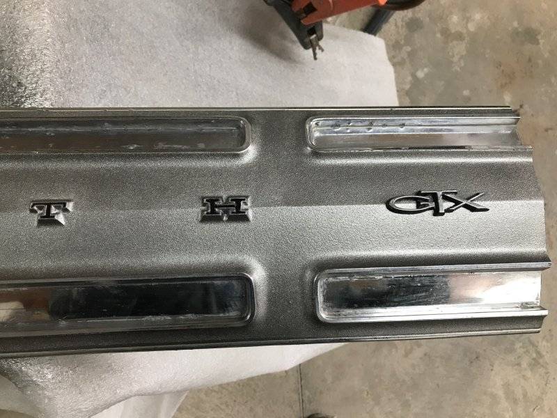

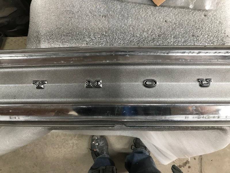

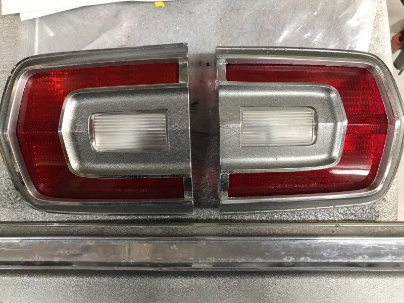

Dark Argent Silver paint came today so I got the tail panel sprayed. Also installed the GTX emblem from the original panel.

Did you scuff and prime the chrome? The color looks good…
The previous argent paint was well adhered so it only took some sanding in places to get rid of nicks and scratches.
The dark silver paint actually fills pretty decent and dries quite quickly. Everything you would expect for nearly $40 a can with shipping. :rolleyes:

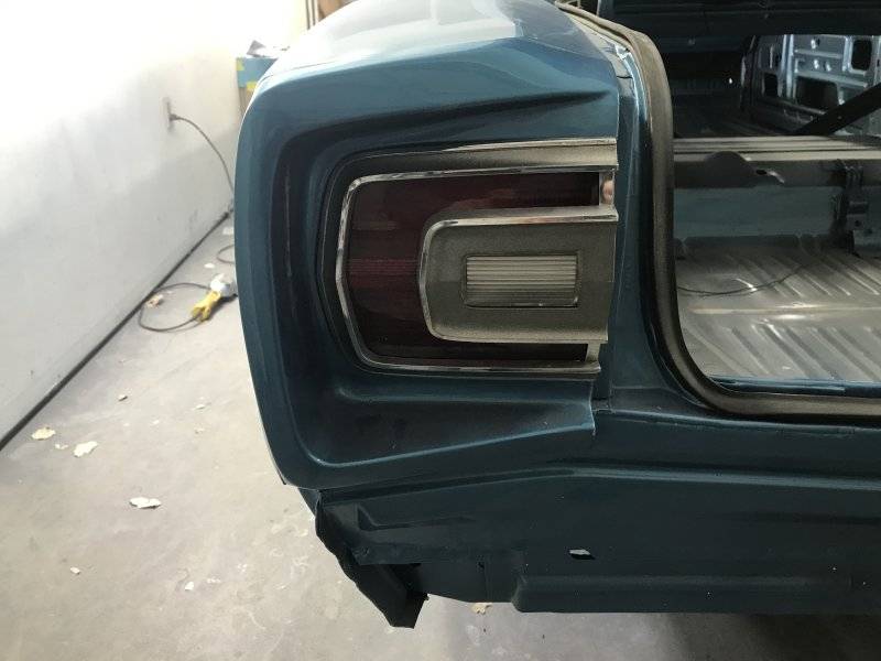

Still waiting for stripe kit to get here but started installing tail lights.
