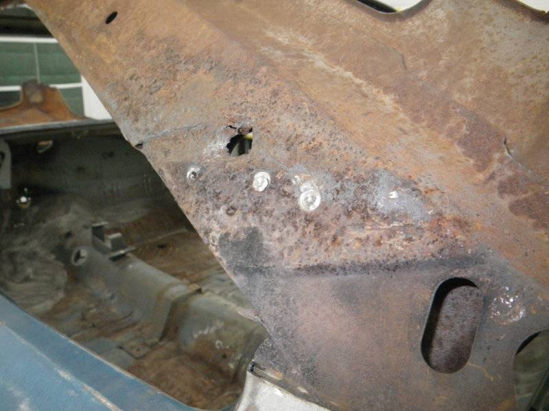

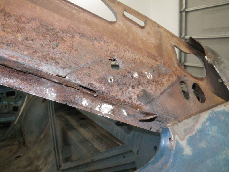

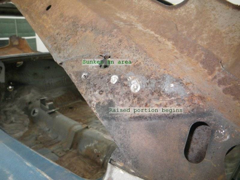

I have a question on the shape of the metal in this heavily rusted area of the roof structure.
In this first picture you can see where the raised portion begins but then it appears as though there is an indented area where the rust hole is.
Another view:
The other side is completely destroyed so offers no help:
My thinking is that the indented area was caused by the rust or previous damage. Does anyone have pictures of this area or know for sure what the shape is?
not currently, but one of my next moves is to peel the q-panels off and expose that same area. I will watch here until then and share the same when I get there.
I could only find one photo of the area online and it seems there is only the one indent below the quarter panel seam.

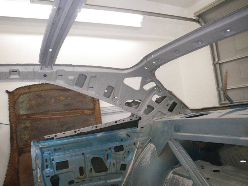

Media blasting the shell now, started with the roof support structure. Most of it seems to be in good shape with only three areas that need patches. The two shown earlier and one section over the passengers door.

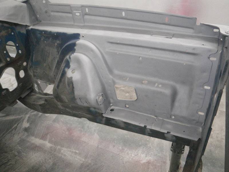

Decided to media blast everything first and then do the patches.

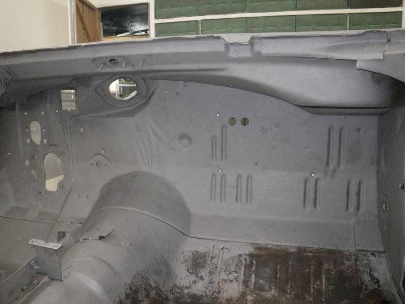

Working on the inside of the firewall:

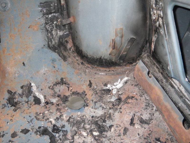

Had to stop and remove the seam sealer and left over adhesive with a torch and chisel so while I was at it I did the entire car:

Firewall looks to be very solid:

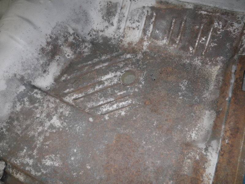

The passenger's front floor pan was extremely rusty so I blasted a small portion to see how bad it was. As the rust flakes disappeared little holes began showing up. Hard to see in the photo but there are quite a few of them.

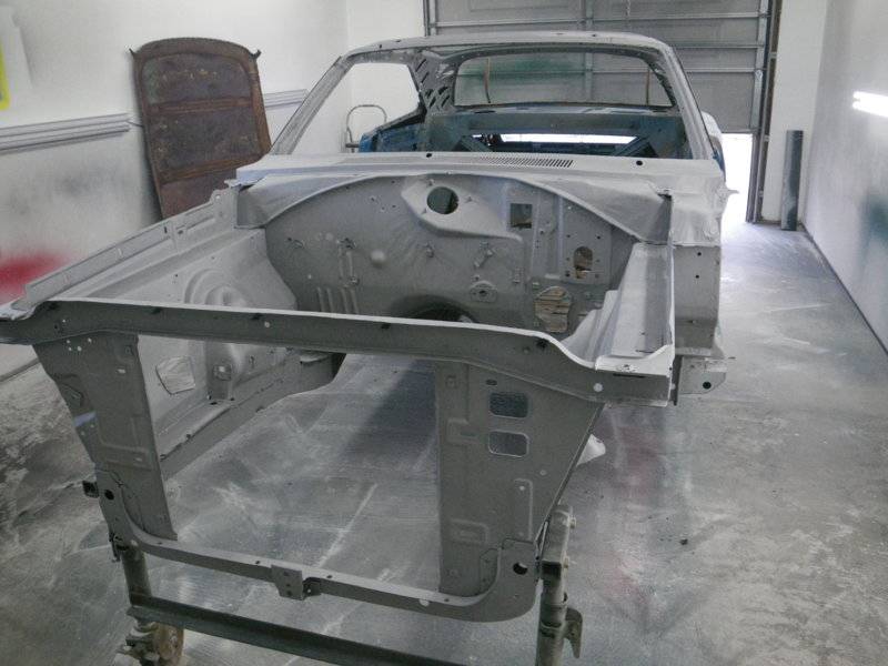

Okay, had to take a break and work on my old Ford Tractor's hydraulic system. Here's where I am at now.

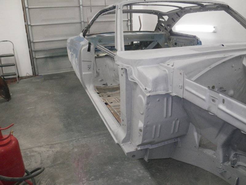

Finished media blasting the exterior of the car.

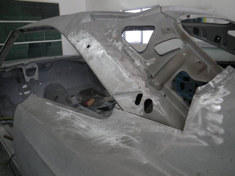

The right quarter has had some work done to it in the past. Not sure if you can see it in the pictures but there is rust under the filler. This is a very familiar sight when restoring these older muscle cars and one of the reasons I advocate for applying epoxy primer before the filler work.
Left quarter looks much better although the metal is split at the top of the door opening.
The rear panel seems to be in very good shap:

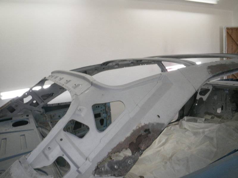

Started cutting out rust and forming patches today but had to quit due to prior commitments.
It looked like this when I got it:
This is what was there when I removed the roof skin:
Here I am today with it media blasted and the rusted portion cut out. Fabricated a patch and tack welded it into place.
I wonder if there were mouse nests in those c-pillar areas that are rusted at one time? Kind of an odd spot for rust, at least I have never had one that was bad there.
I know what you are saying about the odd places I am finding rusted metal. When I pulled the roof skin there was nothing indicating a nest of any kind.
With a car this old, it is hard to know anything about it's history.
It has been a while since I welded patches in and I'm a bit disappointed in myself.
I brushed on some epoxy to protect the metal that will be impossible to reach after quarter patch is installed.
Fabricated and welded in the quarter panel area patch.
I keep telling myself I will get better on the next patch. LOL
Still much better than what I started with.
