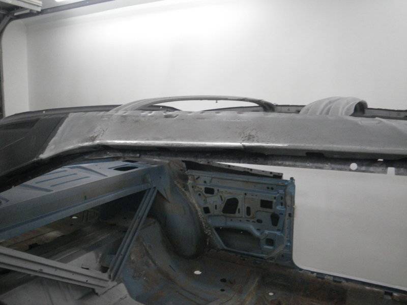

Here's the new patch for over the passenger door next to the old metal I cut out.
Back side:
Forgot to take pictures of the cut out area and backside of new patch after applying epoxy primer but here it is installed:
I have the right upper quarter panel patch ready just need to weld it in place.

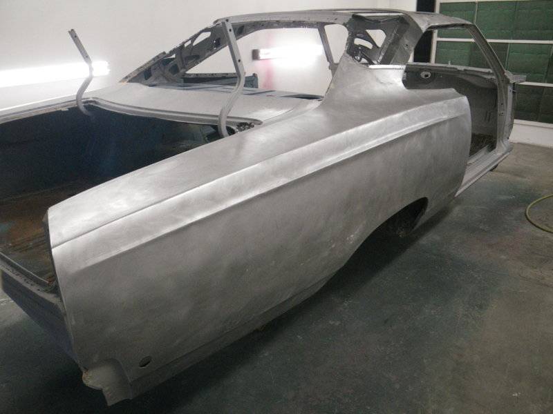

Started running over the metal with 80 grit on the DA to gets some scratch for the epoxy primer.
Running a DA with 80 grit over the blasted metal not only provides good scratch for the epoxy primer but also can reveal some problems you can address along the way.

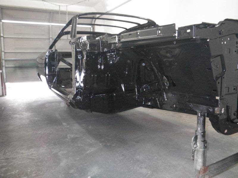

Inside firewall:

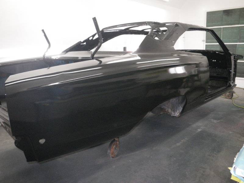

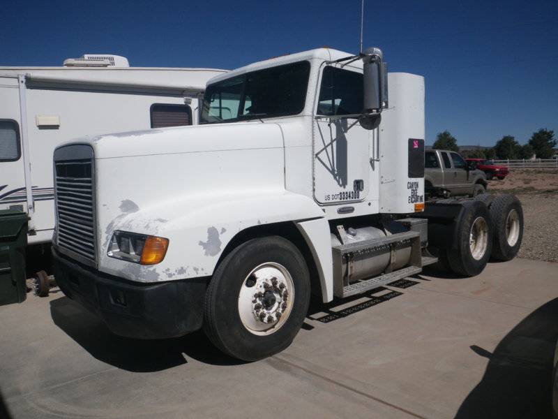

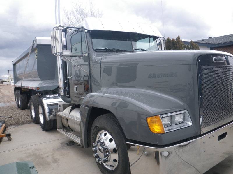

I was working on a 2000 Dodge Dakota for a guy and he brought me this to work on instead:
He wanted the wings off the interior stripped and cleaned, the truck painted Dodge Destroyer Grey, a new stereo system, new grill, new front bumper, new headlight assemblies, etc. etc.

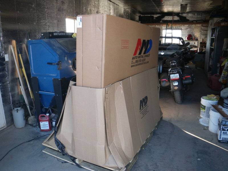

Pulled the plug and ordered the new drip rails, roof skin, floor pan and trunk floor today. All AMD parts.
I have a Dodge Dakota to finish for the guy who owns the big truck and then I can get back on my project.
Cool,nothing like a sheetmetal delivery to lift one's spirits! Let me know how the driprails fit. Someone removed them from my Daytona stock car,and I am going to put AMD driprails back on it. Daytona's don't look right without the A pillar moldings.
