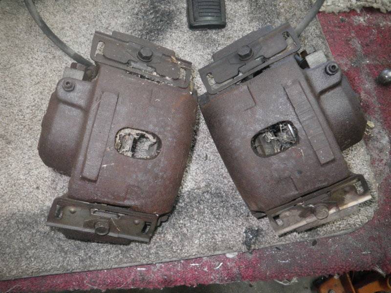

Decided to disassemble the disc brake calipers:
The parts number match up to a 1975 Dodge Dart and similar. New pistons and seals are available.

I soaked them in de-greaser and cleaned them up. The bores will clean up with a hone. Pistons, banjo bolts and air bleed screws will be reinstalled while media blasting the housings and coating with epoxy.

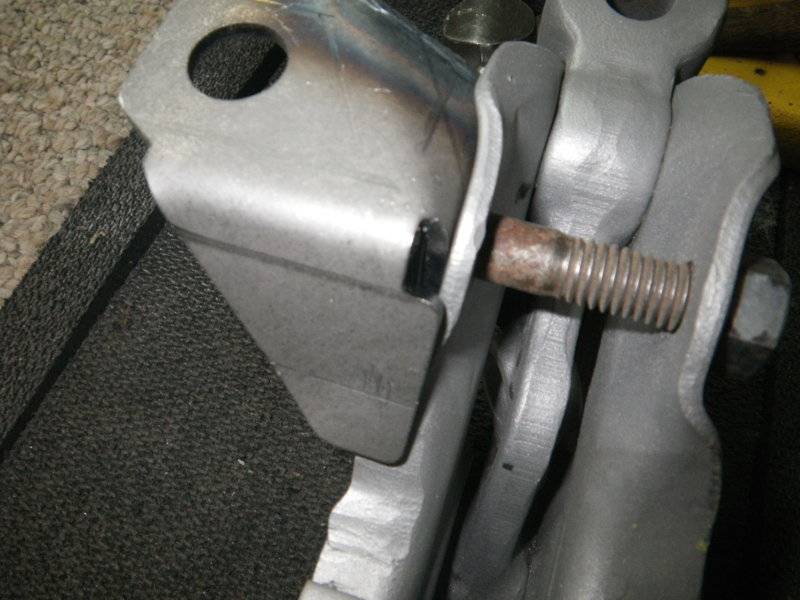

Got the Sway Bar mount brackets from Hotchkiss and checked the fit.
The bolt hole and upper flange fit really nice:
The lower flange has a 1/8" gap and it is the same on both control arms:

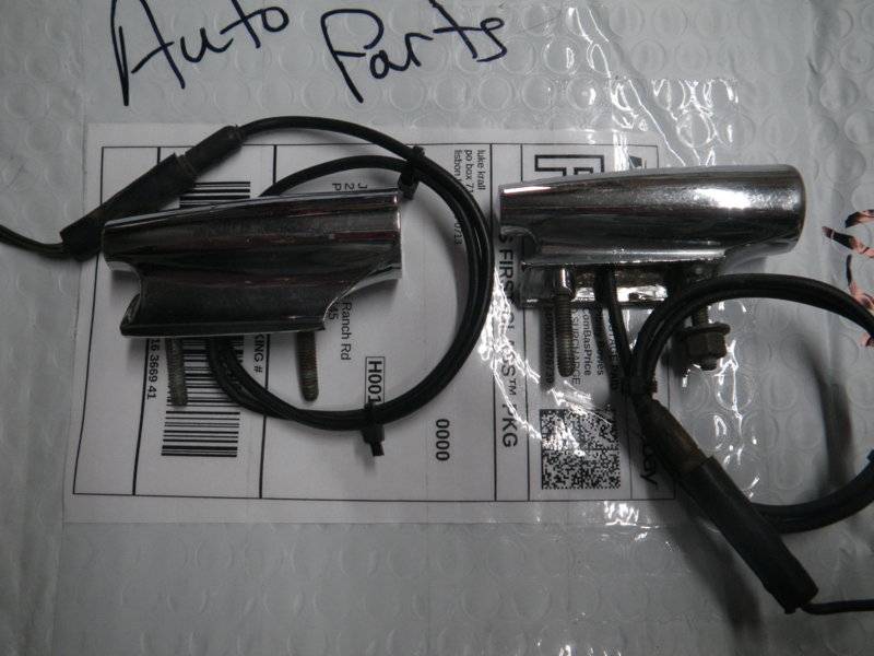

Scored a pair of fender mounted turn signals and a padded ashtray front on eBay recently:

I forgot to mention that I got the turn signals and ashtray for less than 1/3 of the price most were listing them for. :)

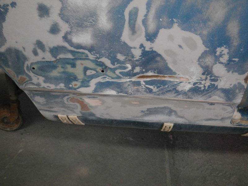

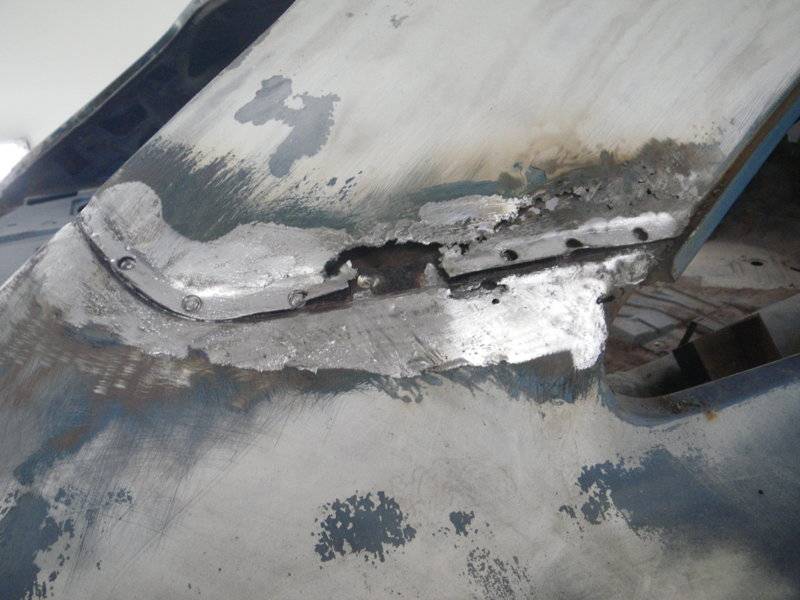

Right quarter panel had some work done.
Here is a common problem I find when restoring cars. Rusted metal under the filler. This is one of the reasons that I apply epoxy primer to bare metal before doing filler work.
I admit sometimes I still slip back to filler on metal and there is nothing seriously wrong with that method however the epoxy will protect the metal and the filler adheres well to the epoxy.

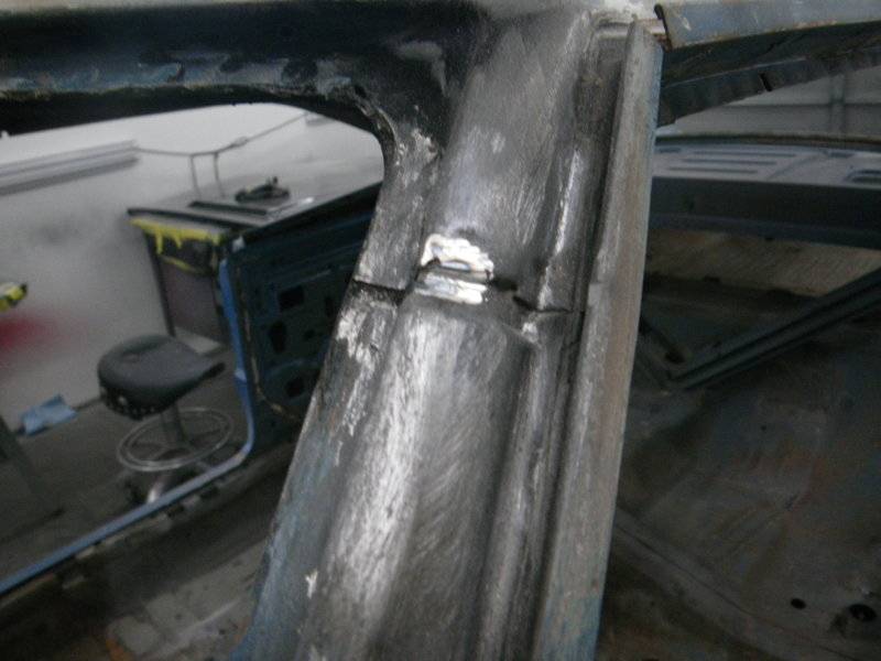

The windshield flange went very smoothly using a 5/16" spot well drill.
The Flange areas are easy to separate after drilling by simply inserting a flat blade screw driver or using a steel chisel.

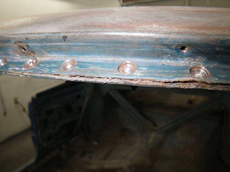

The problem areas are the drip rails. There is no room to get a screwdriver or chisel in there to separate the skin from the drip rail.
In this picture I used a 5/16" spot well cutter but found that it left some small portions of welded metal around the perimeter of the holes. Not much but enough to require leverage to break the roof skin free.
Ended up destroying the drip rail in the process of trying to loosen the roof skin. In this case it wasn't a bad thing since it was more rusted than I previously thought.
I am trying a 3/8" spot weld cutter on the other side and will post some pictures when the skin is removed.

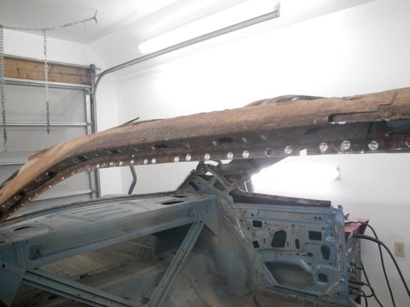

Got the roof skin off today and it is rusted pretty badly especially along the flange area where its very thin.
The support structure has a couple of heavy rust areas that will need to be cut out and patched.
The majority of the structure is sound and will clean up nice. You see the rust behind the drip rail here:
Looks like a new roof skin and drip rails are in the future. For now media blasting, patching and epoxy.
