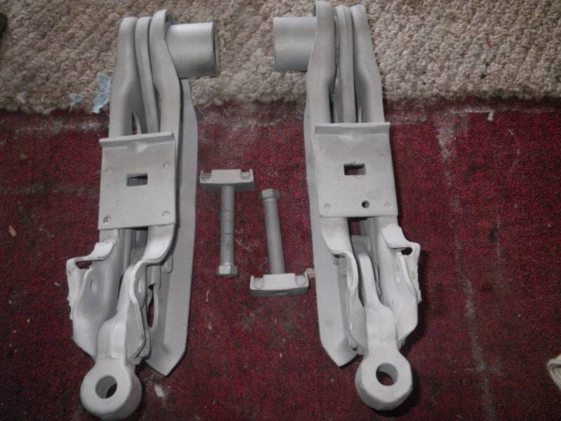

Before you get to carried away consider what stance/tires/driving your going to do. You might consider aftermarket arms. At the min. you might consider the offset moog bushings to get more adjustment for radial tires. Just throwing it out there so you don't waste time or money on something you might change later.
Are you talking about the upper control arms or both?
More blast cabinet work.

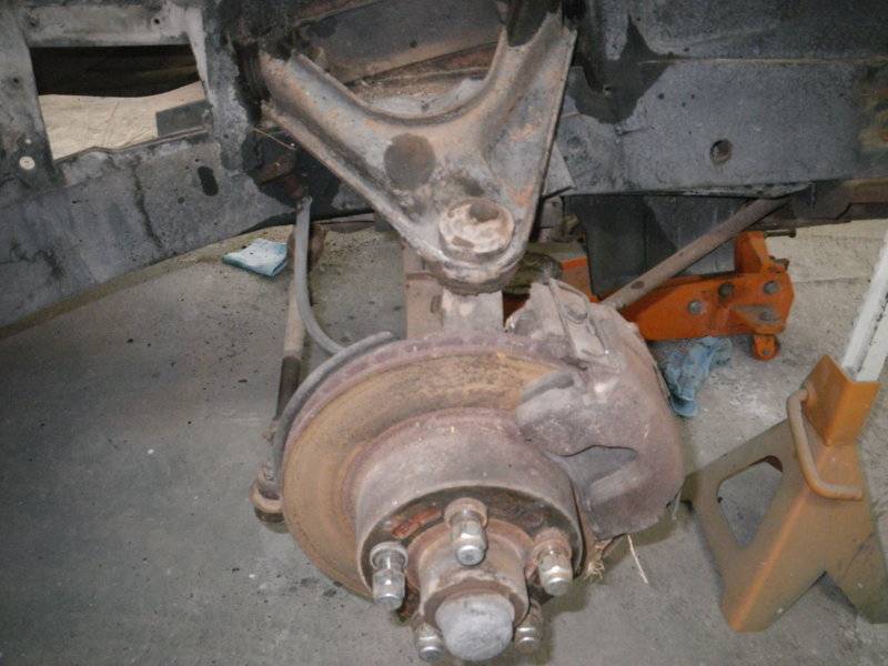

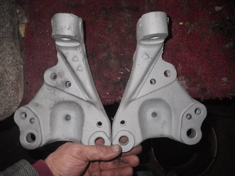

I was wondering if these knuckles are reversible? The disc brake calipers were mounted on the front and If I can switch the left to the right it will put the caliper mounts to the rear. The only markings I could find on these are the raised triangles.

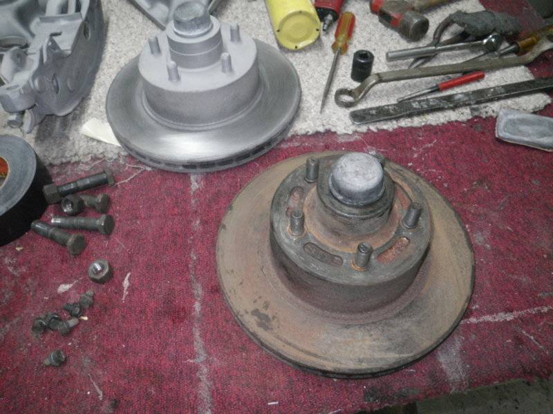

Got one rotor cleaned up.
Both. If you're doing a OEM restoration then you can probably get by with the Moog offset bushings. But it seems to vary car to car.

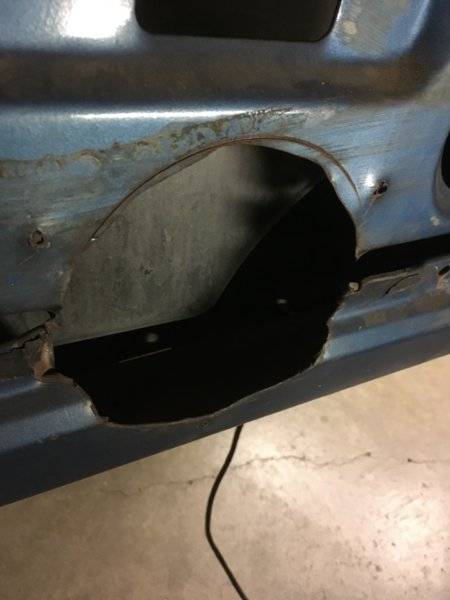

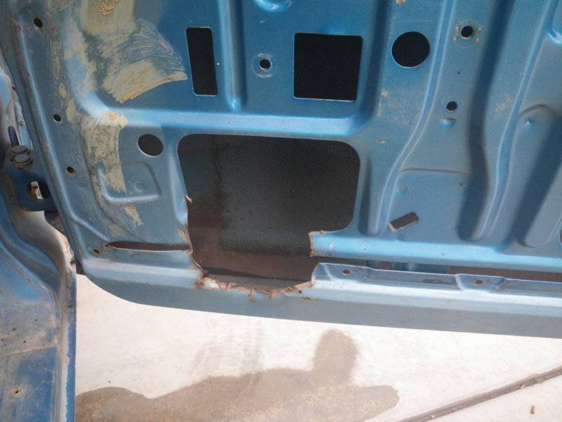

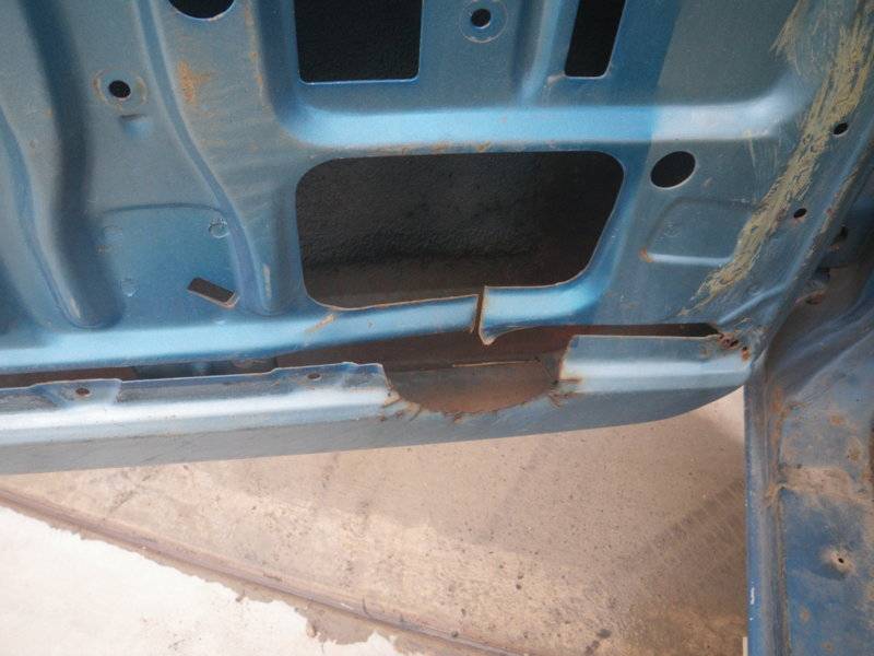

Fabricated some patches for my doors where someone hacked them up for speakers.
It's been a while since I have attempted anything like this so I started with the easy one - if there is such a thing. LOL

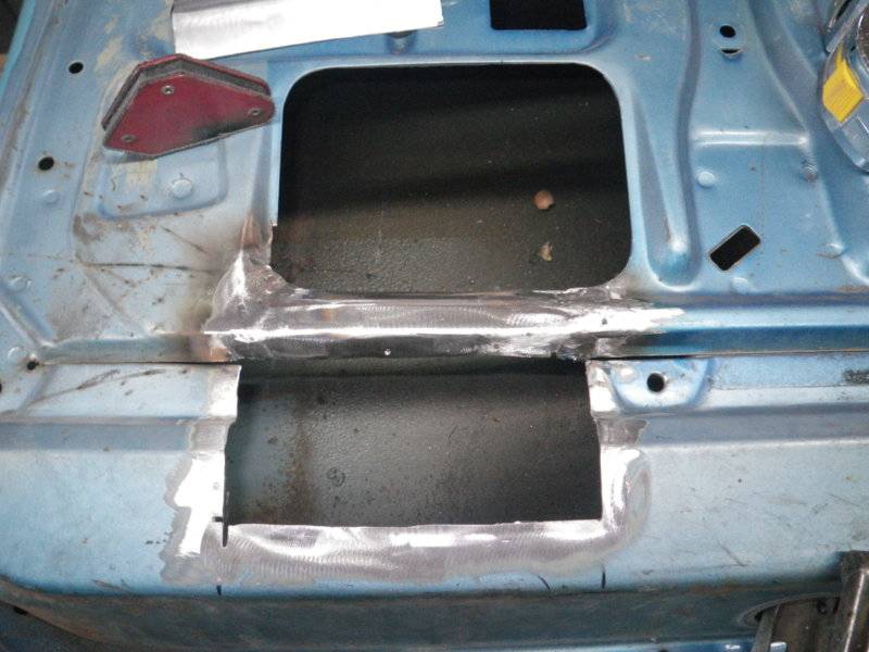

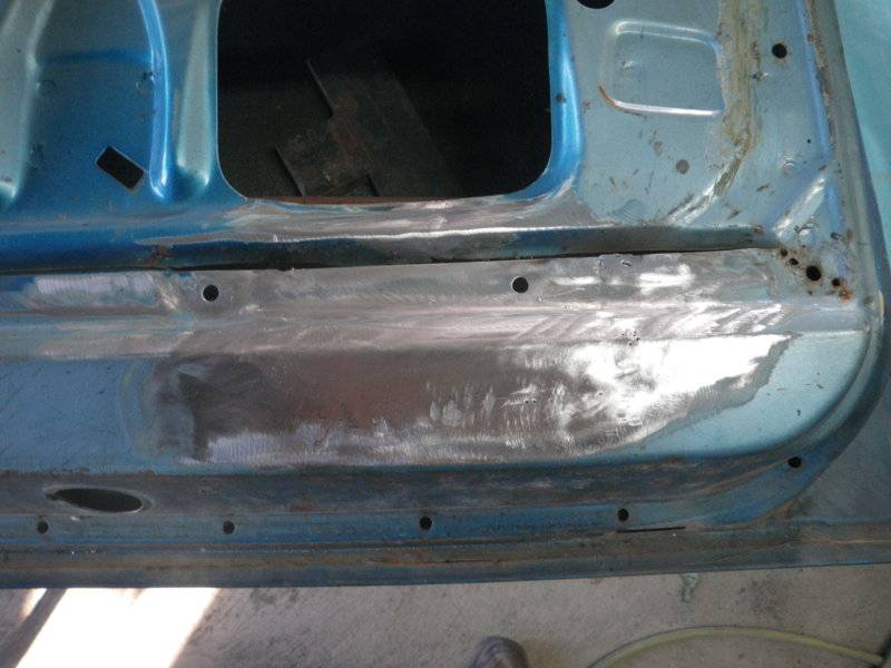

The other side was a bit more challenging.

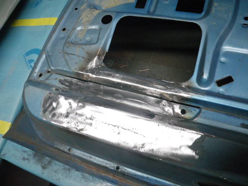

Step one:
Step two:
I still need to drill a hole in this one.
Patches aren't perfect but I hope to get better as the project progresses.

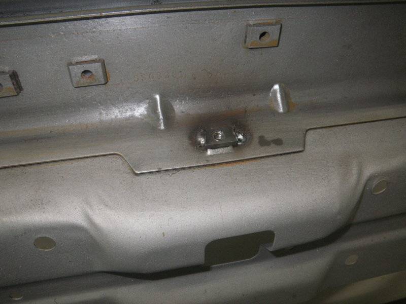

Welded the catch nut in place:

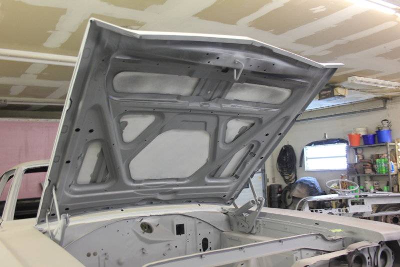

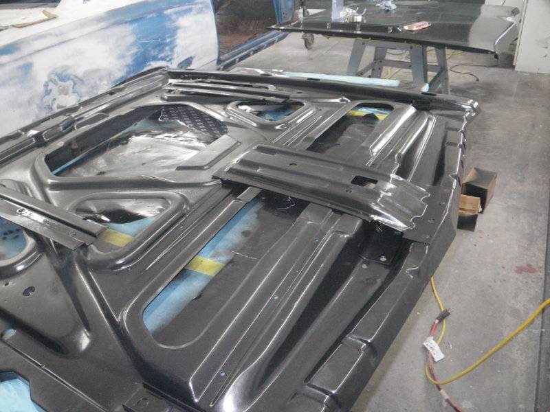

Cleaned everything with Wax and Grease Remover, let flash for 30 minutes and blew off with air to remove any left over dust. Shot one coat of epoxy on the inside of the hood and top side of the hood support structure.

Turned out great....I’m going to be dealing with the same issue. Did u use a piece from a donor door, or fab the patch yourself....Jim
I fabricated the pieces from some sheet metal. Same thickness. Used a cheap metal brake, bench vise and some steel pieces to help form the curves and angles.
You do nice work. Thanks for the info....

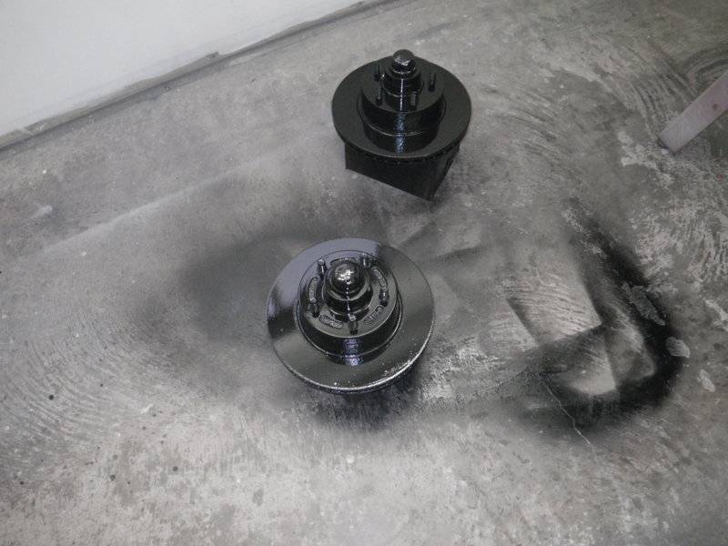

Rotors:

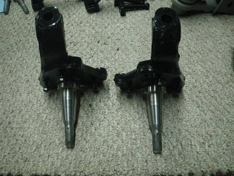

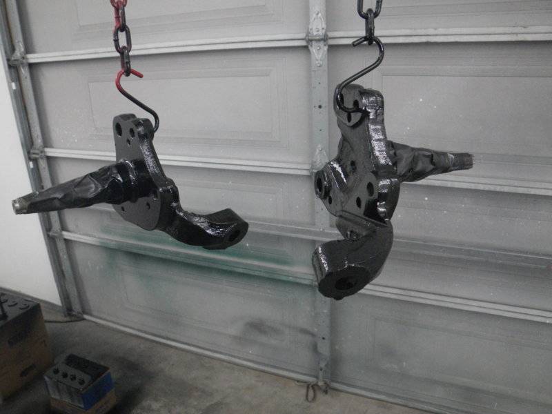

Steering Knuckles

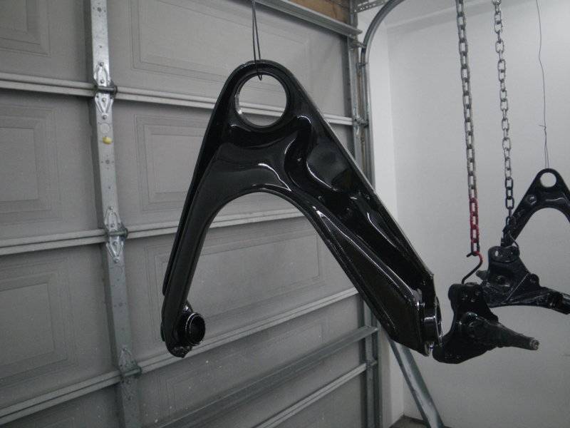

Upper Control Arms:

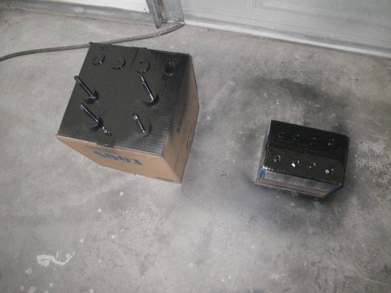

Upper Control Arm bolts, nuts and washers:

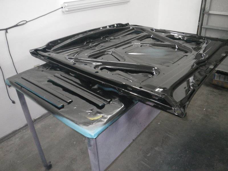

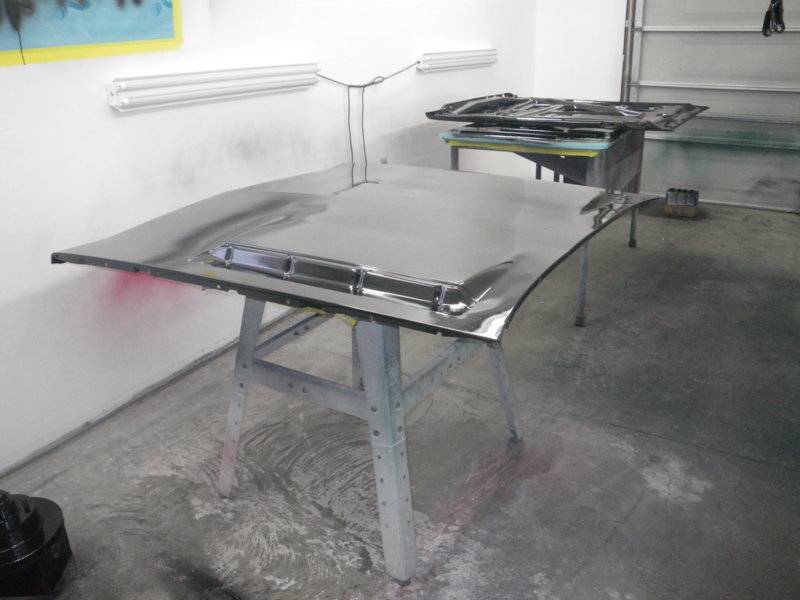

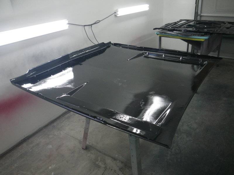

Hood:
And Hood Support Structure:

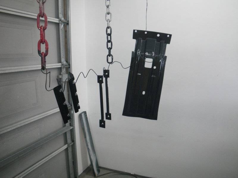

Welded inner support plates and hood hinge nut retainers back in place.

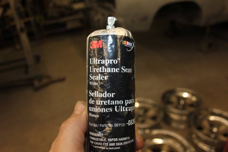

I purchased some Lord Fusor FUS-121 expandable foam to use between the hood skin and support structure. Was wondering what you used on yours?
Spoke with Lord Fusor tech support and they didn't think this product was right for what I was trying to do. The work time is only 5-10 seconds as the product begins expanding as soon as it hits the air. They also said it would resemble a soft foam like that in a pillow.
They recommended a black urethane product FUS-231 but when reading the information it doesn't say it's paintable.
Would like to know what others have used for this application.

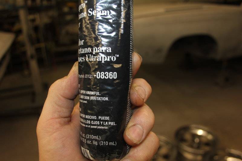

Had someone suggest this product: 3M 4274 Duramix NVH
Sounds like it might be just the ticket for this application, doesn't expand or shrink, remains flexible and plenty of work time.
This is like what I used. Worked very well! and I used grey version of the 3-M product. I am out right now. can get the p# of the grey if you need.

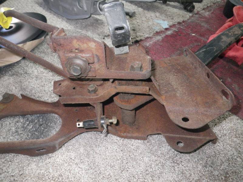

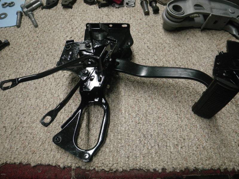

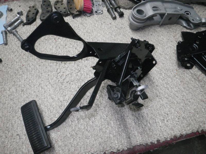

Needed to dismantle the brake pedal assembly to get it cleaned up:

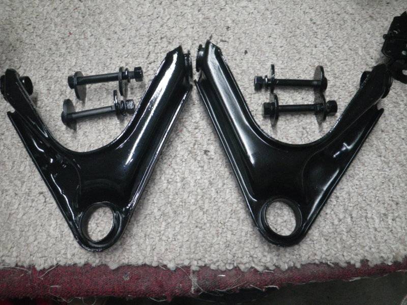

Upper control arms are ready for rebuilding:
Steering knuckles are ready for installation:
