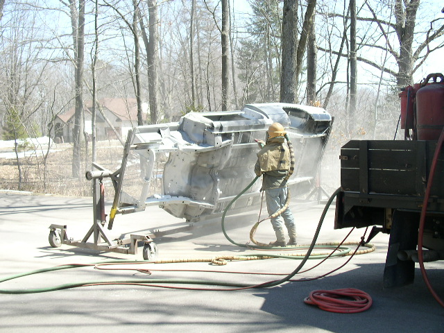

Mother nature gave me a little bit of a break, I got my blasting done on Saturday. i didn't have much to do but I hear you on the precip keeping you indoors.

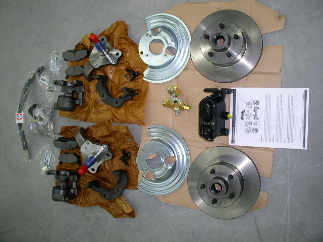

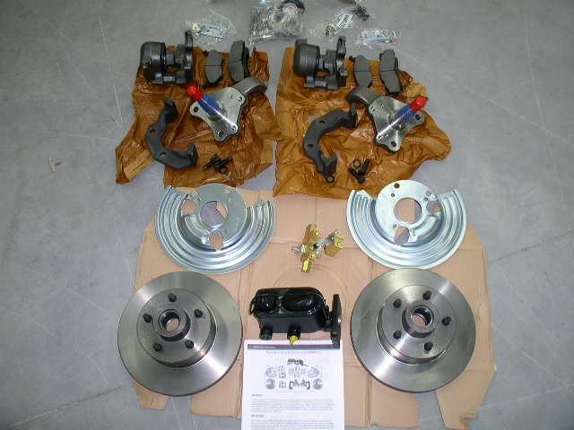

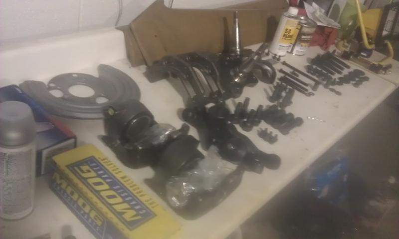

After much deliberation I ordered my front disc brake conversion last week and it was delivered today. I ended up going with a kit from Pirate Jacks made by MBM. I am going from power drum to manual front disc. This is a very nice quality setup and I am happy with the purchase. A few things I was looking for was: a complete kit from one place and not piecemealed together from different vendors, a non plastic non adjustable prop. valve, the correct master cylinder, spindles, and Mopar replacement service parts for the future. This is the same kit that Jegs sells (which I have heard several good reports) but with the addition of the prop. valve and master cylinder. These 2 pieces are new and not available everywhere yet. I have been reading numerous reports from people not satisfied with SBBC or The Right Stuff, enough to make me leery to go that route. As of now I think I made the right decision but of course it will be a year before I will be bolting it up.

I bought the DBK6272 kit, PV6070MOP comb. prop. valve, MC5621 master cylinder, and 5621MRK manual rod service kit. They put these items together for me as a kit and gave me a very decent price on it. The only things I had to get elsewhere was the manual master cylinder backing plate and the manual brake rod.

View attachment 112509View attachment 112510
Looks like a great collection of parts Elk, I really wonder if it will be a year though, Your moving along kind of fast and its shaping up great! Been awhile, i had to throw some kudos at ya lol.. im watching, quietly but watching :)
Nice looking kit H2E! Thanks for sharing the info.
I think it will work nice Prop. They are a decent business to deal with - friendly and helpful. And thanks for taking the time giving me your opinion on brake swaps.

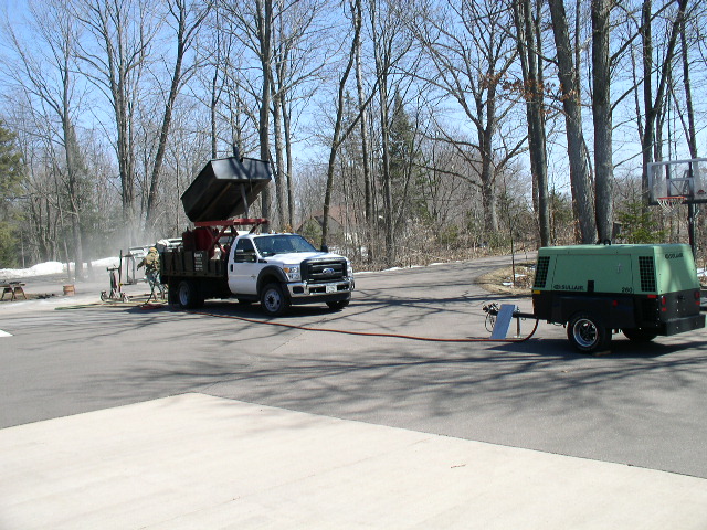

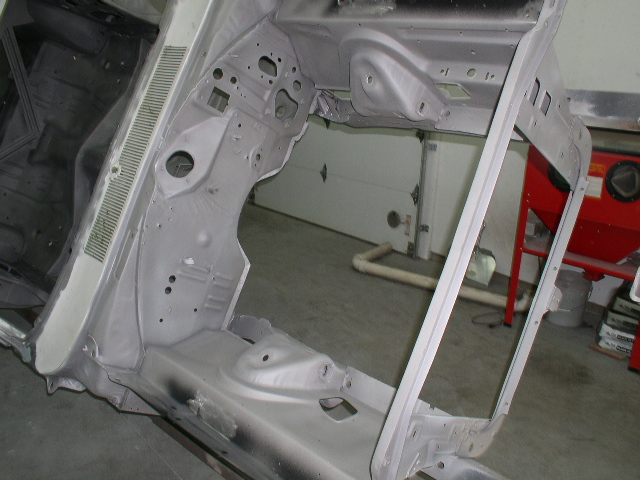

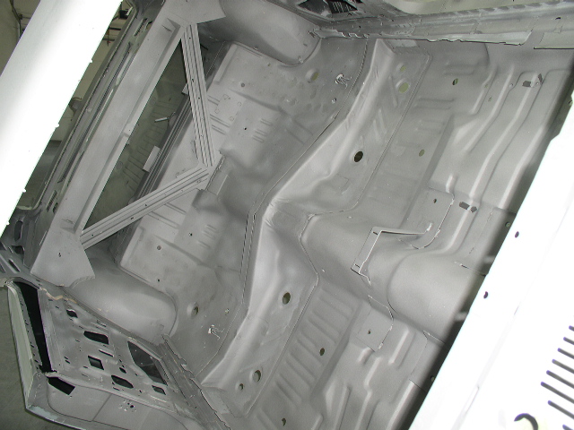

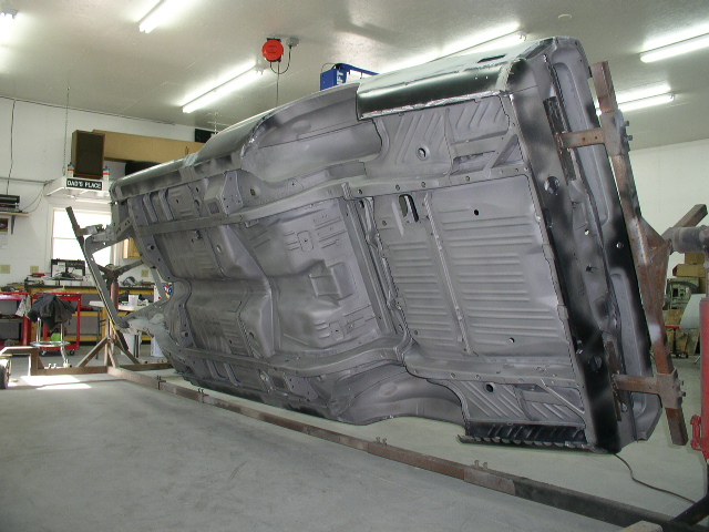

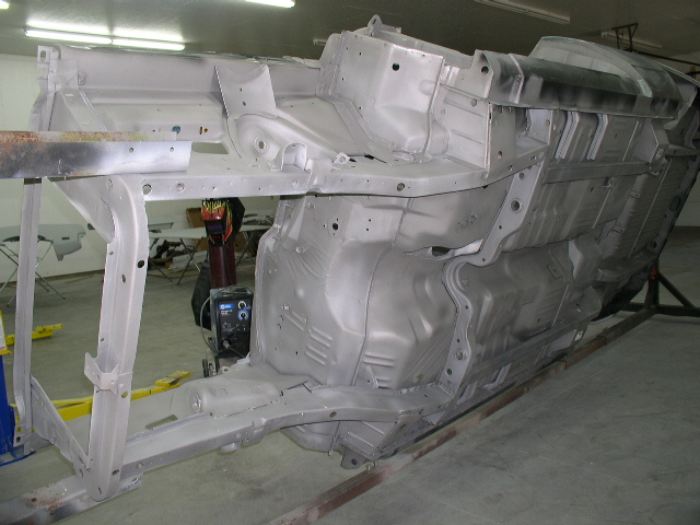

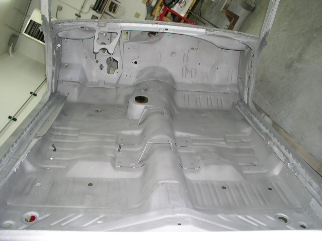

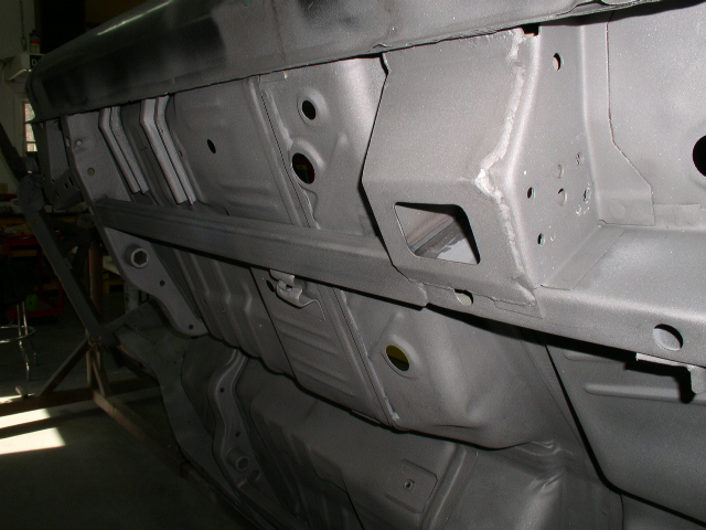

Saturday afternoon turned out to be really nice although a little chilly. At least there was no precipitation falling. Finally got the car pushed outside and blasted. Now I can get the trunk and floorboard spot welds smoothed over with a little Duraglass and ready for primer. Rain, sleet, and snow is in the forecast almost every day this week, so I am extremely glad we were able to get this outside stuff done.
P4200118.JPGP4200119.JPGP4200120.JPGP4200121.JPGP4200122.JPGP4200123.JPGP4200124.JPGP4200125.JPG

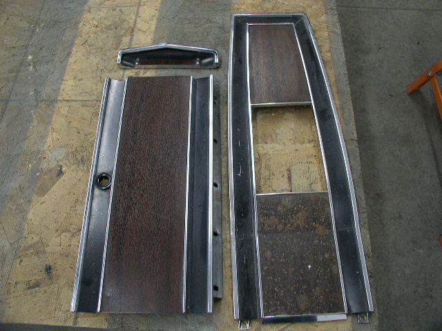

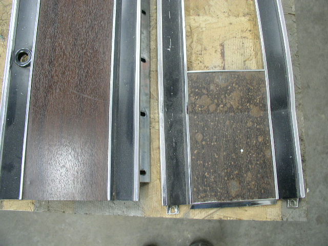

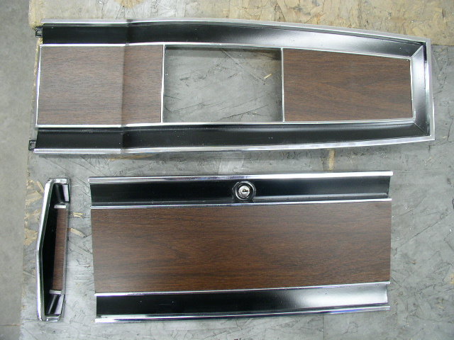

Some before and after pics. of the console tops I just finished up. Stripped them down, sprayed on fresh black semi-gloss, and replaced the imitation wood grain. Turned out pretty good if I do say so myself.
View attachment 111411View attachment 111412View attachment 111413
I'm a little late to your last updates but the color you have picked out for the body is going to look great and you console plate look really nice. What color/brand paint did you use on the black?
I wish I had the exterior color figured out, but I don't as of now. I used a semi gloss black PIA brand black on the console tops.
