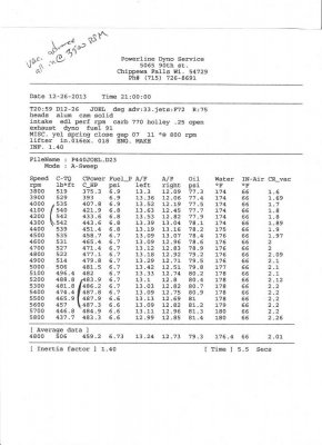

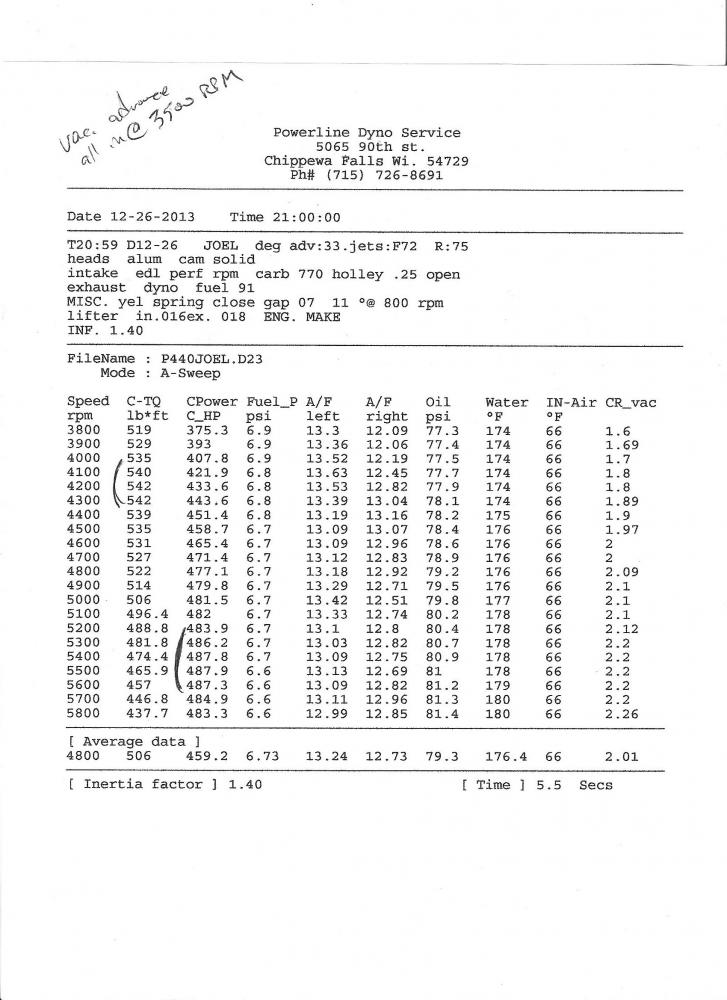

The new distributer came in from Mancini and we were able to finish the tuning. Ended up with 487.9 hp and 542 ft. lbs. of torque. This is the kind of power I was looking for so I am pleased with the build. They were going to build up a crate so I can haul it home tomorrow. :headbang:

Those are some nice numbers, can't wait to hear the actual experience you feel behind the wheel.
542 of torque.....you better buy some stock in rubber, your gonna need it!!!! lol

You are not the only one lol. I think I will be happy with the power. I was looking for a build with ample torque that would still be dependable and streetable.

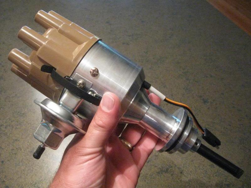

Wonder what dist was in that Kit from Mancini? I thought they were using a Firecore? Do you have a pic of the bad one? I got a Firecore this past summer and its been a great unit. Lots of guys over on DC.com are running them without problems. Does the factory dist have adjustments for mechanical advance?
This is a Firecore, they have billet bodies.
I already sent the bad dizzy back to Mancini so no pics to post. They are having them made by some company here in the States, but I can't remember who but it was not Firecore. It looks just like the factory units, but does not have the provision to adjust the vac advance through the port by the diaphragm. Neither of these units are capable of easily adjusting the advance curve. I am kind of upset about my ignorance on distributers, because if I had known about the Firecore 6 months ago I would have boughten one of those. And the worst part is that for the time and money this current one cost me, it would have been cheaper to buy the Firecore upfront. And I would have been able to easily adjust the advance. I am not sure the current springs are going to be the best in mine as it is not all in until about 3400 rpm.

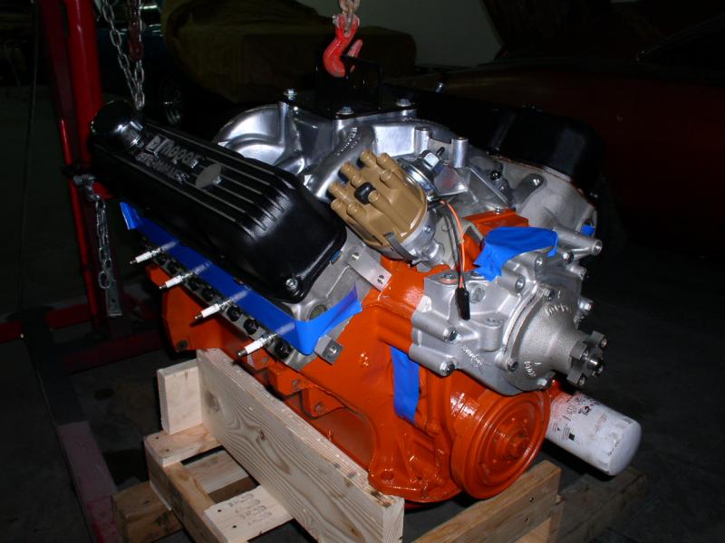

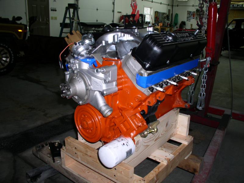

That motor looks great "beautiful". As for the motor install I've put mine in one at a time and both at once "Way easier to drop tranny and motor in at once I think". The only real thing you have to do is have the car high enough to allow the tranny to go in pointed down at a good angle and leave the accessories off of the front of the motor, water pump, etc. Just my 2 cents but I like not having to deal with the torque converter, starter, bellhousing bolts etc.
