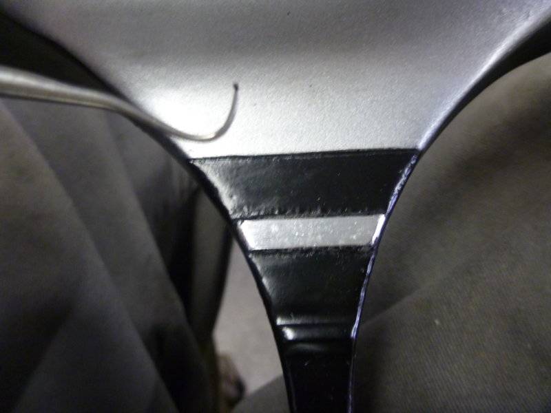

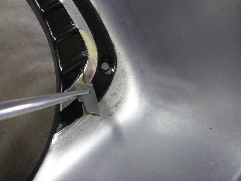

A little bit of dental work to clean up a bit of bleed out

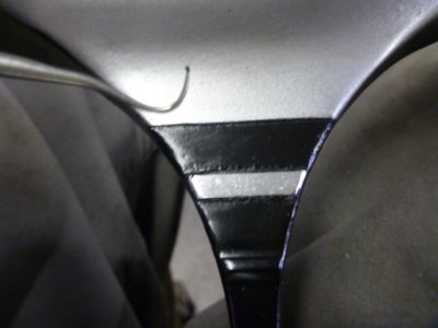

A little polish and touch up on the "Argent".

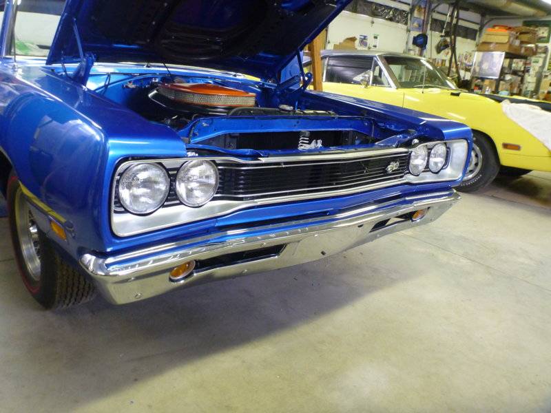

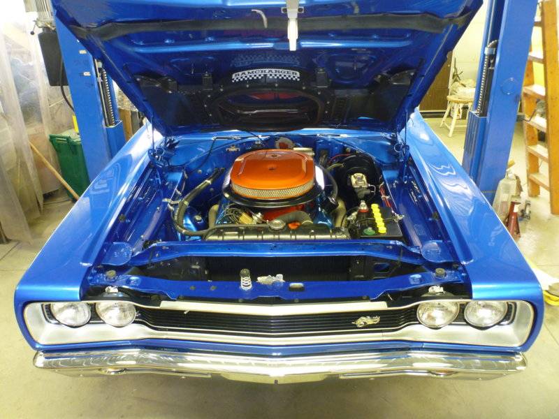

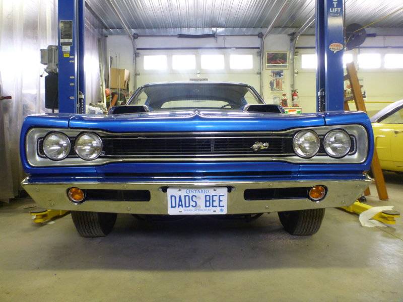

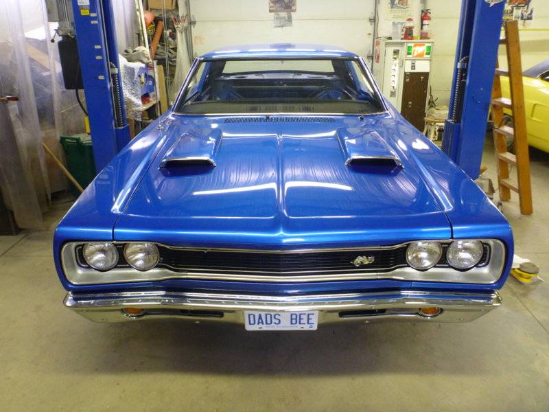

Front end of the car all done, other than alignment, adjuster hole shield install and undercoating in the wheel wells. Oh and wiper arms and blades, I have some nice NOS ones for that!
Yep.. DADS BEE ! Couldn't believe that plate was available when I ordered it 2 years back.

What a flipping beauty that is!
Car looks amazing Wyane!

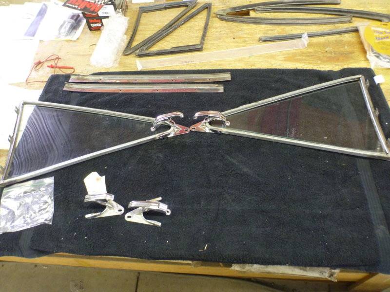

Thought I should tackle the rear flip out windows first. I didn't pull any of the glass, other than the windshield, so been a tad apprehensive as to how this is going to go. Why I wanted to remove all the glass and trim, but the paint shop moved the car pickup forward by a month and wanted the glass left in. Wish I'd said "no I'm taking it out so I know where everything goes and can take pictures".. but I didn't want to miss my chance since I'd jumped their wait line by over a year.

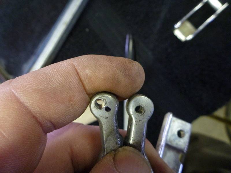

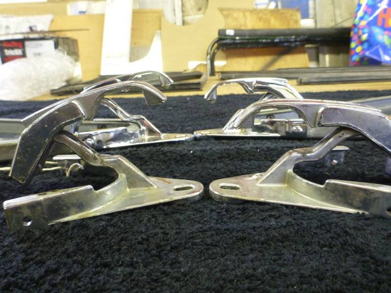

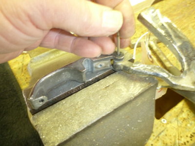

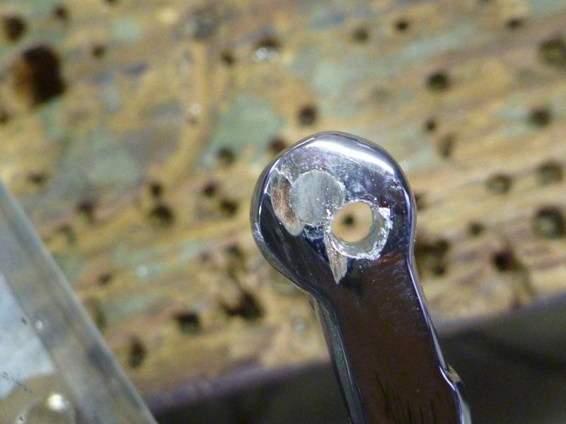

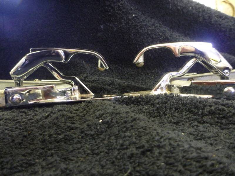

Something I've always hated, the passenger side latch has never gone over center to lock. So I bought a spare set for parts and guess what ! I wonder how many thousand were done wrong before anyone noticed.. or if they ever did.
Knocked the pivot pin out on both spare latches to see how far off they have the pivot pin hole.
Yah.. that might do it. NFG location on the left.. good on the right.

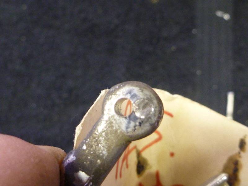

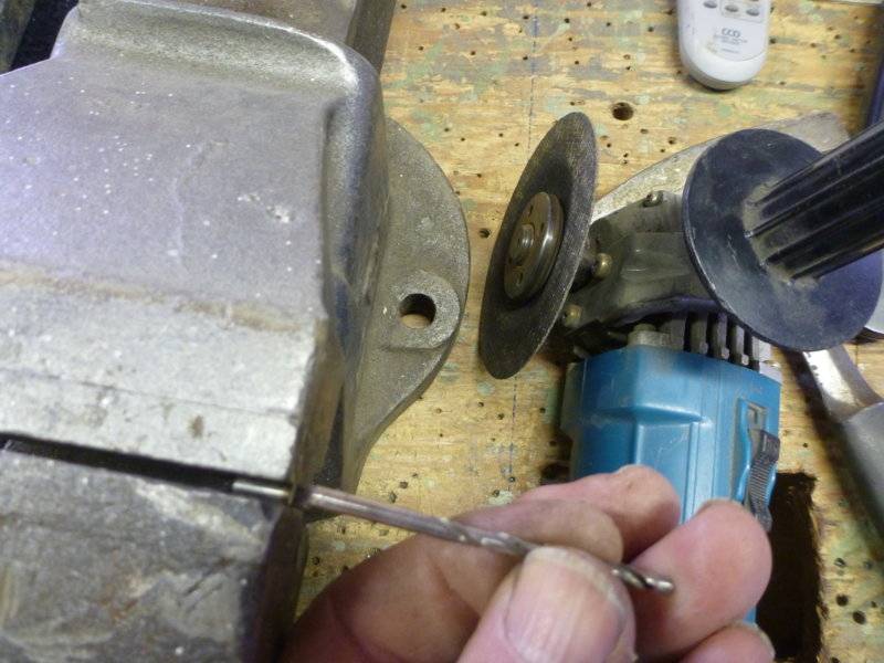

Cut a piece of 1/8" drill bit shank to fill the hole.
Put the filler pin in place and drilled a new 1/8" hole beside it to move the pivot point.
Worked good on the spare, time to do it on something expensive in fresh chrome.

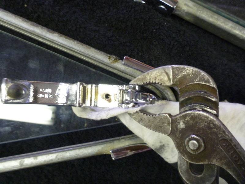

Success, other than some dumb *** with a grinder just had to lick the filler pin.
Didn't want to pound on the good one, pin pressed into place with channel locks.
Now both Preying Mantis' sit the same height and will actually lock the window.

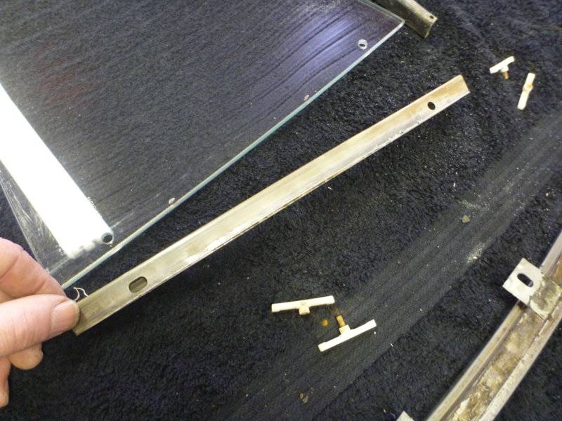

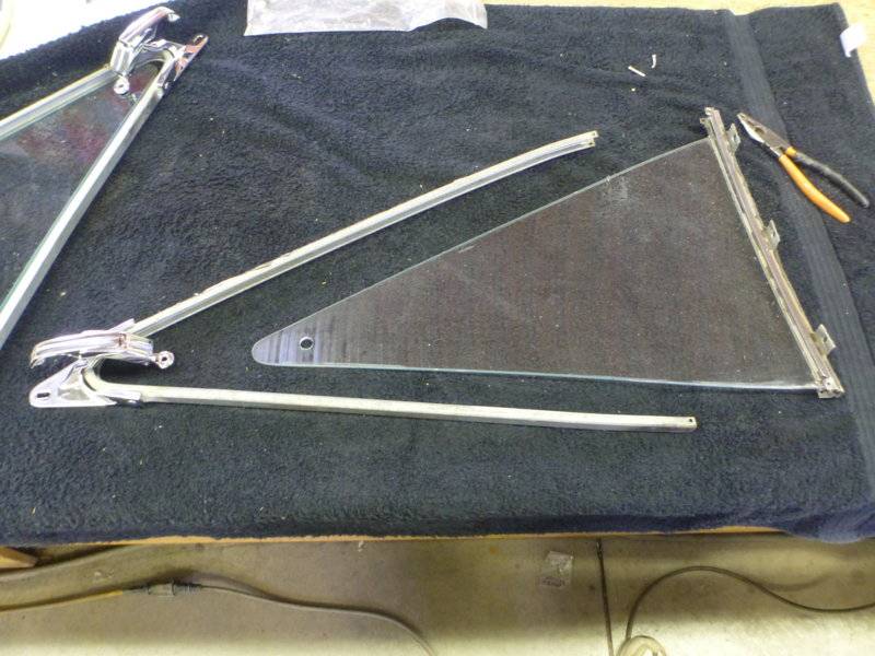

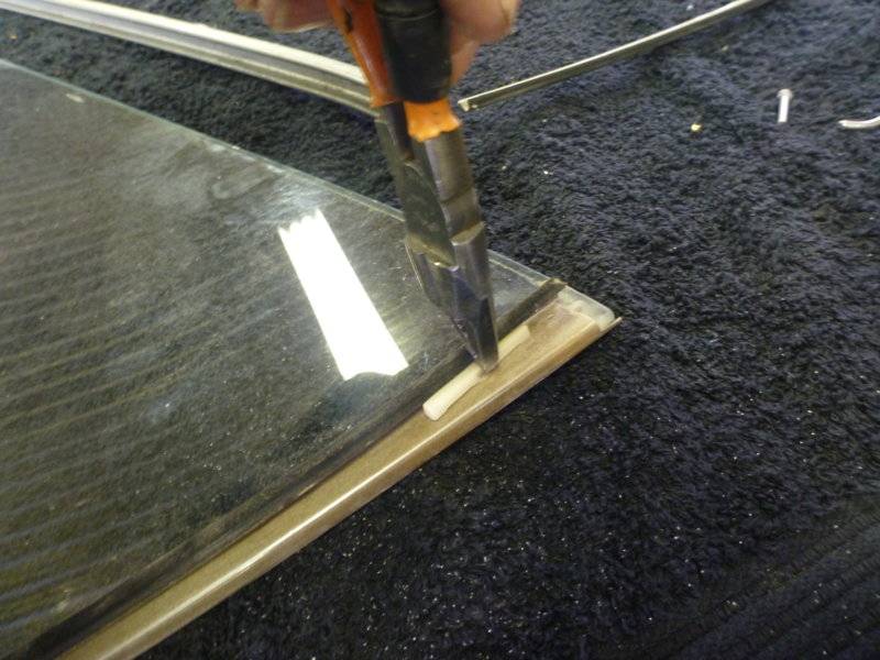

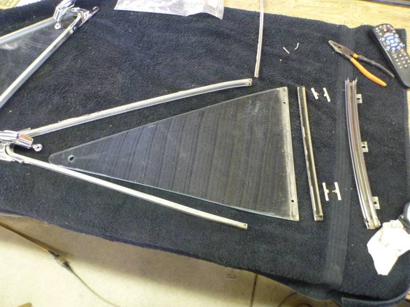

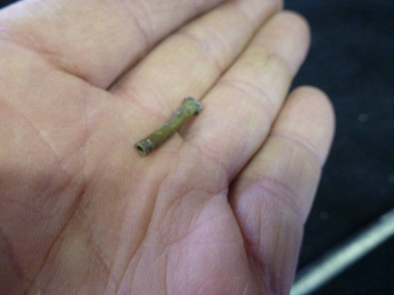

Drivers window assembly apart by removing the tubular rivet at each end of the hinge channel.
Removed rivet.

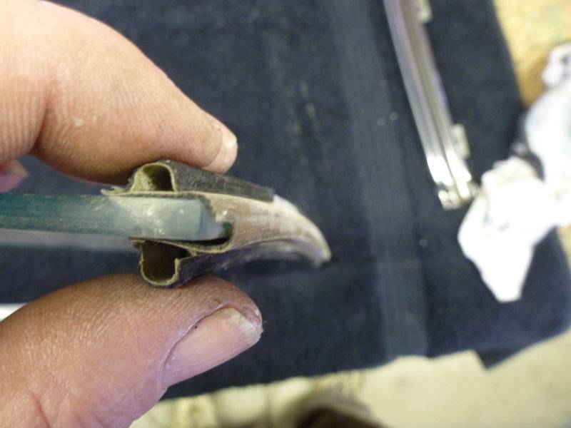

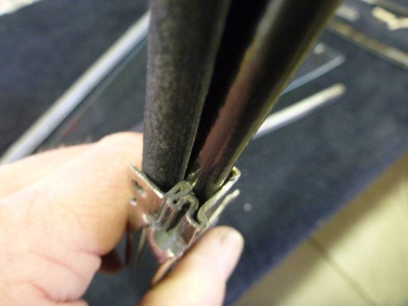

The "hinge" is just the same mylar type seal and slider pins that are used on the door glass on the front edge. I had hoped a single strip would be just cut in half, so I'd have a spare, but nope gotta use a set as they're a few inches too short to get two from one.

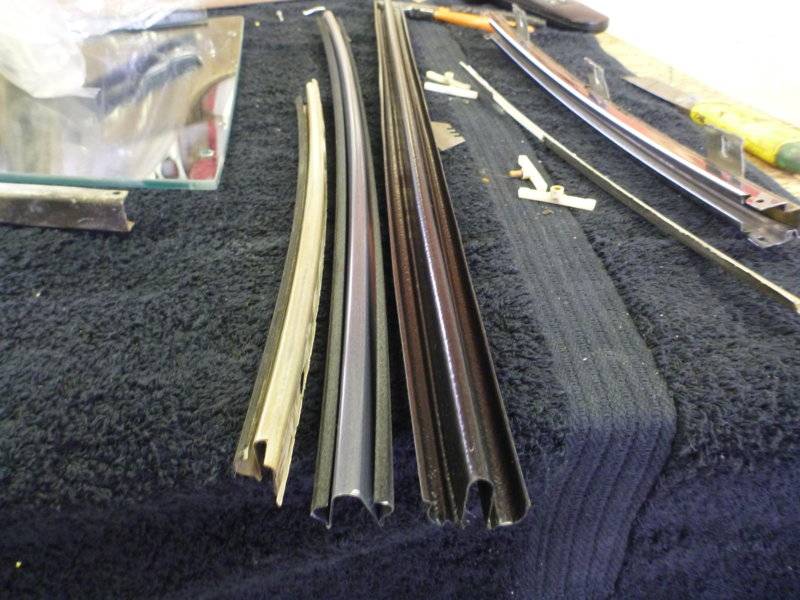

Carefully seperating the two sides of the OE guide sliders ( glass retainer in this case) so I can use them in the front door glass vs reproductions. Repros are good enough for these windows as they don't slide, but are too thick for the door glass to work correctly.

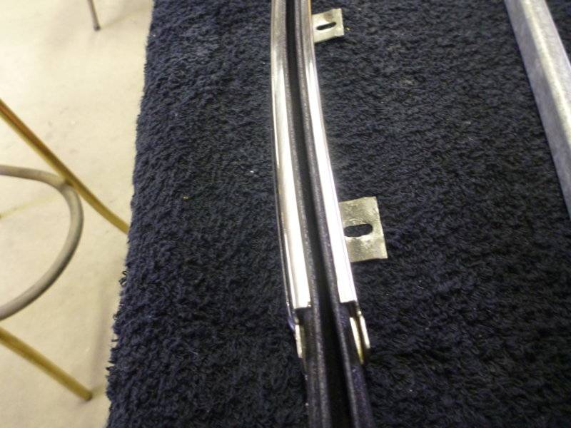

All the parts laid out.
OE hinge / seal with one side torn off, showing the punched hole top and slot bottom that the slider pins go through and then the holes in the glass.
OE left, properly shaped and curved Chrysler OEM middle and reproduction right. Both expensive as hell and getting worse. As much or more than $300US a pair now I hear for the OEM, if you can find a set. The Repro is no where near correct and over $100 for two pieces of mylar, but will be used in the flip out windows. The OEM on the door glass.
Testing the repro seal in the hinge channel.
Doesn't fit too bad, but needs that incorrect edge trimmed off the curl to sit correctly.

Wayne, thanks for starting me to worry about mine! I “think” one of mine broke yrs ago, so I got lucky that dealer still had them back then. Maybe ur new w/strip has an effect on the latching fully?
Nothing to do with new strip Jeff, I haven't put it together yet. It has NEVER latched since day one,, 1969. As shown the spare set I bought have the hinge point in the EXACT same wrong location and I corrected both of them. It's passenger side only, the drivers sides are good as mfg.
Yours probably broke back then as someone forced it to try and latch it.. it won't go with the pivot pin in the wrong location.

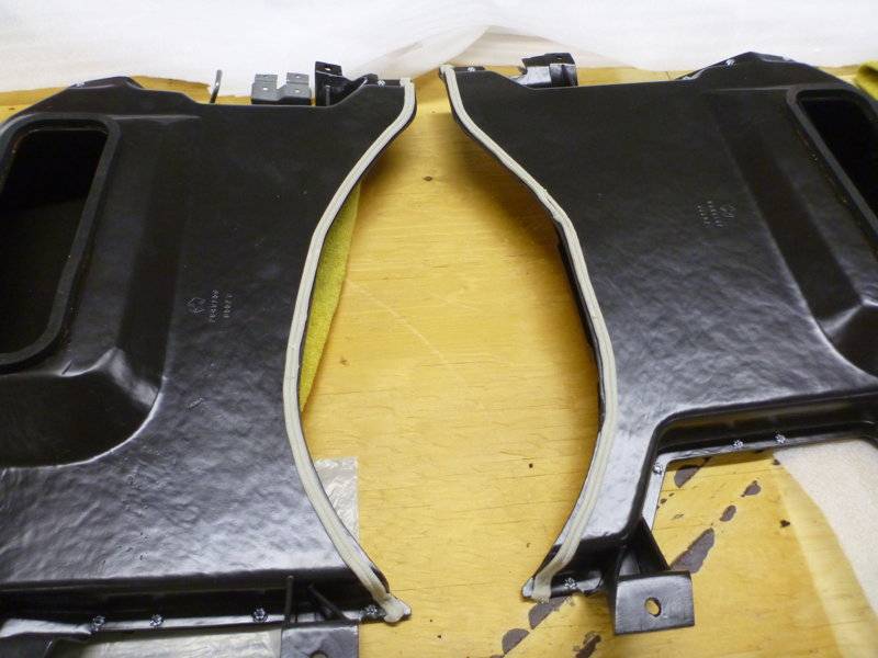

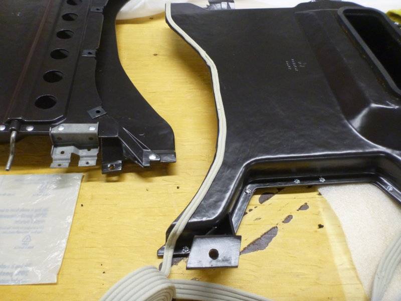

wayne i am putting together my ramcharger air box,where did you find that cord seal to add to both sides of box to seal those sides? thanks
Out of the box with my door panel vapour barriers... David supplies a box of it with same!! LOL... available at most hardware stores at "crack seal" weatherstrip.. easy to apply putty strips in white or brown. Ma used white..

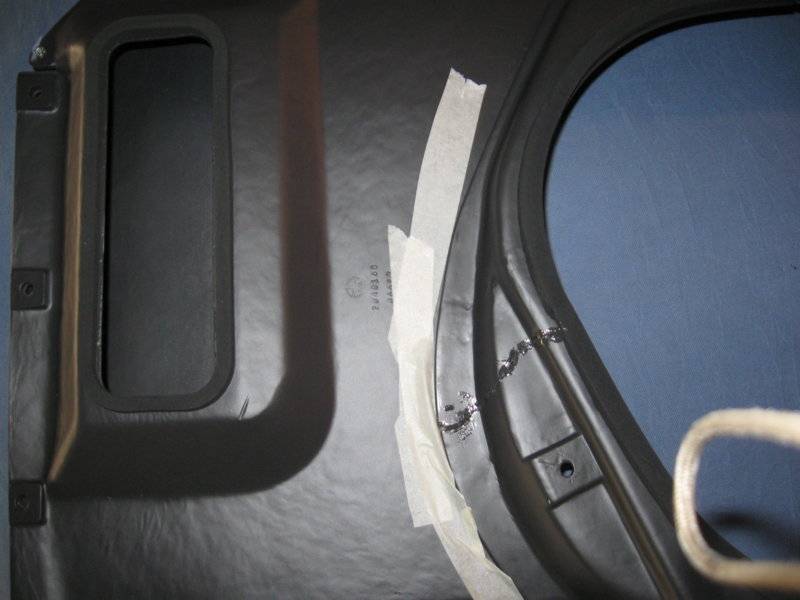

wayne,what did you use for the round outer edges for the airgrabber in pic below around where the tape is to fasten it on center section. thanks
I have no idea what you are asking Johnny... but hope you are going to add some reinforcement to that crack repair.
i will clean crack up, what i am asking is the center section has the four screws to attach outside of box,on the bottom side of center section,but on top side of center box how do you fasten it to the center section.if that is clearer?
maybe this is clearer, the four holes have the screws to attach to center,but flip that side over the rounded side what do you do to fasten it to the center section?
You don't.. that's where the cord seal goes, between the center and the outer boxes. Those holes are only for the rubber air filter seal to attach too.
I was gonna say Man that box is in nice shape.. but it's mine!! :D

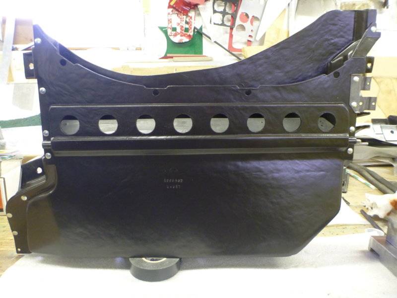

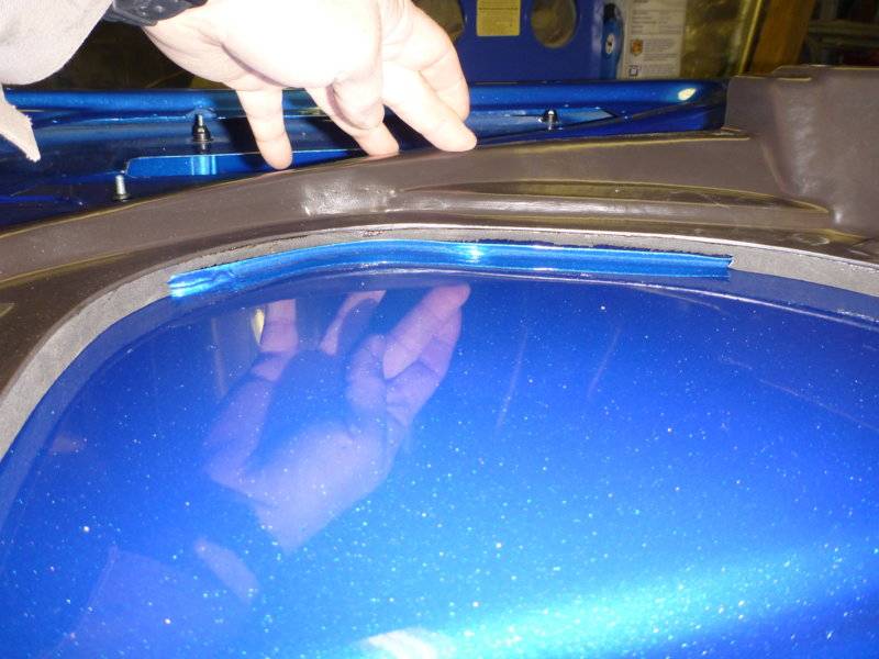

Here's a few pictures going onto the hood. Center gets riveted in place, cord seal affixed to the outers so it will sit between it and were it overlaps onto the center section. Then the outers get riveted and bolted in place. Make sure before you start that you have TIGHT holes where the rivets go. Fix them now if not, not after the fact like I had to do!
