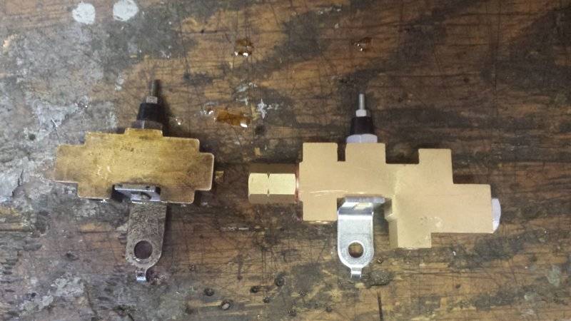

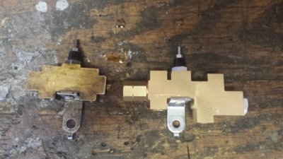

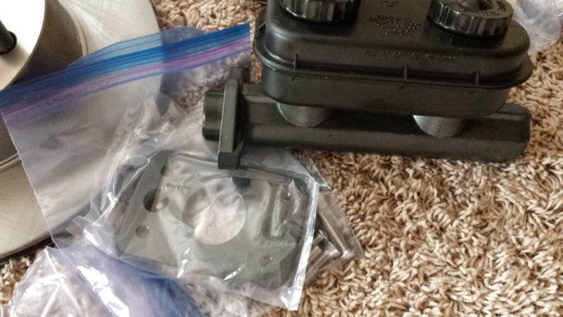

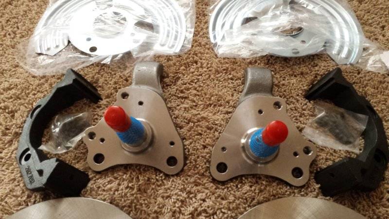

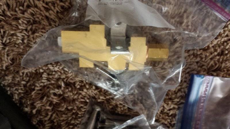

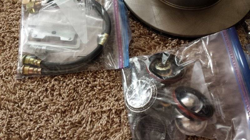

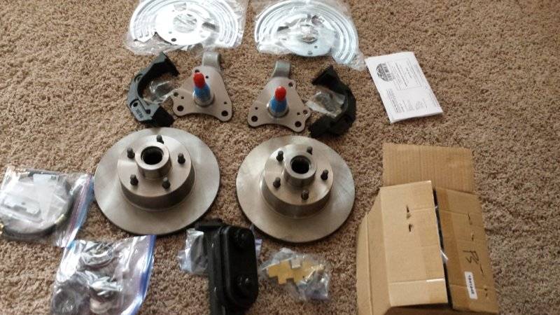

Front disc brake kit has arrived. Ordered from Dr. Diff. The rotors showed up from Rockauto and ate listed as 1978 Dodge Aspen parts so the rest of the parts probably follow suit. Looks easy enough and all parts are there. These are for manual brakes and I ordered the 15/16" master cylinder plus the correct proportioning valve.

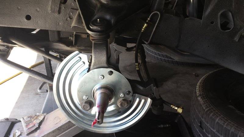

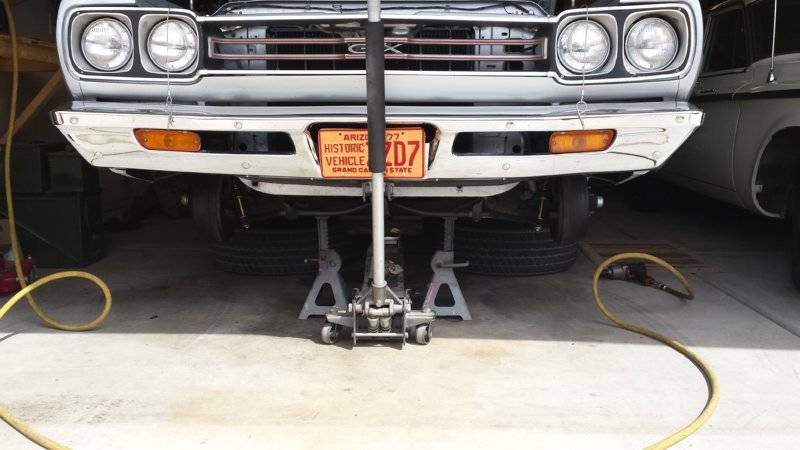

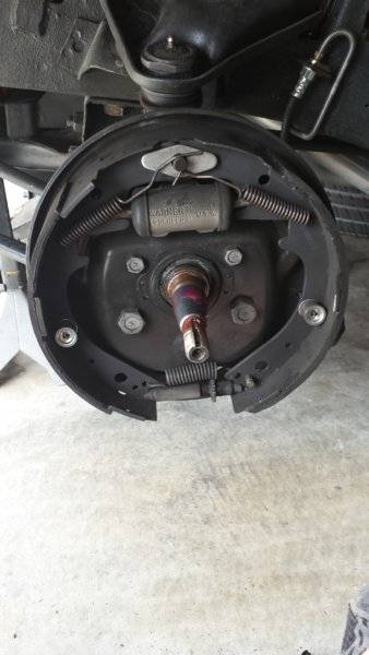

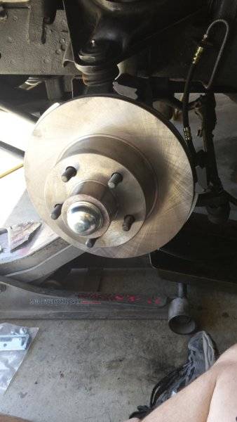

Out with the old. Jacked up, jack stands. I moved the jack stand under the lower control arm to keep it up while I R&R'd the spindle/lower ball joint. Another issue was lining up the cotter pin holes with the castle nuts but I eventually got them aligned and installed.

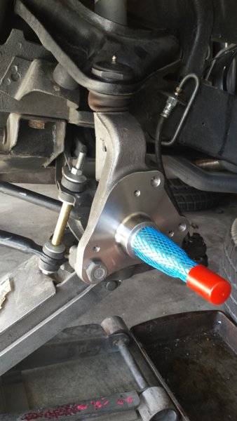

New spindle installed...

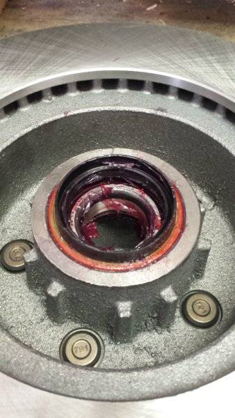

Then I assembled the rotor, bearings and seal. I packed the bearings, layed it in the rotor and set the seal. The rotors come with the races installed...
Then I attached the caliper bracket using anti seize...
Splash shield (Bill told me I could delete this to aid in cooling so it is optional).

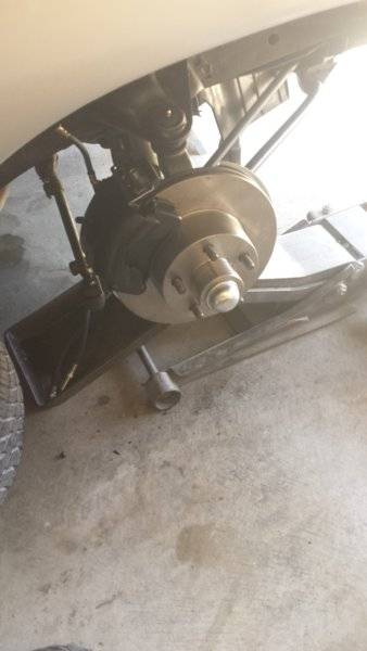

Next I installed the rotor assembly and filled the cavity with grease, installed the outer bearing, washer, nut, nut retainer, cotter pin and dust cap...

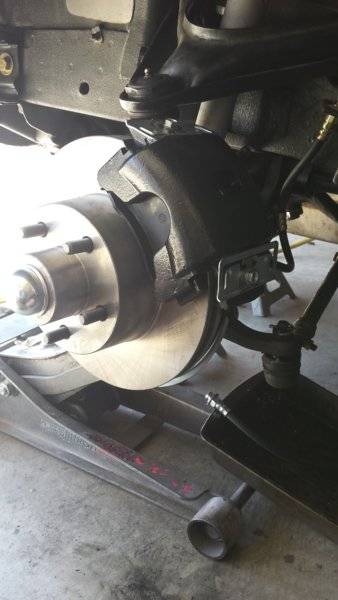

Caliper gets put into place after modifying the outer brake pads (bend over the tabs for a tight fit to caliper) and then the retainers and brake line. Now onto the next side...

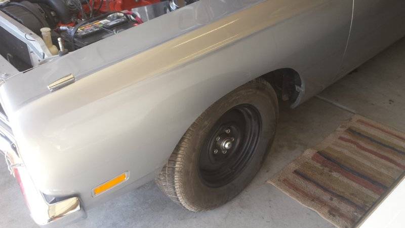

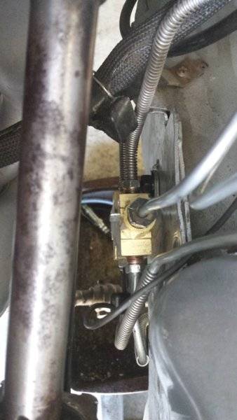

My knees are good so far. I have both sides finished and the distribution block installed. No issues with either although I spent 10 minutes dicking with the undersized chinesium dust cap. I hate new, not fitting parts. Car is back on the wheels, master cylinder is next.

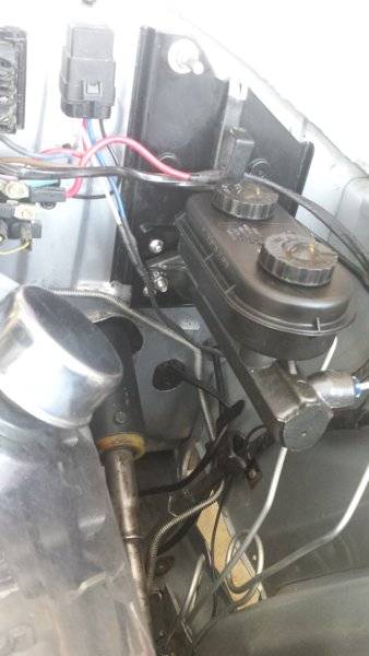

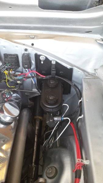

So, master cylinder is in and connected. I need to loosen the brake light switch because the pedal sits higher now. But I am ready to bleed, just need to run out and get some DOT 3.

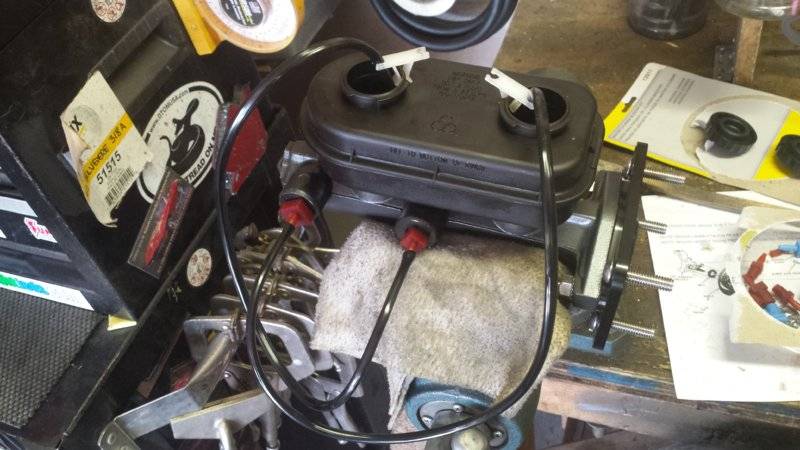

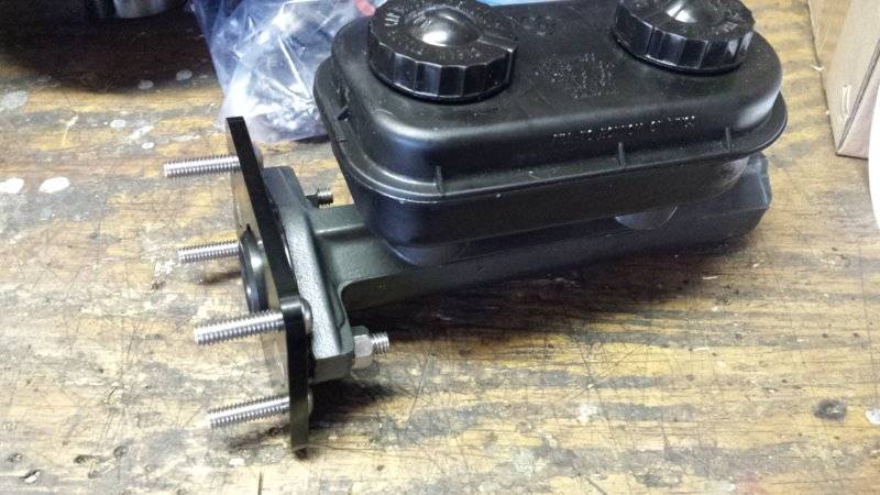

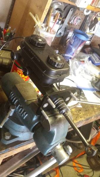

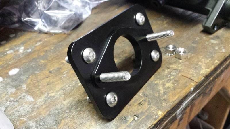

Master cylinder adaptor plate. Its aluminum with threaded holes and went together easily...
Master cylinder bled well on the bench...

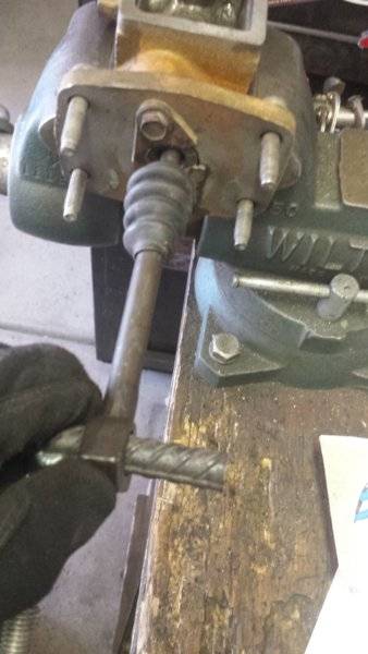

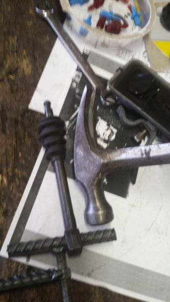

Removing the brake rod....I used a small rebar handle through the hole and hit the opposite side with a hammer and it popped out...

BTW can you share with us your technique to place that upper right nut on the master cylinder mounting stud?
Other than hearing that it's difficult I never really hear how it's done. I actually taped the nut to my fingertip to get it started on the threads.
