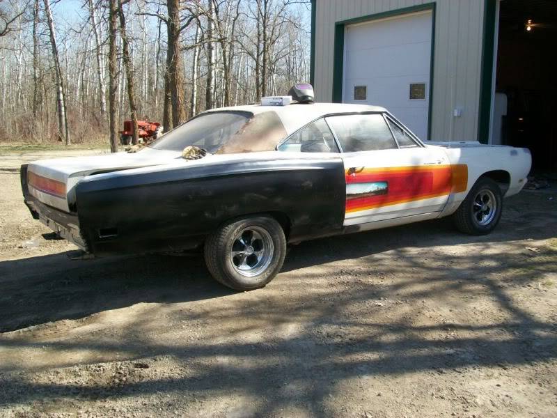

Wow did we have a nice evening, 70 degrees, first time this spring it's been that warm.
So I put the back wheels on the groovy chicken and rolled it outside.

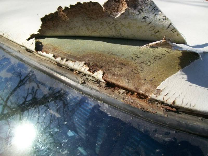

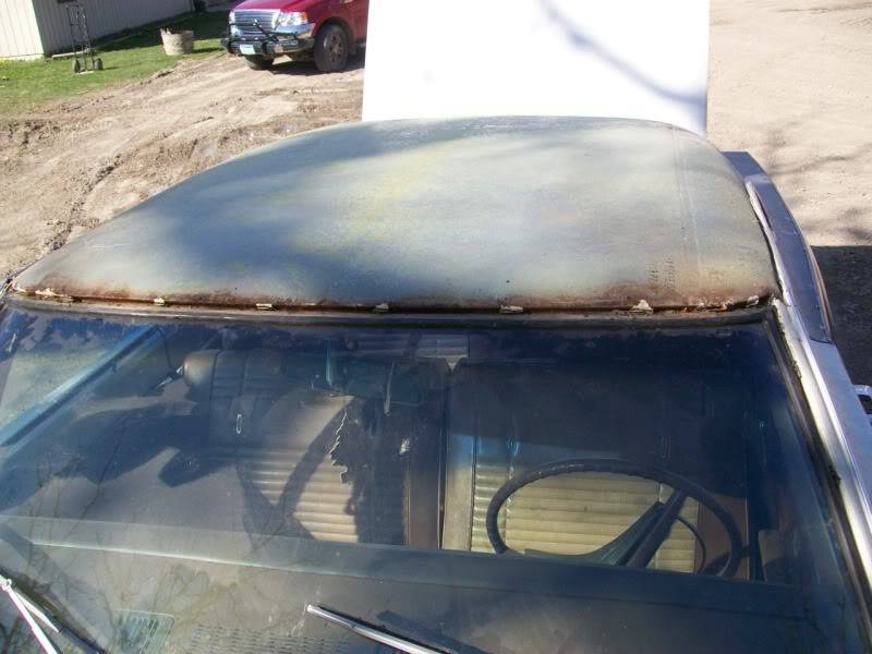

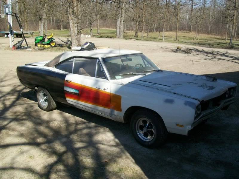

I decided to pull the front windshield trim and peal the vinyl top tonight.

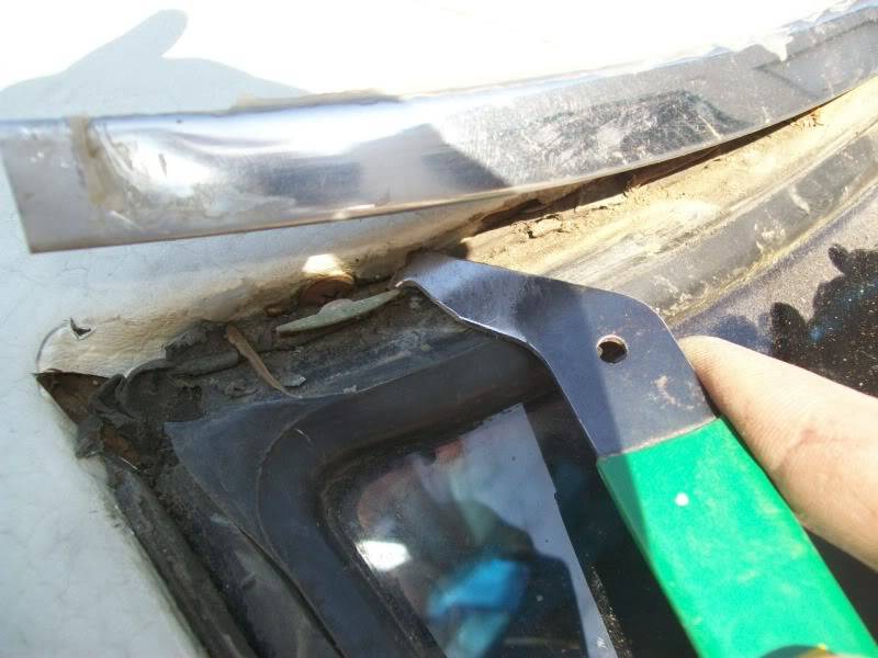

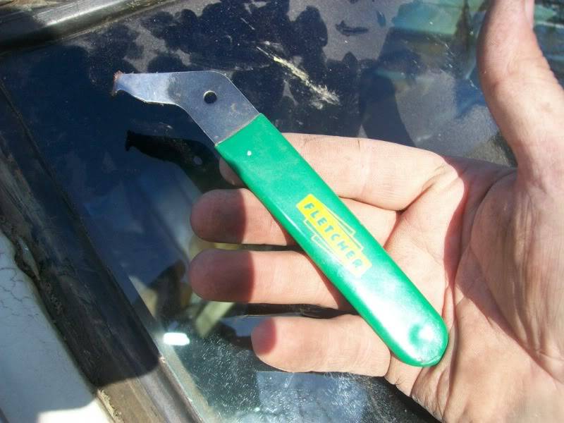

This is the trim removal tool I made several years ago using what was a plexiglass cutter at one time. I ground the cutting edge so it wasn't sharp anymore and I cut a little hook in the blade.
This is how it works, sneak it behind the trim and hook the clip to release the trim.
The front stainless came off really nice, didn't fight me at all and I was happy to see the clips in decent shape and the windshield tray looked decent too.
It's going to clean up really nice, a little pitting but no holes.
I'm seriously considering cleaning and rustproofing around this windshield gasket as best I can and leaving it installed for now through the paint job since we can't get these gaskets right now.
If it works out the way I want it too I will be able to remove the trim next winter and replace the gasket at that time and rust bullet or POR15 behind the gasket on the metal before reinstalling the glass. And that shouldn't effect my paint job at all.
Thanks, I uncovered some factory T7 bronze under the old vinyl top and in the sunlight I have to say it aint half bad. The color I chose is actually a little closer to T5 I think (more copper) and I'm getting more exited now to see it done.
I really don't know if the vinyl will be going back on or not.

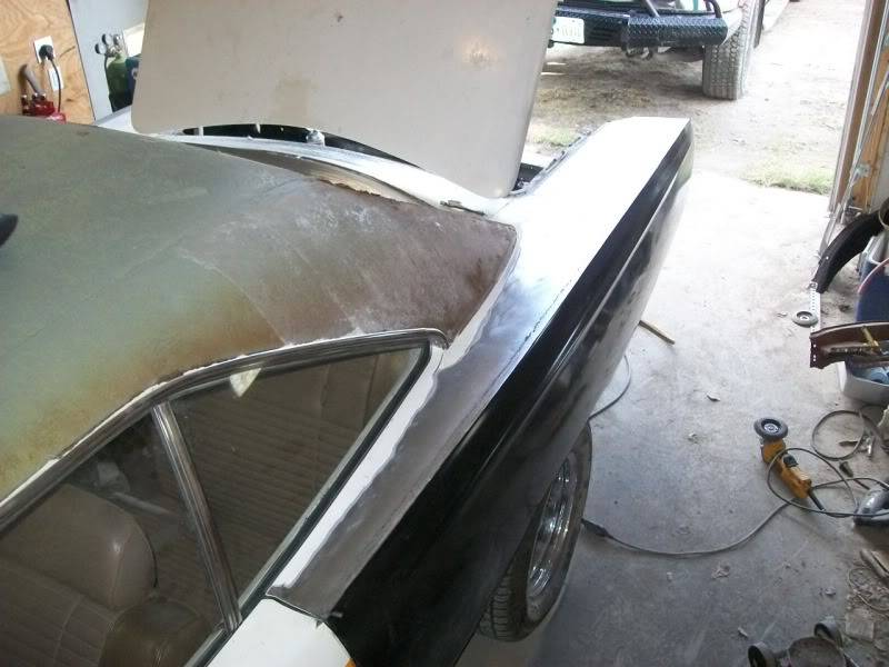

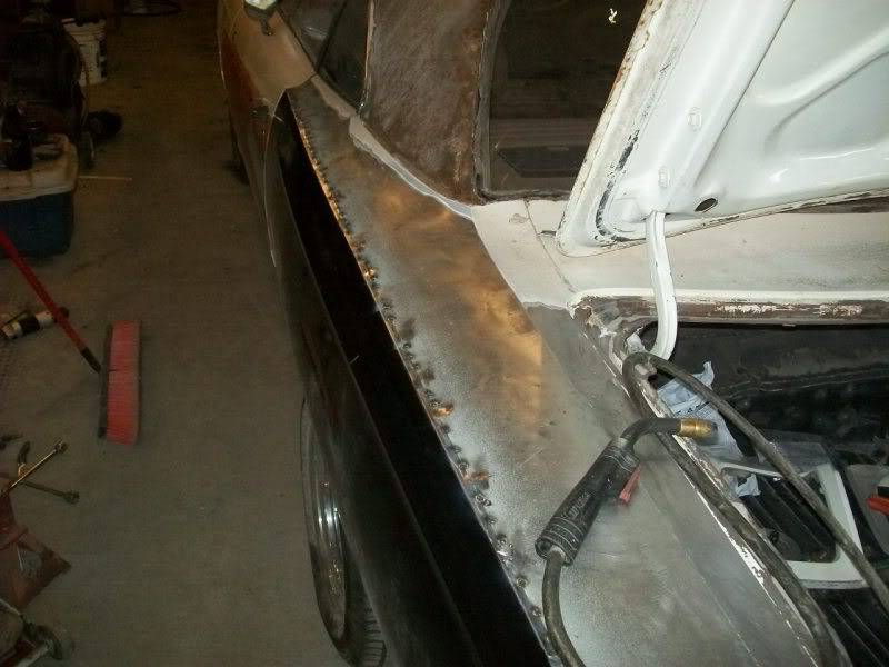

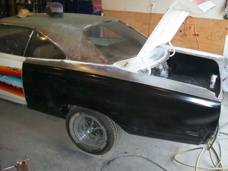

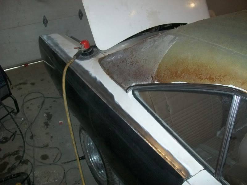

I got the long seam finished up on the RH quarter skin, but that was about it for today. I have to pack the truck for a road trip very early tomorrow morning, plus our daughter has prom tonight.. busy around here.
So, this is all I will get done this weekend. :(
Looking good Dave.

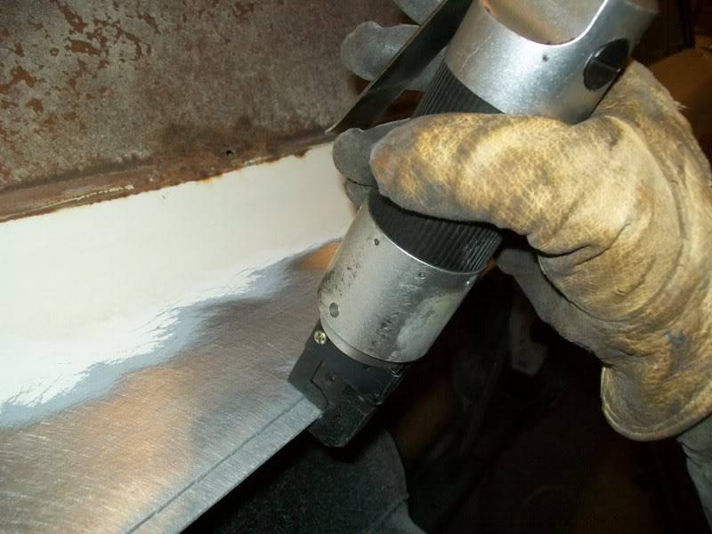

What did you use to flange the edges of the upper 1/4s?
It's a pneumatic flanging tool, air over oil I think actually. Hole punch on one side and flanger on the other side.
Jury is still out on the top seam vs side seam for 1/4 skin... but actually I am liking the top seam option so far.
The real test comes when it's time to dress the seam with some metal 2 metal filler, polyester glazing & sanding.
But from what I can tell so far the rippling from the weld (probably impossible to completely get away from) seems very minimal.
I think it will be really easy to deal with.

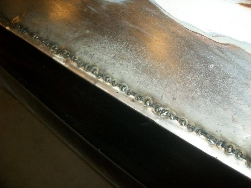

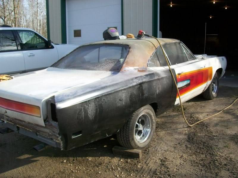

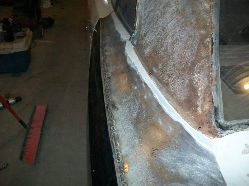

The many, many tack welds that it takes to cover a 7' 4" weld.
After a little grinder and sander work.

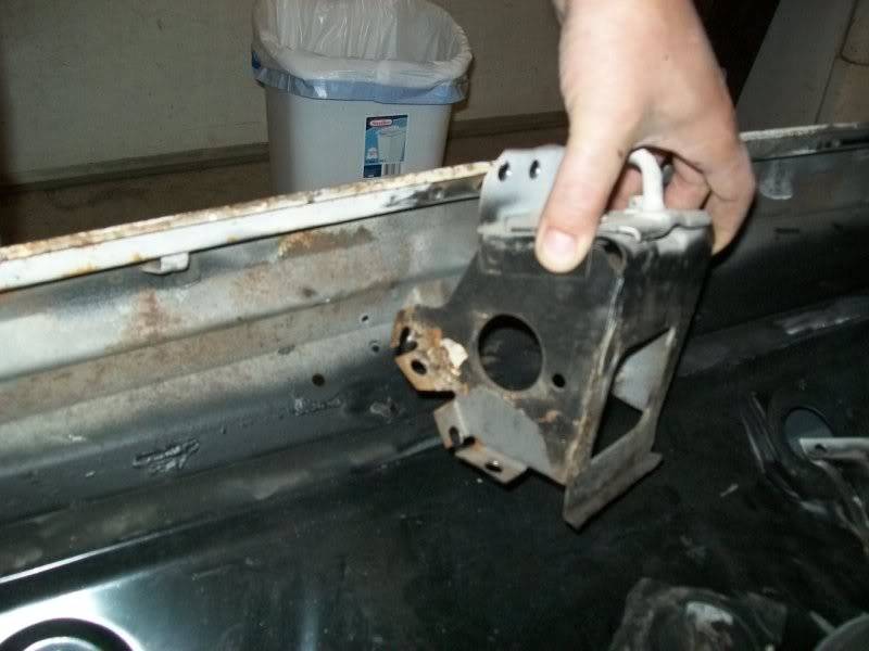

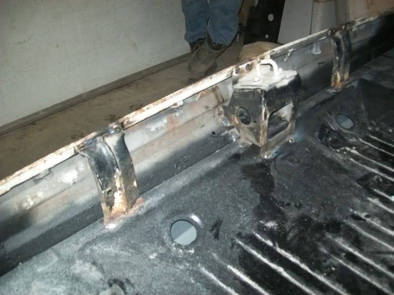

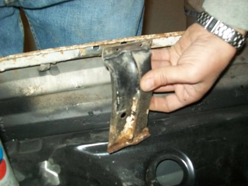

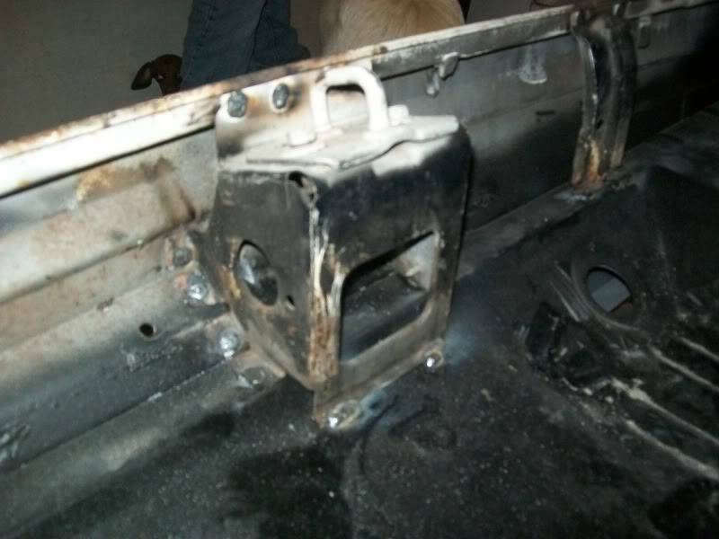

Welding the trunk latch box and tail pan braces back in.

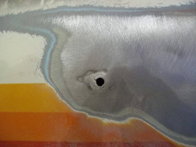

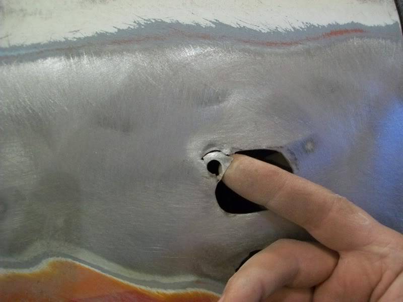

Trouble with the door handle holes..
Going to have to do some welding there.
Great progress on the car!! I was wondering what you used to drill all the holes in the new trunk pan before you put it in? I am installing a two piece trunk pan in my stepfathers 69 Satellite later this week. I really like the tip of using paint to transfer the frame location to the new trunk before you drilled the holes.
