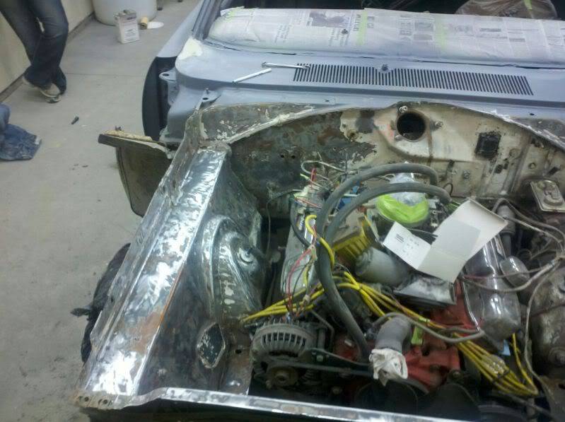

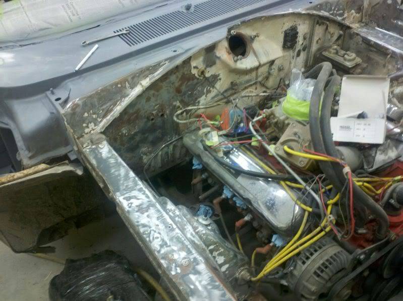

Here's my best worker running the 90 degree angle die grinder with sanding pads inside the engine bay.
The exhaust manifolds are off.
I will cut that shaft out of the manifold and plug the 2 holes it went through as part of my manifold refurb.
I'm really glad I pulled the manifolds, I did have an exhaust leak that sounded like hell under the hood before and I was also getting a bit of a coolant smell from a minor coolant leak on one side that was burning on the exhaust manifold. I see that I was missing one of the special long reach manifold nuts on both manifolds. So I'll be ordering a fastener kit for these along with my gaskets.

Ma did some more engine bay sanding tonight and I did some detail filling/sanding at the back bottom corners of the door openings to improve the reveal. Then I switched over to some blocking with 120 grit on the body prior to my next shot of epoxy which will be followed quickly by my polyester primer.
Once I get my poly prime blocked to around 400 I'll urethane prime/seal. Then I can start spraying color inside the doors, engine bay, inside trunk, under side of the trunk lid/hood...
I'll spray base, then clear, then mask and shoot the A-surfaces.
(I still haven't touched the fenders though... :eek: )
