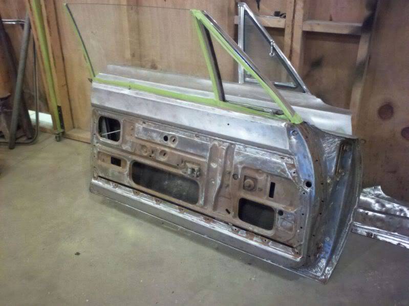

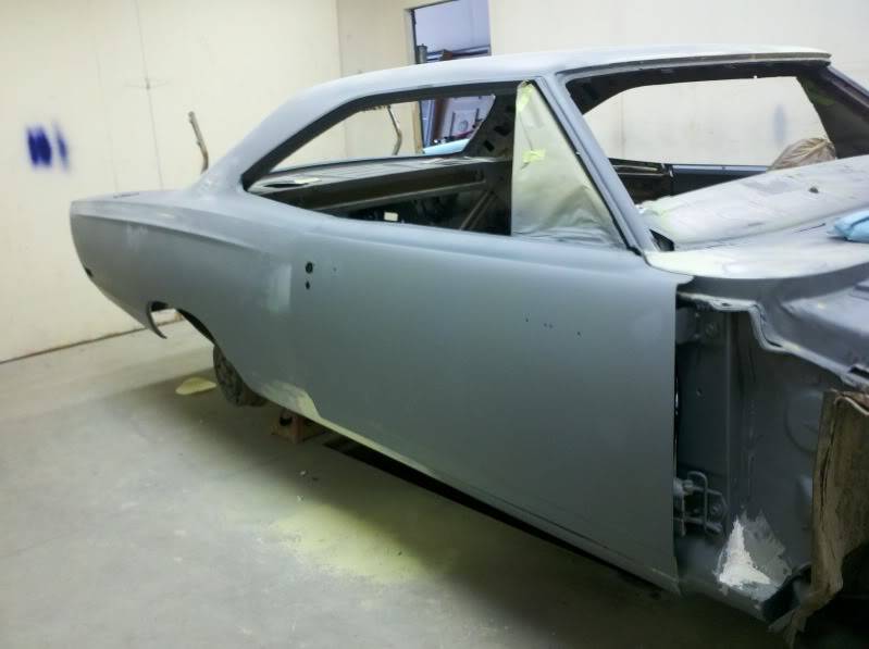

I took one of my doors over to a friend's body shop. He mixes paint for color match of course, being a colision repair center and all.
We found a little original paint unrer the door weatherstripping that hadn't seen sunlight in it's 43 years. We matched color to that.
It doesn't sound like a big deal but it was kind of exciting for me, because color really isn't too far away.

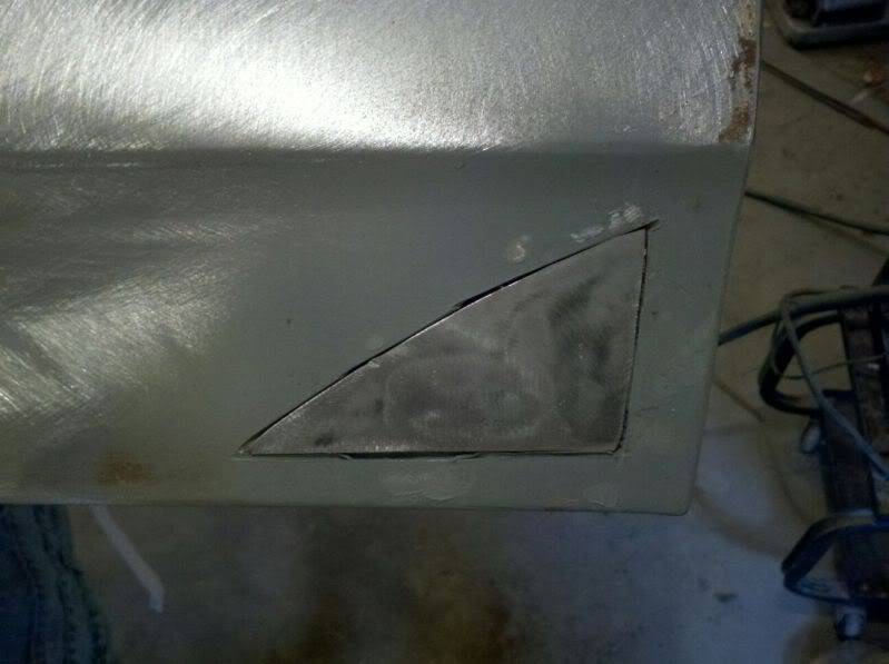

Well here's one of my metal patches at the bottom corner of a door, trimmed and ready to weld. I did both doors. I also repaired a door that had thin, ripped metal at the door handle holes but didn't take pictures.

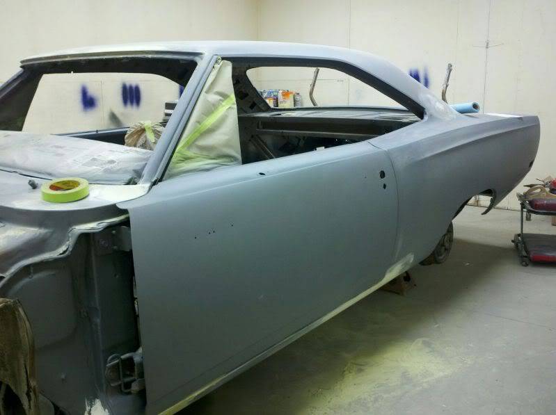

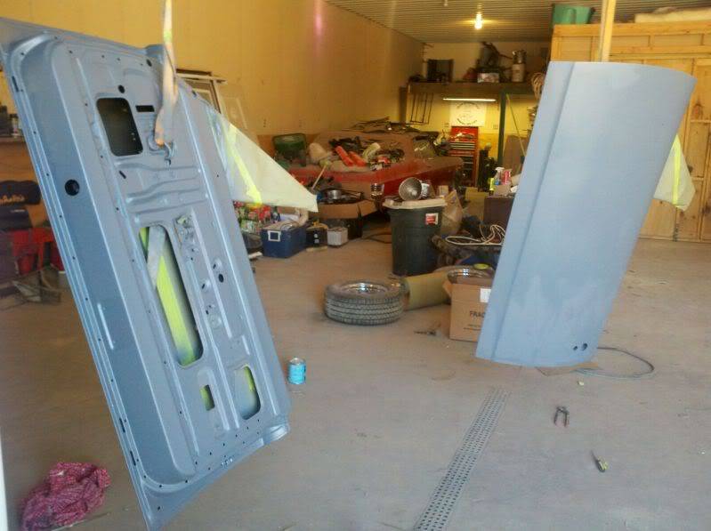

The doors are both ready for primer.

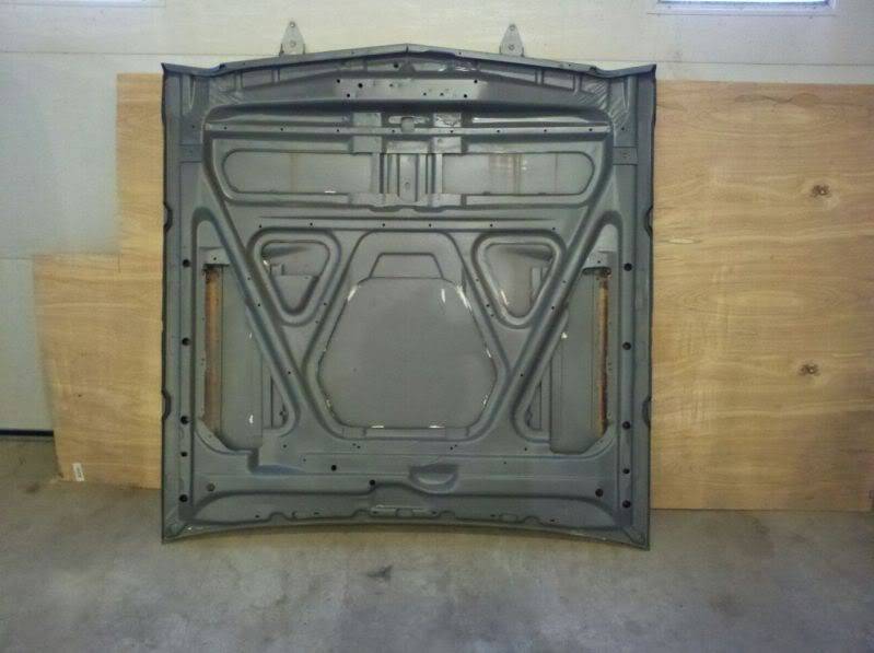

Bottom side of the N96 hood got a couple spot welds fixed, got sand blasted and primed today.
Trunk seams got seam sealer, I try to simulate factory seams which are actually pretty crude...

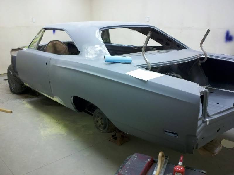

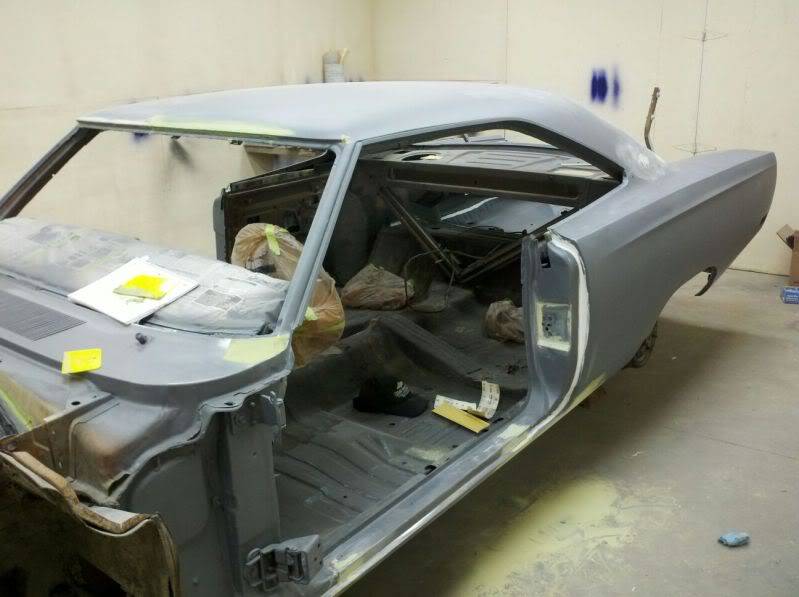

And the main body continues to endure minor tasks with seam sealers & and spots of filler here and there, mostly where it had factory filler. Body seams by rockers, sail panels and cowel.

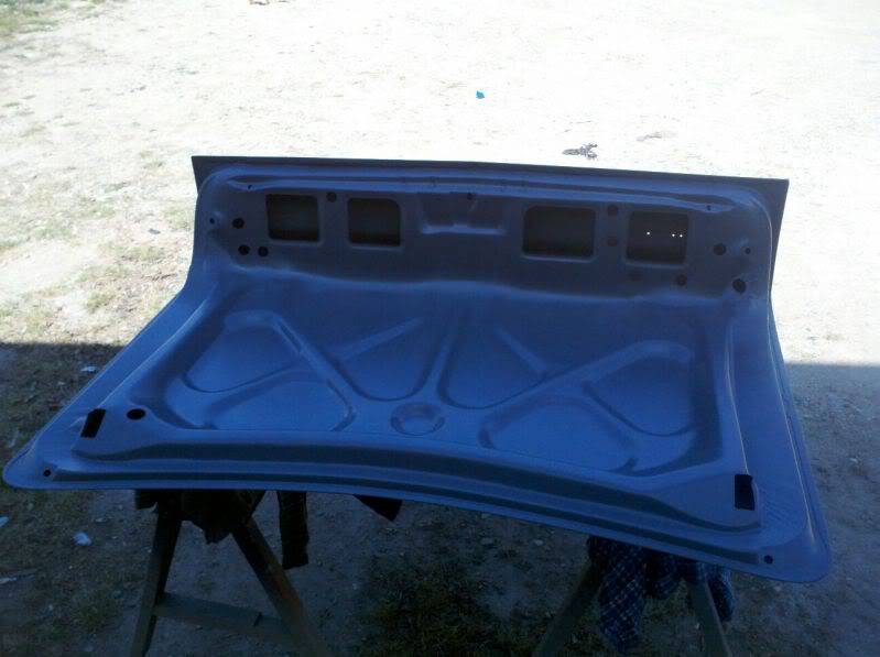

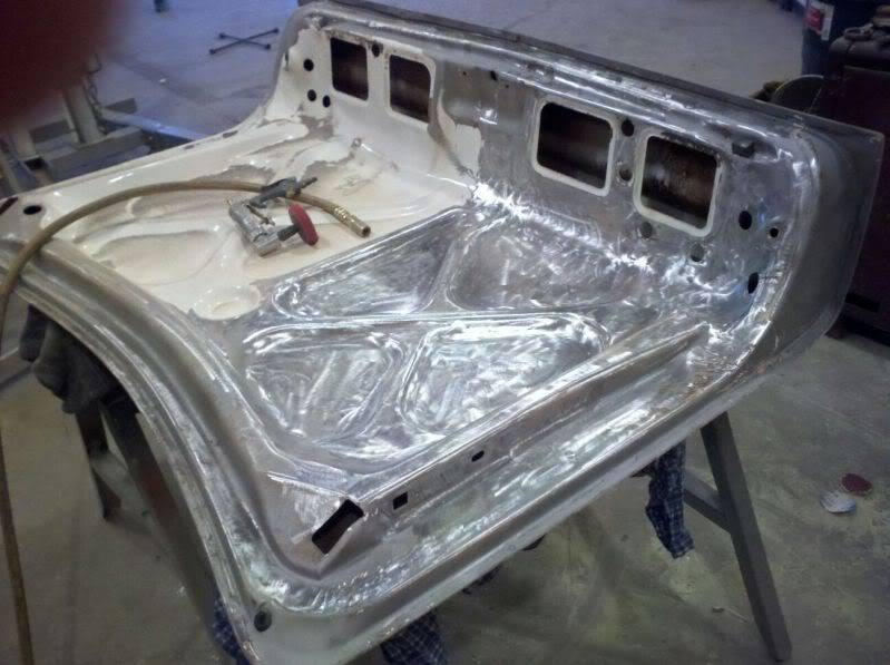

the bottom side of the trunk lid is gett'n some attention too, white b gone.
Havent looked at your progress in a while, damn your gettin' **** done! Looks great, keep up the great work.
Trunk lid stripped to bare metal and primed.
Doors all fixed up and primed.

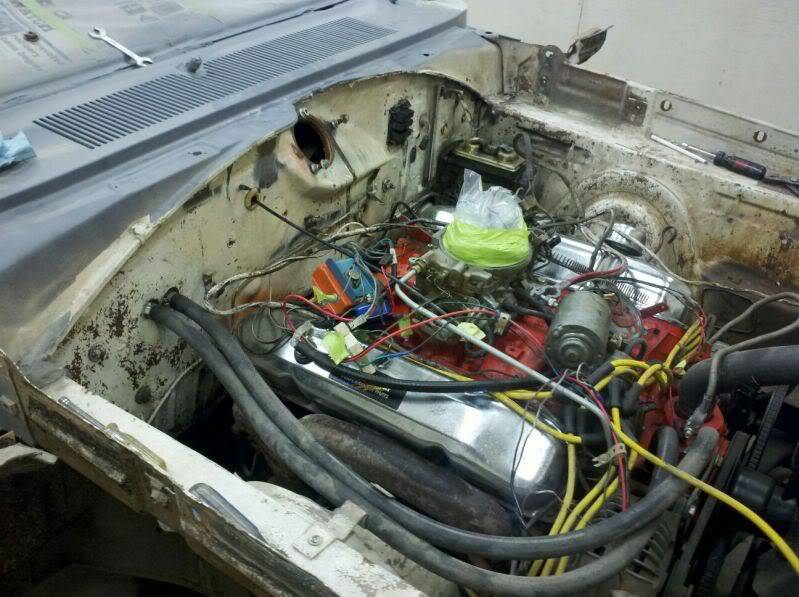

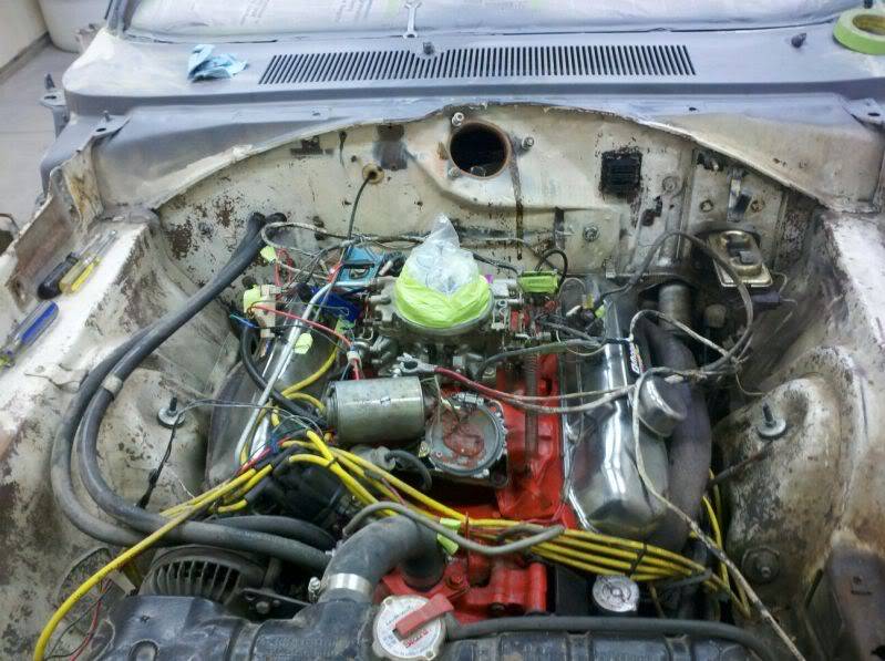

And I got a good start on pulling everything off the firewall, labeling, cleaning/degreasing etc.

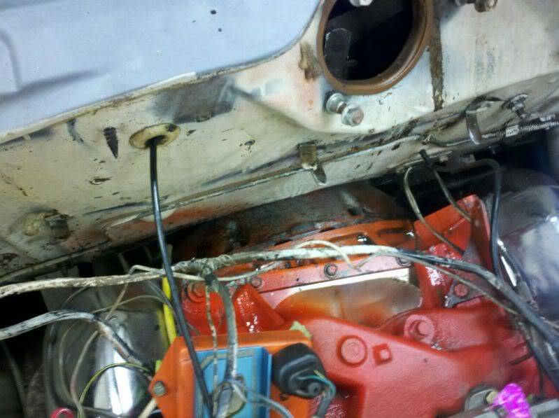

I'll keep going on the engine bay by dropping the coolant, pulling the exhaust manifolds for cleaning/painting. I also need to remove the dampner shaft from the RH manifold that was originally for the heat riser. I'll remove the shaft and plug the shaft holes.
I'll be able to pull the heater hoses from the firewall once the coolant is gone and I'll pull the radiator at that time too.
With the exhaust manifolds off I'll have better access to the inner fenders and for cleaning stuff like the steering sector.
We'll get the firewall and inner fenders sanded down and primed soon.
Meanwhile I'll be able to hang the doors back on the car and adjust them. Then I can start shooting some color. I'd like to do the insides of the doors and jams, engine bay and bottoms of hood and trunk lid all at once.
