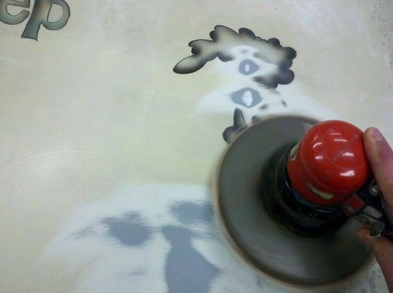

Tonight, the bird from 1976 went away.
scrub
a dub
dub
Not sad.
:grin:
Can't say I didn't shed a tear for the bird on the hood. But I know you kept one of the rear quarters and that scene was cool as he!!.
Yes I did, the murals on the sides of the car were a different quality than this hood bird. I honestly think the hood bird was thrown on there real quick and sloppy to draw the eye away from the wavy hood..
:edgy:
You can see two faces where the bird was from the sanding, hmmmm I think one is Jesus............CALL THE VATICAN!!!!!!!!!!

Can't say I did it on purpose and can't say I saw anything while I was sanding either lol!

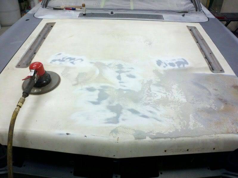

It's bare metal now!
I worked the chit out of that C-Aire compressor last night. The 8" viking mud hog sander eats air like crazy and I didn't give it a break. So glad to have that crappy old paint off that hood, it's the last of that old white paint job and I'm telling you, that crap was some terrible paper loading junk. And the gray primer it had under the white... same, terrible paper loading junk.
I worked the heck out of that new compressor and it was really up to the task, big difference from the old one it replaced and way less noise.
I ordered some more epoxy primer last night for that hood because I'm fresh out. While I'm waiting for it to get here I can get on them front fenders, they need some skim coat. Then i can re-shoot the poly prime full length of car and I should be able to block the body out from the front edge of the doors and back without breaking through to bare metal. The fenders and hood will need a follow up I imagine, maybe not tho.
Then the roof can be painted with a single stage white urethane which I already have, which will be masked off during the sealer/base/clear shoot on the rest of the car.
