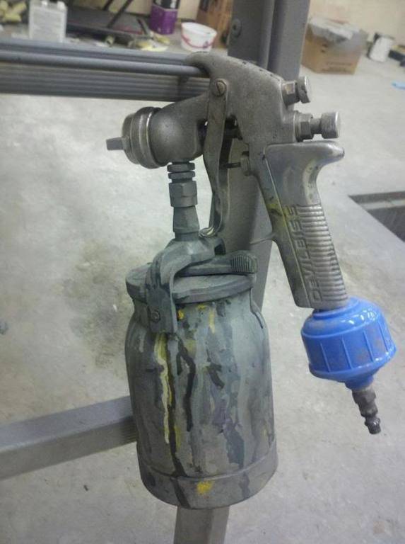

One of my oldest guns, serving some epoxy duty today.

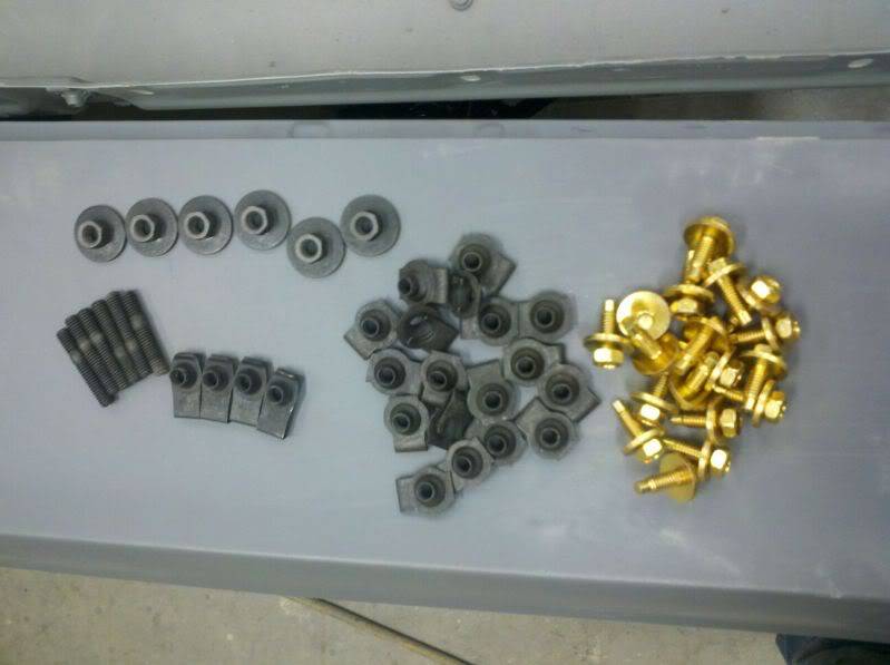

This fender hardware kit... do the long clips go at the bottoms of the fenders ahead of the doors? Ahead of the rockers?

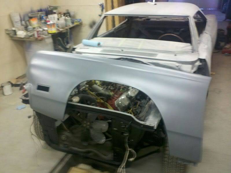

It's fender day!! Woooo! I'm so happy to have fenders hanging on my old plymouth again! Now I just have to get to town and pick up a handful of fender washers to shim up the top rear fender areas where the fender joins the cowl.

Spent the rest of the evening setting door, fender, hood gaps.
Then did some shop clean up and started planning the paint sequence. I think I will paint it with the doors, hood and trunk lid off.

Guessing you already know this but make sure you paint the doors upright how they hang on the car.One of my pet peives is looking at a different shade on the doors.
yeah we were eyeing the doors for hand points so we could hang em the same way they go on the car.
Even still I'm nervous about painting them off the car beings it's metallic.
