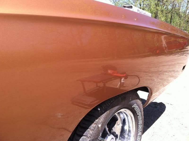

Fender not sanded and buffed, from the door back has ben wet sanded and buffed but I still have to hit it with the final polish. You can see the orange peel in the clear on the fender that hasn't been cut/buffed yet.
Wow Dave, all that sanding and some sore muscles sure is showing the the great job you've done alright! You have a lot to be proud about on this facelift..
I'm just not getting that shine to pop, I need to pick up a new foam pad and some finishing compound for the buffer tomorrow.

Did you wet sand the paint before buffing?
Yes, mostly 2000, tinkering with 1500 as it cuts faster of course but not sure if is fine enough to buff out. Again this is my first experience with this clear so I'm learning as I go.

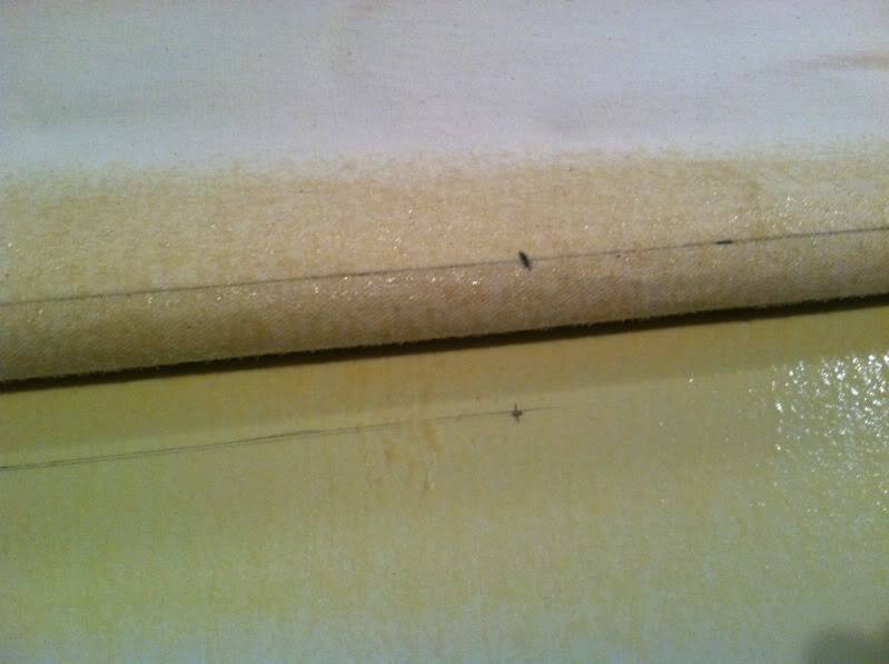

center line of roof and center line of top marked with pencil.
My method, glue and luck.
a narrow strip sprayed down both center lines to place the top correctly and start working outwards. The 2 little cross marks come together to locate front to back, the long line is for side to side.

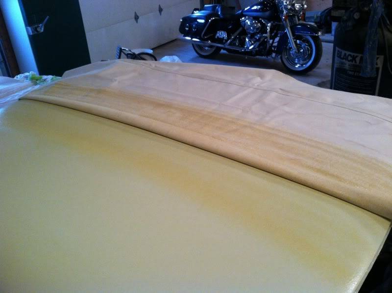

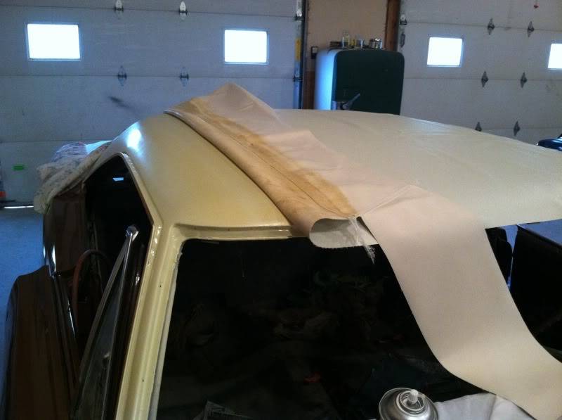

center line is glued, I worked my way out towards a drip rail about 8" at a time. A band of glue on the roof and on the vinyl.
Another band
getting somewhere.

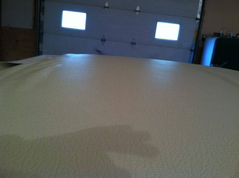

Now I'm out to a seam.
I dreaded this part but it went well.

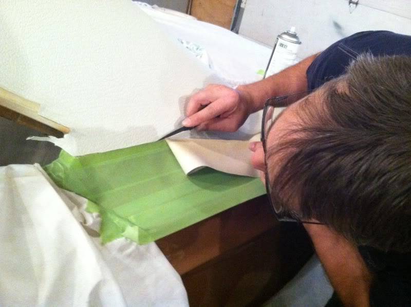

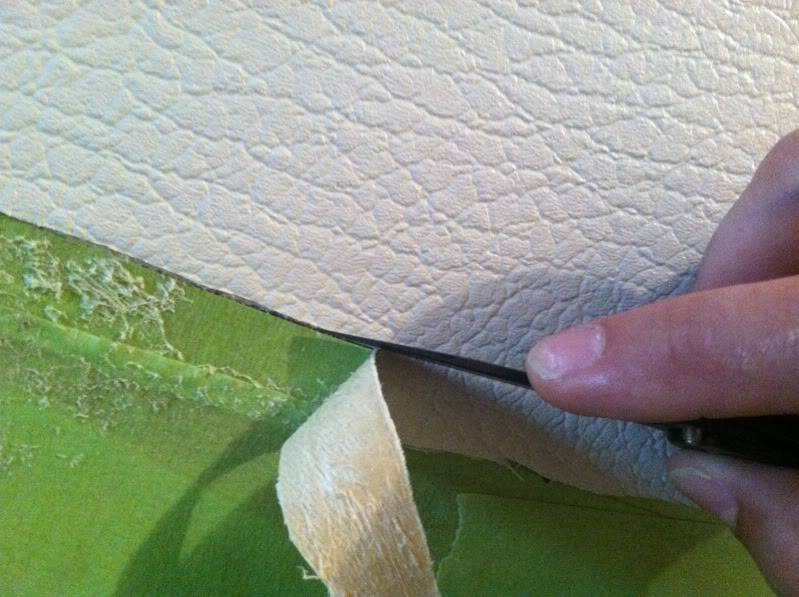

Trimming along my tape line, lifting the vinyl up to the knife, not making contact with the paint at any time.

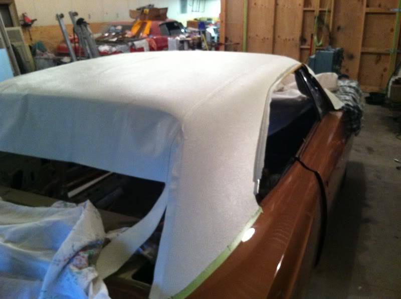

flip the loose material over the top of the glued material and begin the other side.

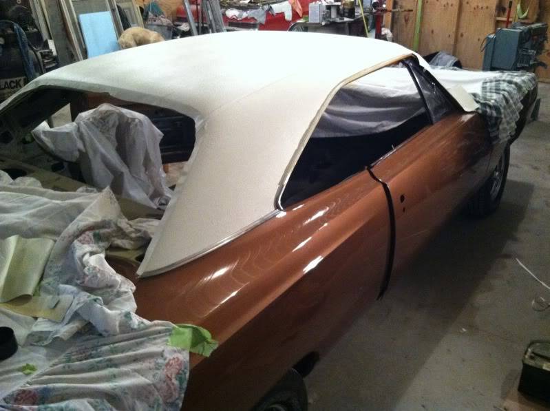

Had to test fit some trim while waiting for glue to tack up.
Trimming driver's side.
I wouldn't say it was a super hard thing to do, it just takes some time. It came out really nice. I just have to glue down my material where it tucks into the front and back glass areas and the top will be done.
