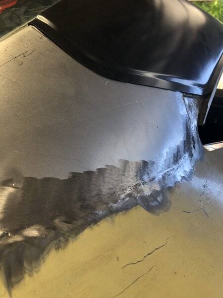

Ron, I'm having the same issue on my floor pan ... keep blowing through the new pan cuz it's so thin. I turned my heat and speed way down and it seemed to help. Using a piece of copper is a good idea. PS ,,, I am jealous of your progress ... keep up the good work.
Hi Jim thanks, yeah the old metal apparently goes through some changes over time not to mention the formulation is different from todays metals. Its been really arduous to not make small holes large ones. Do you have a build thread?
I ran into the same problem on parts of the welding on my car also. Mostly areas that I had to grind on, so it got thinner, or spots where a little rust had thinned it. I got better at not burning thru by going on and off with the trigger on the mig, and lots of argon. I will sometimes pull the trigger half way which only lets argon out and cool the weld a tad then continue. I also put small pieces of sheet metal behind the welds in some thin/problem spots also, especially if it was where no one would ever see.
Jim, I thought you were going to drop your 64 off in Yuma so I could work on her? :)
On sheetmetal, even filling rosette welds, I would be on-off....on-off, nothing continuous on the mig gun to keep the heat down. I practiced by filling 5/16" holes, no backing. Half moon weld repeated until the hole was filled. I was using a Lincoln 135sp with 80/20 gas and .025 wire.
Clean metal is the key. Old metal needs to be 100% rust free or it dissolves.

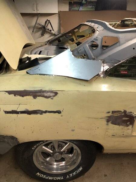

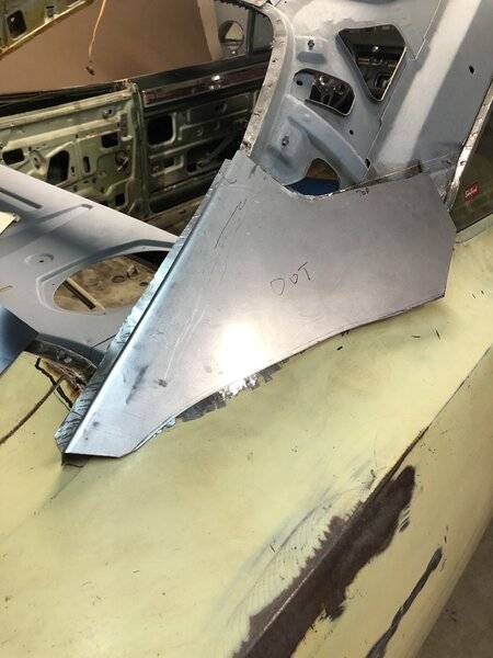

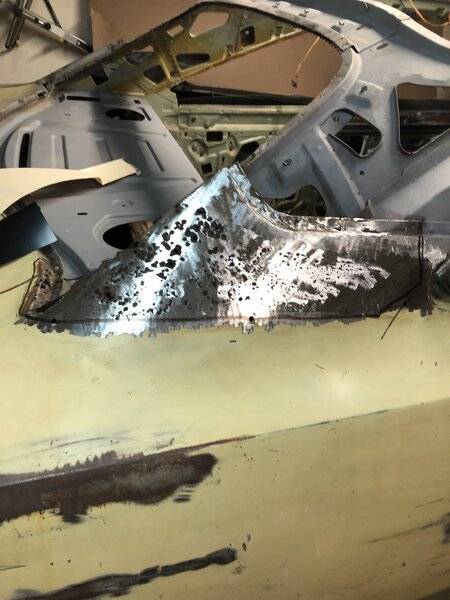

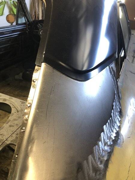

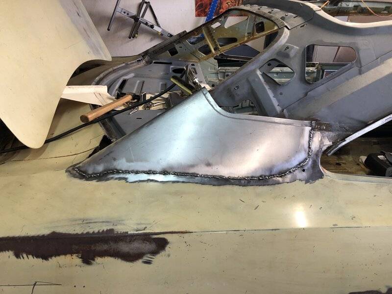

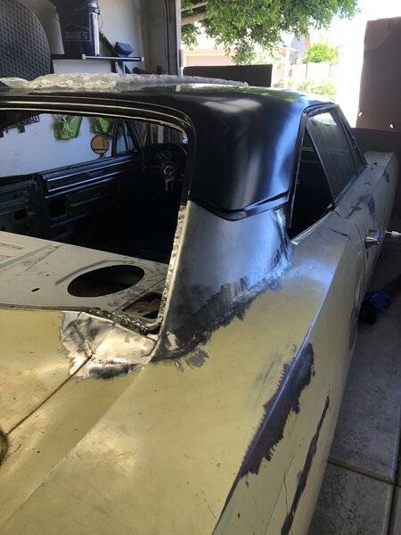

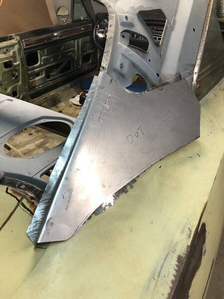

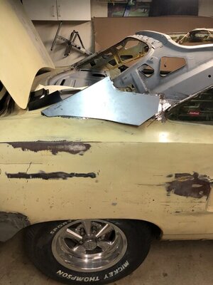

Starting work on the passenger sail panel.
293F462B-6A94-4E54-AF28-C4E62173452A.jpeg 2C497981-5C15-4478-938E-EE29F2DD2AC3.jpeg 9A916E89-7856-4031-95F5-3DB8E08371DB.jpeg 4C9352FF-05B5-4CF1-B4EF-4EEC76CEF2CB.jpeg 81ECC58A-77EF-4476-8036-D50CF3410658.jpeg

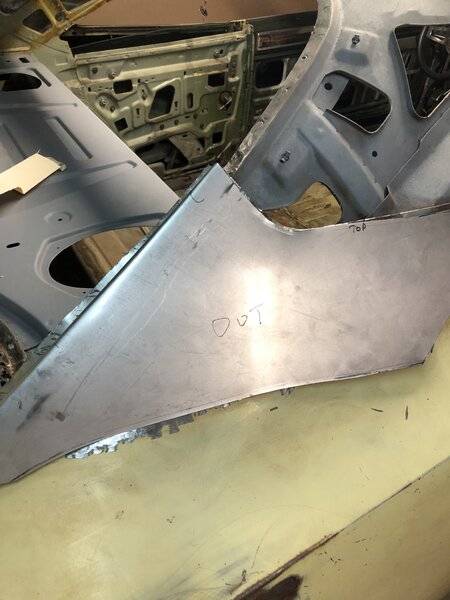

I need a brake shear. I am using a scoring technique and straight edge and a hammer to bend this stuff. Challenging to say the least but gratifying as it takes shape.
How do you eat an elephant, one bite at a time. Keep digging my friend! If it was easy everyone would be doing it. Starting to take shape and I like what you are doing. To keep from blowing thru, angle the tip at a 60 or even 45 degrees instead of 90. I have had good luck with this method, especially where I have ground the metal a little too thin.
Haha thanks Builderguy! I’ll try to angle the tip when I get to that point.

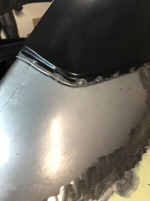

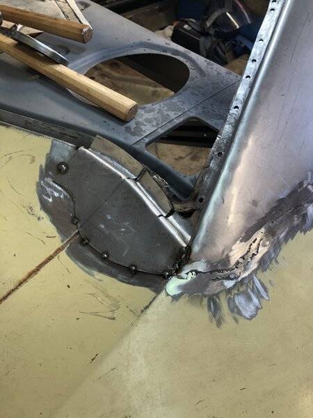

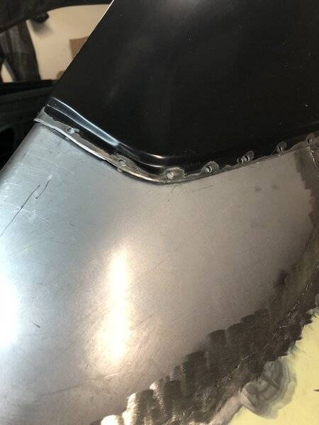

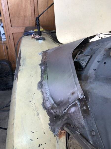

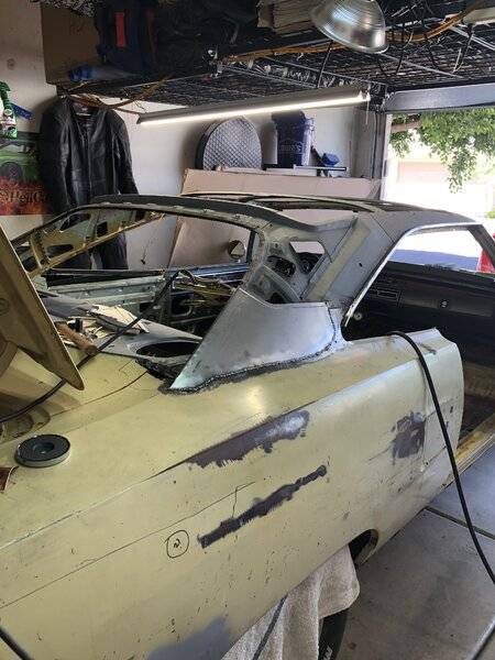

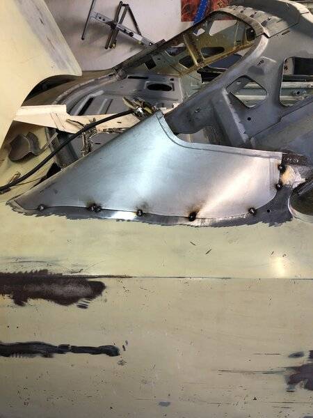

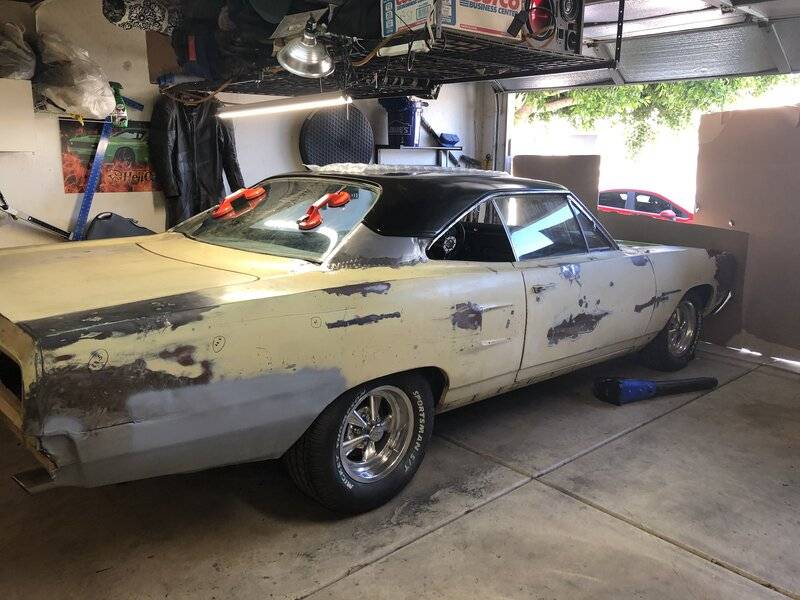

Getting knee deep into this complex repair. I will test fit the window tomorrow hopefully all will be good. I really haven’t done much of this type of work before and am using simple hand tools so be nice guys. Also low current welding on old metal requires a lot of patience and technique that I an learning as I go.
57B0AB1C-38FC-4A51-94A6-BCAD75F49227.jpeg D6F0DFBA-2A93-4A65-B651-9B5245A4423D.jpeg 613DDECD-9E20-4AD3-BDBA-61D4CC61585B.jpeg B170EA5A-0703-4A9B-A9B5-9F29DE5042EB.jpeg 4030A618-E053-454A-B71C-B62A08B1A11F.jpeg
View attachment 950801 View attachment 950802 View attachment 950803 View attachment 950804 View attachment 950805
Nice work Ron! I am impressed that you are doing this yourself.....keep on keepin' on! (remember that one?)
Thanks Bart. I am enjoying doing the work. The trunk pan is going to be a big job. Lots of spot welds in a confined space lol.

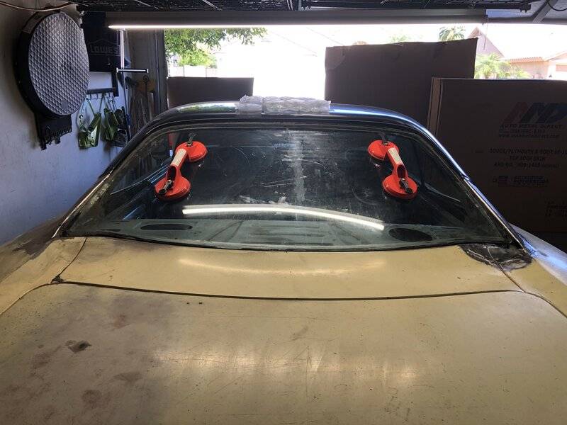

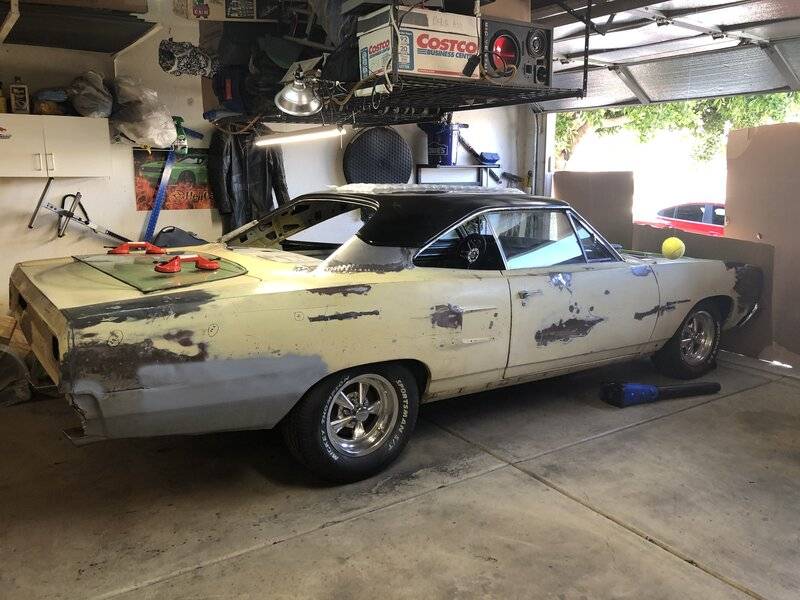

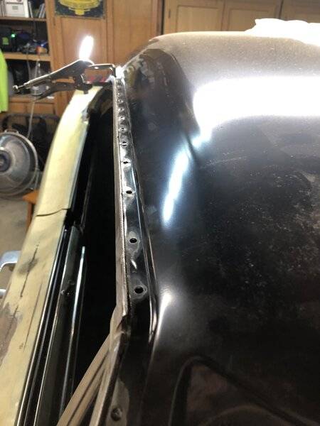

Test fitment of the roof is excellent. Rear windshield is good.
FE61A022-6F69-4687-A762-116AB58E76C0.jpeg CDF1BC1E-96BA-43D8-9A6B-22EE07B2A89A.jpeg 942D1B50-2830-46CF-B80A-75CDC61FE696.jpeg F9D13495-20C0-4B68-9015-8C17AA30C17D.jpeg FFC1E50D-C629-4533-B696-B8AA4A47A48F.jpeg 80D77DC4-2AD6-4158-A442-E4AD361BF8B0.jpeg 21F695E7-6D6D-47FF-AF17-420025D238B6.jpeg
Great work!!!! Leaves you with a case of the "warm fuzzies" doesn't it?

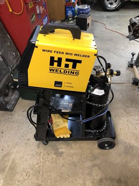

Yuppers it feels good. Lots more work ahead! I am going through Ar mix pretty fast with my little 55cft cylinder lol

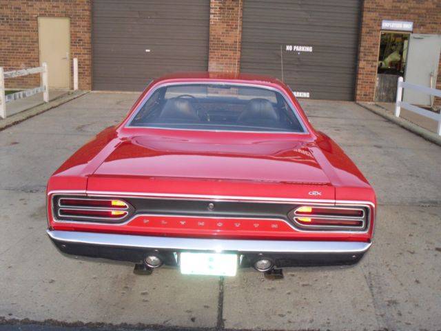

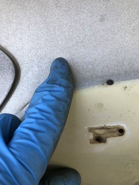

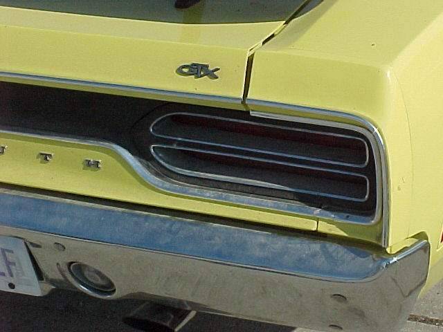

Wondering about this finish. Its a grit type that I believe was unique to the Sport Satellite and the GTX? Was it always silver for both cars regardless of the exterior color?
Replying to an old question... I've had a Sport Satellite, and have two sets of SS tail light assemblies and they have that textured argent paint. But every GTX I've seen for the same year had black trim in that area.

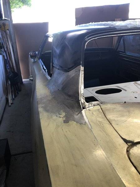

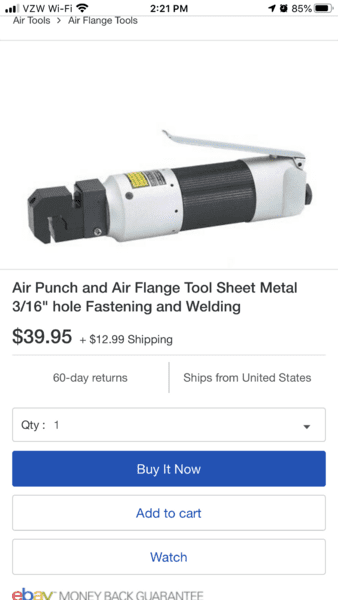

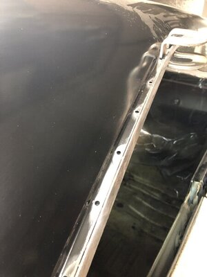

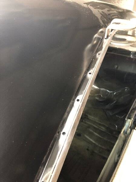

Skin needed some trim to fit in the channel without binding. Took off 3/16 along the edge so it fits flush without binding. Punched all the spot weld holes using the below punch from HF. Beware that this punch needs cutting oil in the side screw hole in oder to work effectively.
Also cleared the paint around the holes for best weld results if I need to drift out of the hole. This probably is not necessary but I thought it would be good to do as my wife said “you didn’t want a convertible did you?”

Looking really good Ron! You are really moving on this project quickly!!!
Coming along nicely. Sure looks like this isn't your first rodeo. Thankfully I have never had to replace a roof skin, and don't care to. You are making it look easy.
