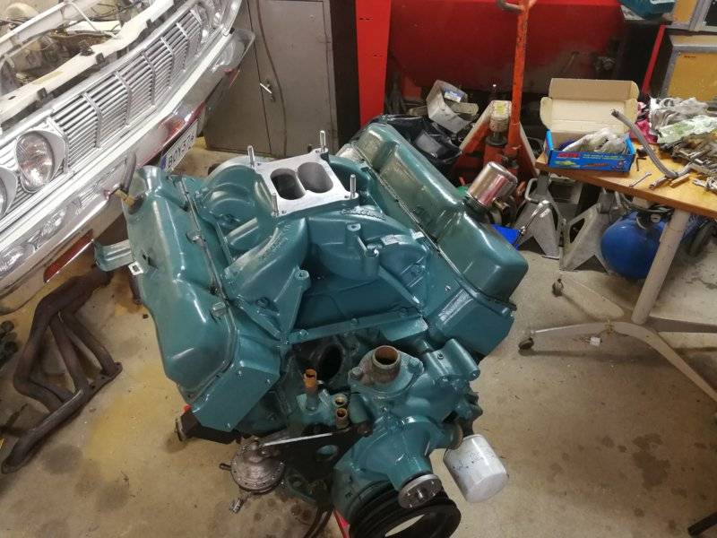

Already been driving around with the setup described earlier a couple of years, managed 12.67sec at the quarter with a little nitrous.
Had to run with the ported 452 heads and stock low comp pistons cause of house renovation.
So, this new setup will be around 10.3 comp (8.0 comp old setup) and better flowing heads and the benefit of lesser weight. I beleve the new setup will give me around 100hp or so over the old, and low 12s without nitrous.

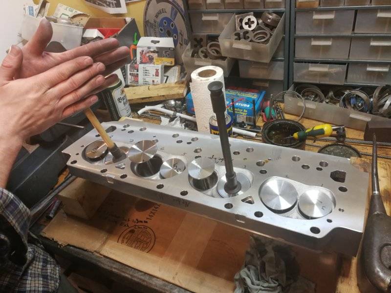

Have cleaned up the ports a little and done a valve back cut and laped them.
Not a single valve where sealing properly ootb.

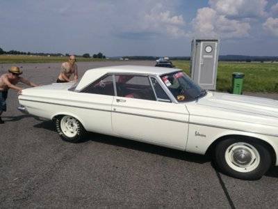

12.4769sec 106mph
60ft 1.738
New personal best
The engine feels slow after 5000rpm?
Budget 440
L2355f stock bore pistons
Edelbrock E-street heads
Headman 1 3/4 headers
3" exhaust with mufflers that necks down to 2 1/4" inside
Edelbrock rpm dual plane intake
Quickfuel 850 dp with electric choke
Comp cam hydraulic 284h cam
10.1 comp
8 3/4 with 3.73 gears
Tf727 manual revers pattern
Hughes 3000 stall converter
Ss springs
10/90 front shocks
26" x 9" hoosier slicks
Shifts at 5000-5500 rpm
This was in 85-95 degrees heat
Full steel car with bench seat
Do you have any suggestions on how to make this combo any faster? (with out nitrous )
