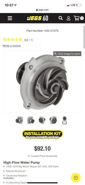

This is the water pump I have from Jegs. Wondering if I should upgrade to a Flowkooler brand with fins?
the jegs should work fine that impeller is better than fins

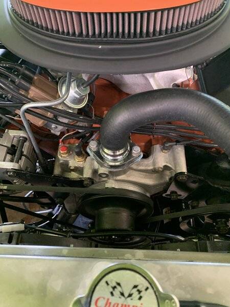

@Sonny what water pump housing do you have? Some of the early aluminium aftermarket housings had a flow problem. I'd have to research this again to refresh my memory.

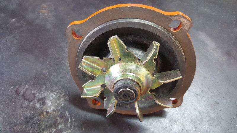

When researching pumps (and I am using a stock housing) I found that the eight blade for AC was the best and that's what I used. There used to be a UTube vid on what pumps worked the best and the eight blade came out on top.

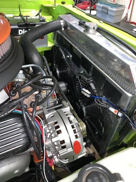

You can have your radiator cap off and watch for the t-stat to open when you first start the car cold. There will be coolant flowing across the tubes from one side to the other when it opens. Give it some throttle and it should increase to a really good flow.
The other thing that was already mentioned is the electric fans causing turbulence at highway speeds and actually blocking airflow. I've read this before.

Nice looking 8 blade pump. Where did you find that one?
It’s from 440 source but the site listed these as new and retooled since previous housings had a smaller intake orifice.

tin pumps work much better with a plate
less cativation
take less hp
will rev higher before cavitation

Update. Since my last post I’ve:
Added overflow tank.
Added EMP thermostat.
Added flowkooler pump.
Added lower Radiator hose internal spring.
Added 14 1” holes with flappers to shroud.
Tried water wetter with distilled water.
Used foam to seal radiator to rad support.
And nothing. Maybe 2 degree drop on highway. Idle to 25 mph- 195 degrees
Over that on hwy at 70mph- 208. Only 84 degrees outside.
Possible causes?:
-My (2) 1320 cfm fans too small (12” pullers with 95amp alternator). Temp does come down from 210 to 195 but only when at idle so the fans are working better than high speed air flow.
- my 727 trans has a 2000 stall converter with 3:55 gears. Engine rpm is 3200 at 70 mph. Should I have a trans cooler?
-air fuel ratio is 13 at cruise so not lean.
-timing is 18-34 so not too advanced.
-using ported vacuum advance. Timing is 44 degrees in park at 3000 rpm when hooked up.
Any suggestions???
