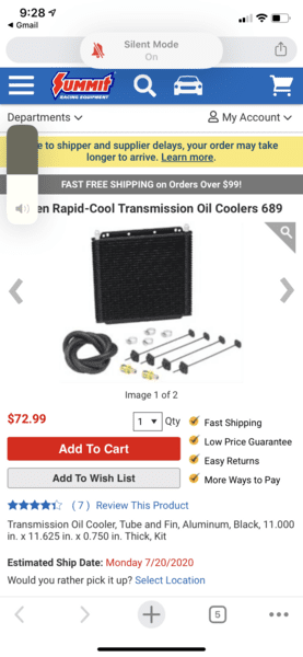

what cooler did you get
got a pic

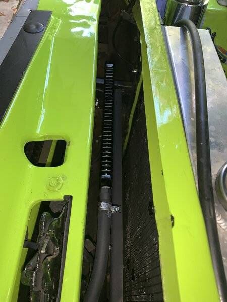

I bought this cheaper tube and fin to see if it improves my cooling. If my cooling comes down, I will switch to a plate type cooler. I made a bracket and mounted it 3” in front of the radiator.
you need to either put it against your radiator or duct it or air goes around not through
what size fittings
should work if you are not towing
let us know if it works to reduce rad temp
what size fittings
Its actually 2.5” from radiator at the top and 1.5” at the bottom. I’ll put the plate cooler closer. Using factory steel 5/16” lines with -6an fittings and 11/32” hose.
