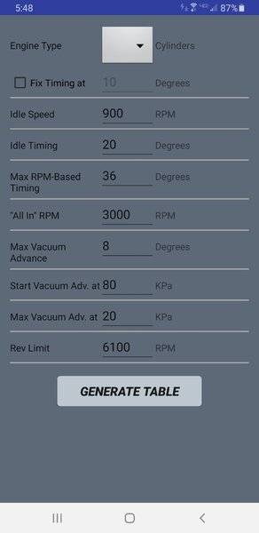

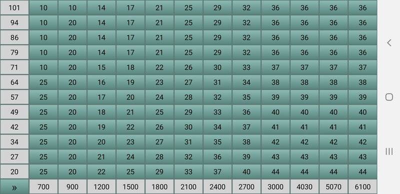

Just drove it... it definitely needs more initial back in it. Starts well, idles great, and if you treat the pedal nicely it drives fine... but pushing it from a stop or flooring it while cruising both result in a noticeable bog that wasn’t there before I dialed it back. But at a steady cruise, the motor is running smoother, less surge and jumpiness.
This is all with it hooked to ported vacuum. May switch to manifold without changing timing at see what it does.
Oh, and the upper rpm range while pushing it seems maybe a bit stronger, less noisy.
Is it perhaps a case of “had good initial before but too much total”, and indicates that I need to raise initial back and limit the total?

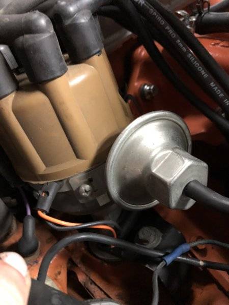

And if I wanted to change the amount of vacuum advance delivered, it’s as simply as turning the whole vacuum can? Or is it an internal change/adjustment?
