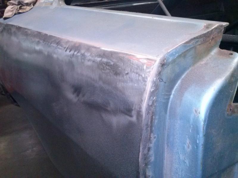

All done with the skin, other than a lot of grinding. Those darn lower corner pieces are tuff to get even close to right.
This seams like a big step to me., Kind of a relief to be done with most all panel welding work, other than the rear window. I will have to research the window repair and figure out what parts I can find for it. It will be a couple of weeks before I can get the rotis., then major blasting, clean up and prep for epoxy primer. The rest of the body- doors, frnt fenders, hood and trunk lid are in good shape so they should go easy, but will do those nearer to finishing, after refurbishing and reassembling most everything else.
Nice job, looks great... are we having fun yet.... keep up all the great work
Advisory> Those are made of cast aluminum I believe--- careful refurbing them.
Yes sir, I just did mine. I filed a little and then used All Metal to build the corners up, not something you want to do to much tweaking on. Cast aluminum-pot metal? Whatever it is isn't very workable.

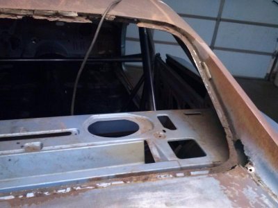

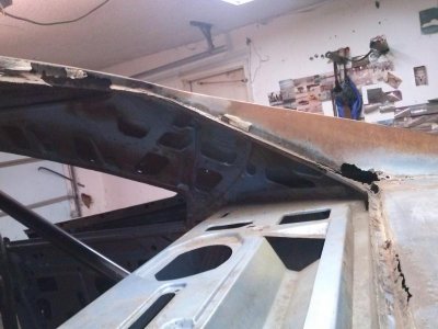

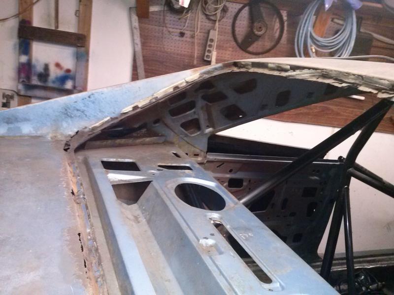

I need some help here guys. I want to order the patch/repair parts I need for the rear window frame. I am having trouble finding what I need and not sure what all I need. Any links or info will help. Here's what I have to fix >

this is the lower inner frame
https://www.autometaldirect.com/sto...55&desc=68-70-Charger-Lower-Rear-Window-Frame
i am searching it may take awhile
i would also replace the dutchman panel
https://www.autometaldirect.com/ind...selectedmodel=Charger&redirect=0&prod_cat=650
you can find better prices for amd,this was just for reference #s
everything else i had to fabricate
https://www.autometaldirect.com/ind...selectedmodel=Charger&redirect=0&prod_cat=610
the last one is the inner upper roof bow
IMHO dont buy the sail panel patch,they are a joke,,,better to just make the patches & weld them in.
I am assuming these do not fit chargers>
https://www.yearone.com/Product/1966-74-a-b-e-body/dfp68lh
I believe that is the same piece that other suppliers state- except charger. And that curve is no where on my window area.
Yea daytona that is the rear window corner for B bodies except charger. You're at the same point I'm at with my build. It looks like I'm going to have to fab up the rear window channel of find a doner vehicle with a good back window. Other than that it looks like you would have to but the entire roof for the pieces you want. I am still looking to see if anyone makes what I need.

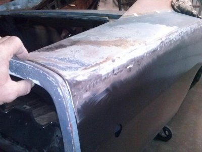

Finished most of the grinding on the 1/4.
