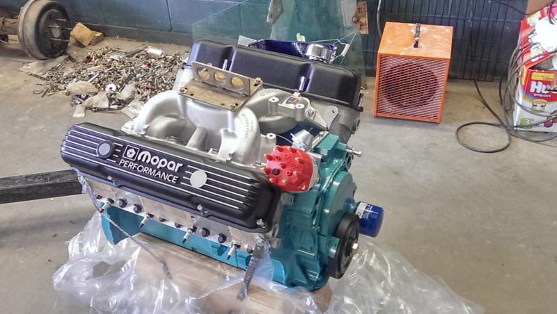

512 build for 68 charger
500 inch motor- check. Cool 60's mopar B body - check. 11 second et potential - check, doing it with the AC blowin, just bad ***!!

Taking notes! What color paint are you going with on the block? I'm thinking about painting mine to look like it's aluminum or at least the same color.
KID,, I Think it's gonna be the turquoise, but i thought about the same as you

I went back and forth on the Orange and Turquoise with my block and got it shipped in Turquoise with a few cans of Orange in case I wanted to change the color... Once I saw it in turquoise I was plenty happy :)
