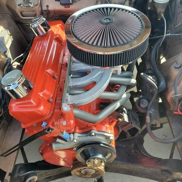

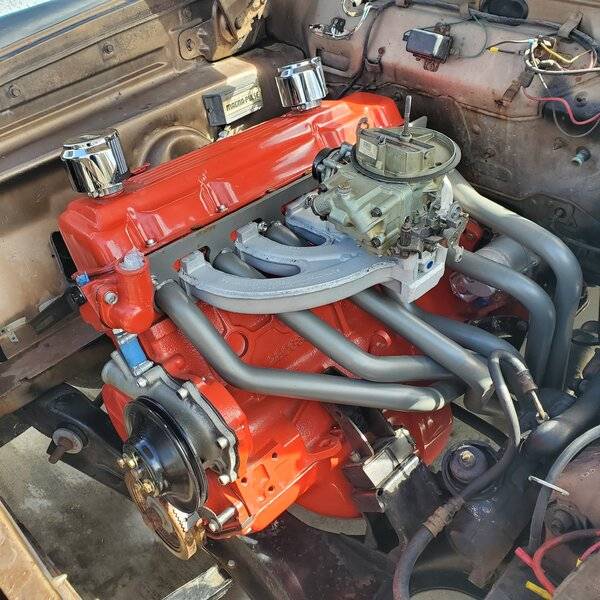

@Scott Kiger I particularly like the idea of the passenger seat.
I drive a 1963 Savoy with a 225 slant 6 3 on the tree as my daily. It runs very well. The car is in my avatar.I have everything to put a built Slant in my 63. Right now it's a 70 318. But if the teen goes south, A Slanter it will be !
Life time fan of the Slant !

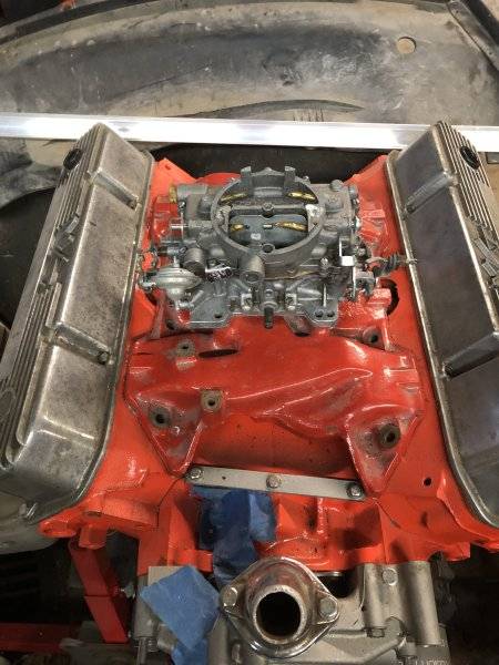

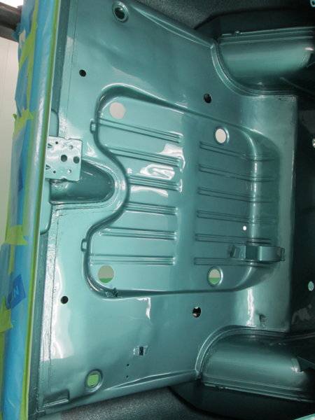

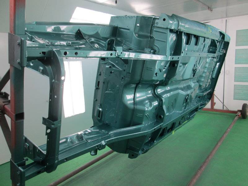

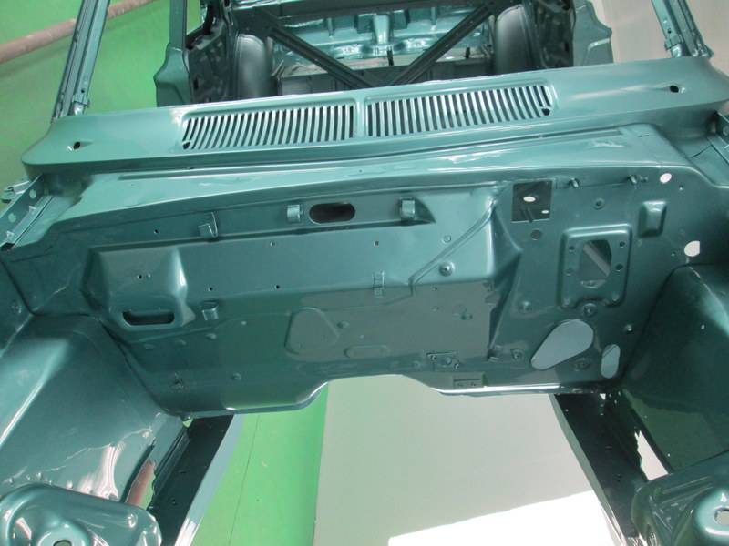

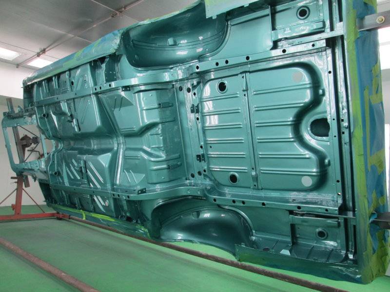

I like your sub frame connectors. 2X3 tubing through the floor? Outstanding workmanship.Well, just passed the 3 year mark on the "re-do" of my '63 330. I've got a bunch of sub-assemblies done, waiting on the engine build, next in line, and the bottom of the car has been painted. Trying to get the ducks in a row, so the assembly will go smooth as it can. Maybe top paint for Xmas, and driving late Summer, early Fall...View attachment 677327 View attachment 677328 View attachment 677329 View attachment 677330

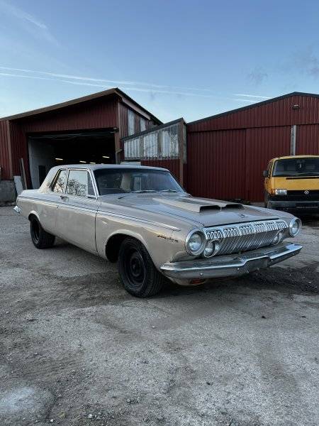

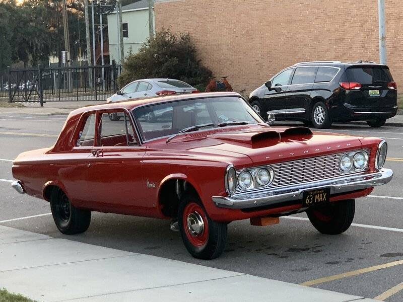

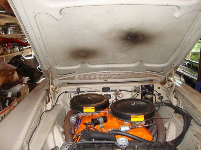

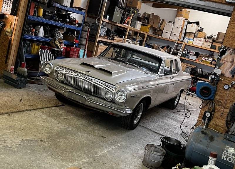

Here is my 63 bought it last year from a good Friend in Germany!
426 MaxWedge with 4 on the Floor ;)
Now i‘m looking for some Cheaters and skinnies on Steelies! What fits on 15x8 4BS ?
I have 255/70x15 on 15x8 4"bs wheels for my 62. I wanted 275, but they would have rubbed.Depending on how wide the tire is 15x8 4 BS can cut it close to rubbing the outer wheel house.
Usually one side more than the other. No 2 Mopars are the same as far as tolerances.
On my early B's I would use factory 15x7 4 1/4 BS with no problem.My 63 has drag radials 275/60/15 with plenty of room.
The frame ties are US Cartool, weld in. I don't think you'll find any seat covers for a '63 Dodge. Legendary makes some for Plymouth, but No Dodge. I've asked them every time I seen them at Carlisle, about this. You can get original material from SMS, and find a local shop to stitch em up for you. That's what I ended up doing...I like your sub frame connectors. 2X3 tubing through the floor? Outstanding workmanship.

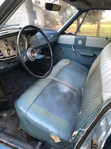

What about interior? I am having a really difficult time finding seat covers for my '63 Polara convertible. Bench seat center armrest.

Thank you. I just sent them a message.The frame ties are US Cartool, weld in. I don't think you'll find any seat covers for a '63 Dodge. Legendary makes some for Plymouth, but No Dodge. I've asked them every time I seen them at Carlisle, about this. You can get original material from SMS, and find a local shop to stitch em up for you. That's what I ended up doing...
