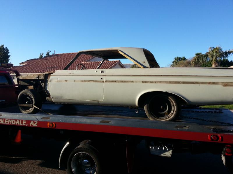

She's off to the surgeon
Is your floor in need of full replacement? Can you maybe get away with the separate left and right sections? Your cowl will take a fair bit of work. The replacement patch for the left top cowl looks like a simple replacement but they take a lot of fitting. Very nice Polara and what a great project to spend time on.

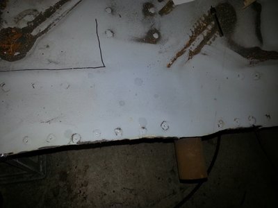

SOOOOOOOOO .... learned yet another valuable life lesson. When you have someone else do floor pan work for you make sure you examine it closely ... but noooooooo I was in a hurry that day. When I got it home and looked at it I wasn't happy with his work ... so I had to order a new full pan from AMD and I have been tearing out the old one when I discovered this CRAP!
Driver side spot welds on cross member are there. Not a single one on the passenger side. Positive note ... it will come off easier.

It gets worse ... he ran a full bead the entire length of the firewall seam so now I get to cut that out and grind the entire seam edge.
Glad to see you have her back, not glad to see you paid for shoddy work. That is terrible. I wonder why they laid a full bead on the firewall flange?
Besides missing welds, what was wrong with his pan install?

Tech screws sill installed ... he did an overlap joint on the partial pan rather than a butt joint ... just really ugly and my OCD got the best of me too! I should have it out sometime tomorrow and then I can begin the cleanup and fitment of the new pan.

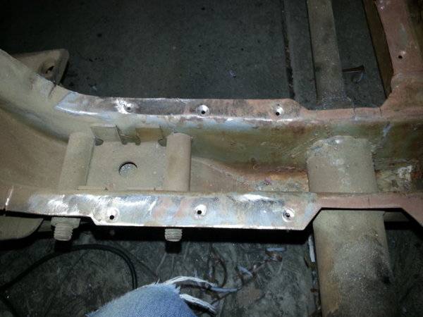

Drivers side ... at least there were proper welds on the patch panels ... but apparently they do not know what weld thru primer is for or when to use it.

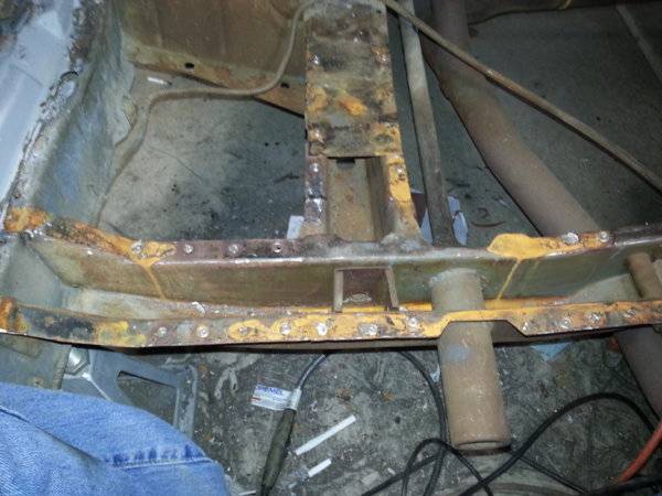

Passenger side ... evidence of the old welds being drilled out ... no primer (again) .. no welding to the cross member ... very disappointing.

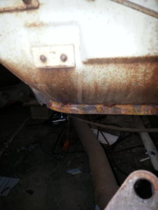

Fire wall welds ... previous welds were drilled out but never filled back in. This explains why the they ran a bead along the entire inside seam.
