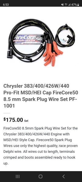

I read some post(s) about using the Pertronix module in a points distributor and decided to follow that path. I am suffering with confusion about the correct plug wires to use. Which ones would be best to use given the Pertronix ignition system.
Also, I have the cast iron HP manifolds but I’m uncertain as to the plug end on the wires. Should I use the straight plug boot, 90 degree or 45 degree boots or a mixture of all 3?
Any advise or recommendations will be greatly appreciated.
I’m making good progress on the Polara but with the AZ heat I’m getting about 2 - 3 hours a day until I can’t take the heat in the garage any longer.
I'm using Firecore wires with a HEI cap. Not cheap but dang are they good. I got the custom length set. Called and talked to the owner about how long and what ends I wanted. I used a mix of straight, 90, and 45 degree ends. I'm running headers, though.
Pretty much and post 72 wire set will work. Make sure you have the right ohm coil for the petronix. Pet I the stock coil is fine.
