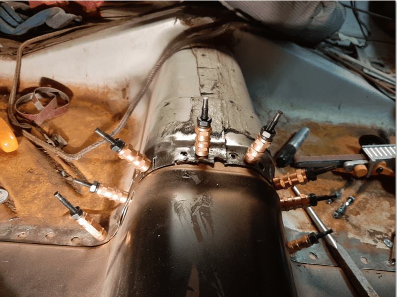

So ... its been awhile since I posted in this thread. I decided to take a day off and beat beat my floor panel tunnel into submission with a little help from some clecos. Now the welding can begin in earnest.

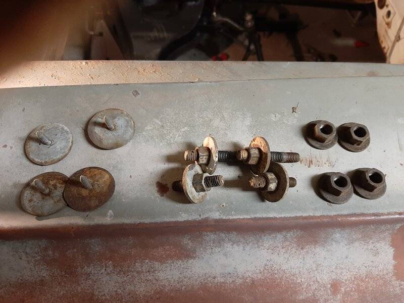

I got the front fenders bolted back on. In my bag labeled "fender hardware" was some hardware that I don't remember where it goes. I have a picture attached ... any help/guidance would be greatly appreciated.
The studs and nuts hold the bottom leg of the fender the large washer screws are for the dust shield rear of fender.

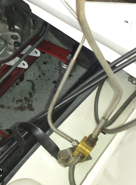

Apparently I've grown "mostly" forgetful since I retired. Does anyone have a picture of an installed front brake distribution block. I can't remember how it attaches to the frame rail.
This is a single line distribution block on my 62. Hope it helps or is similar.

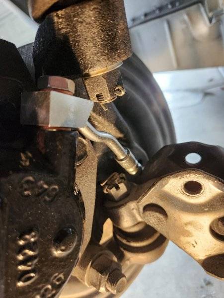

A long time ago I changed the front brakes from drum to disc using 74 A-body parts. Everything installed just fine. Today I decided to hook up the flexible brake lines to the caliper & brake lines and it's obviously not correct. No matter which way I attach the flexible hose to the caliper it's just wrong or I can't get the banjo bolt threaded. This is the only way I can get the banjo to thread but I know it's not right.
