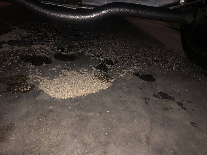

So anyway, when I put it up in the air to adjust the shifter rods, I saw that oil is seemingly coming from everywhere. There is oil on the passenger side of the pan which looks like it may be coming from the front somewhere, possibly the fuel pump block off of the lower corner of the timing cover. The underside of the driver's side front frame rail , t bar, starter and exhaust are completely wet with oil. Could be coming from the valve cover, dipstick... I can't tell, it's everywhere. Power steering is still leaking as well.

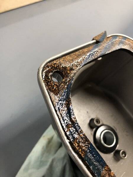

First order of business is to address the valve covers. I chose Moroso valve cover gaskets but I don't think they work well with stock cast heads. Second thing is that the ancient Edelbrock valve covers don't have a provision for a PCV. Can't say for sure whether there is too much crankcase pressure but I always prefer to run a PCV. Going to swap the old-school chrome finned ones out for these bad boys which are more modern (?) no-name M/T "Japanese Market" pieces. The M/T covers have a provision for a PCV. I have to alter some Mopar Performance baffles to be able to use them in these but it's only elongating one attachment hole. My boy Benny Beans hooked me up with some cork gaskets today so I should be back in business in a NY minute.
Second operation might be more involved - the oil pan and timing cover. Not sure how involved I want to get here. I gotta take the center link down after having just had the car aligned... Getting to the timing cover is a huge pain - accessories, harmonic balancer, water pump... then clean all the old schmutz off, and re-install while it''s all in the car. It's not hard but it is kind of of a sucky job especially since I just buttoned it all up like last week. I may just take down the oil pan, get rid of the crappy homemade-looking windage tray and go back to a single pan gasket.

First step to mitigating the oil leaks was to put a different set of valve covers on. These seem to have done the trick, no visible leaks for now. For whatever reason I have shied away from using cork gaskets in recent years but these were free so why not? I think the secret with the cork gaskets is basically to install them carefully. I used to some light adhesive to stick them to the valve cover rails. I put some weights on top of them overnight to ensure they were flat before putting them down. I was keenly aware of not over torquing them which I'm guessing is a common malpractice. Again, so far so good. These valve covers look cool too, I kinda like 'em better than the chrome ones that were on there before.
And again, the other reason I switched to these was because they have a provision for a PCV. It's not a race car so in my mind there is no reason not to use one. In theory it should help with leaks and thus far it seems like it's doing it's job. Didn't seem to have any effect on the EFI but if there was, it just learned a new tune. For kicks in style I stuck a regular old chrome Auto Zone breather on the other side. Shiny!

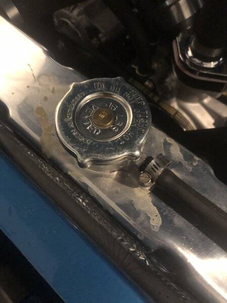

The other thing I learned yesterday was that what initially appeared to be an oil leak coming from the front was actually coolant. While looking things over yesterday, there was evidence of antifreeze on top of the t-stat housing. Broke out the coolant system tester and lo and behold, the thing is a leaker.
First thing I noticed was the hose clamp was a little loose. Doh! I tightened it up, tested again and it held but after the ride back and forth to work today, it was pissing coolant everywhere. Since the parts on the car look to be the 52-year old originals, I think it might be time for a new water pump and housing, or at least something that does not have a badly pitted T-stat surface.
So yeah, I'm guessing my 'oil leak' was most likely coolant mixed with road grime and possibly some power steering fluid. Makes sense since it was dripping down the front. The rushing air and fan would spray the coolant backwards onto the motor.

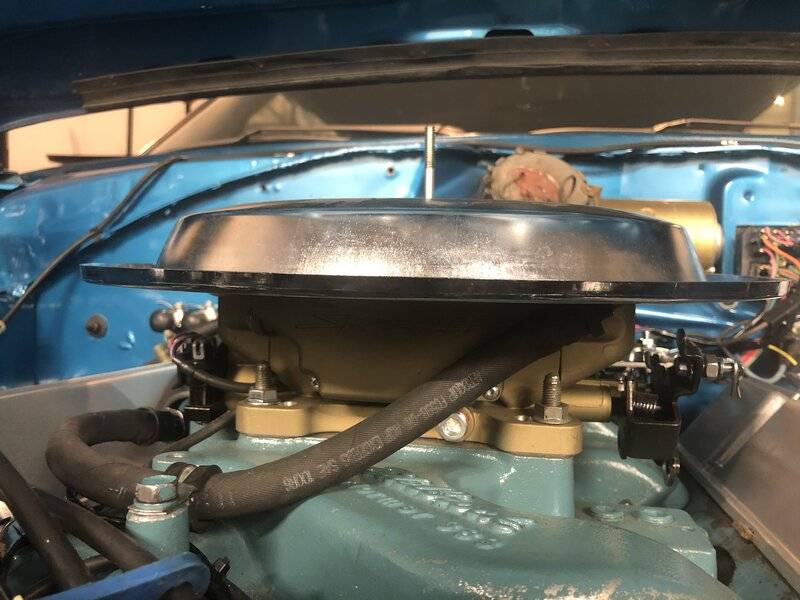

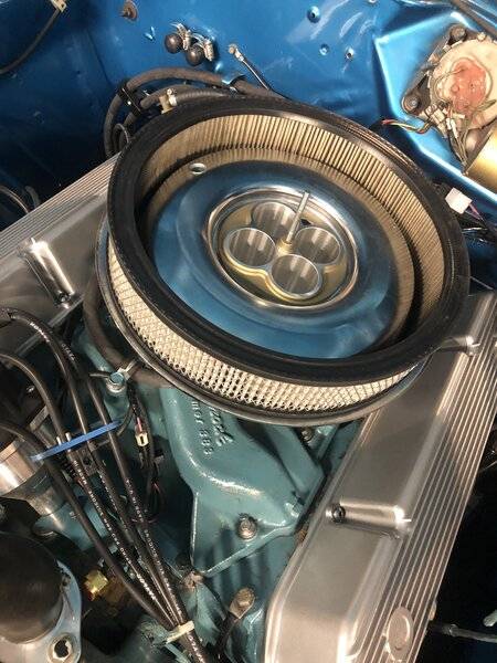

Does the stock air cleaner fit the Holley Sniper okay? Any issues
Yes, the throttle body is the same as any Holley-style carb.
I do have a slightly dropped base so a regular one should fit easily.
Because of the slight drop in the base I am using, the 90º inlet fitting in the driver's side front port is real close to the inside edge of it but it clears.

For those keeping score at home, the all-encompassing fluid leak battle continues. After driving it the other day the coolant leak seems to have been reduced to a slow drip though it is still leaking. Had the thought that since the heater hoses were not hooked up, it may have been overfilled and since it's liquid and can't be compressed, the extra coolant that usually lives in the heater system had to go somewhere...

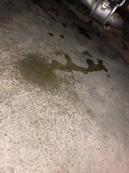

The other thing I noticed was that coolant seems to be weeping out from behind the header bolts, there were a few stains on the header flanges. I used Teflon paste on them when they were installed, not sure what that is all about.
However, a nice, big fat clue presented itself after a drive the other day. Once back home, I shut if off, popped the hood and could hear the coolant boiling in the heads. Personally, I have never encountered before, especially since it's fall and the ambient temps are nice and cool. Kinda makes me think there could be air in the system. The engine does seem hotter than you would expect, the upper radiator hose is almost too hot to touch. The temp gauge has been OK though, nothing out of the ordinary. It's a brand new aluminum radiator, 16 psi vented cap with an overflow tank so those parts must be doing an OK job. Guess I will have to re-do those header bolts which absolutely sucks, they are hard to reach.
Either way, I did wind up ordering a new water pump, new heater hoses, a new timing cover with gasket set and a molded windage tray type oil pan gasket.

The valve covers also still leak. Guess it's just the nature of the beast, Mopar valve covers have been leaking for centuries. Factory iron heads have such irregular valve cover rail surfaces, it's probably next to impossible to make anything seal. One can only do so much.

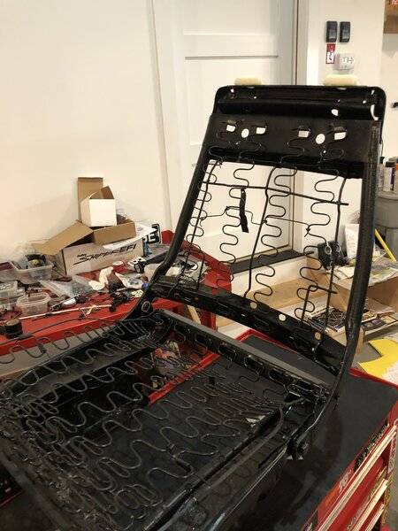

Last item to report is that the passenger side seat upholstery job has commenced. It will be nice to have a co-pilot seat because I can finally take my wife and kids for a ride. Just getting things underway now but have everything on hand already, should go smoothly.

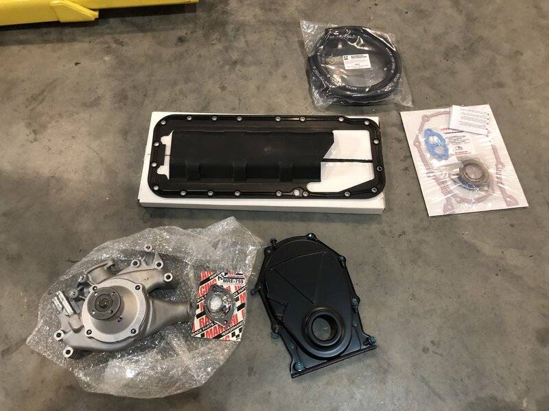

In other news, all the replacement parts are in.

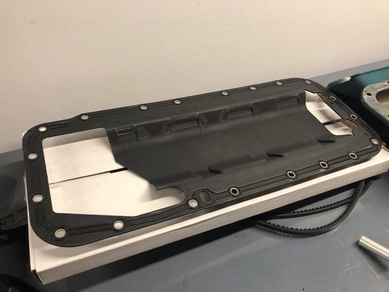

Frankly, getting the molded pan gasket installed kinda sucked. It's more rigid than the metal ones so there is less give when getting it close to where it needs to be. Coupled with the fact that my pickup tube seems like it's cemented in place and basically immovable putting it in exactly the wrong spot which made it difficult to get the bolt holes lined up. Maybe it was because I was doing the job at night, I dunno but I kept having to undo bolts at different ends to get it lined up. I did use carb studs (!) to help line it up, worked good. Next time the pan has to come off, I need to remember to use my pole jack to raise the motor a little so I can get a ratchet on those front bolts more easily.

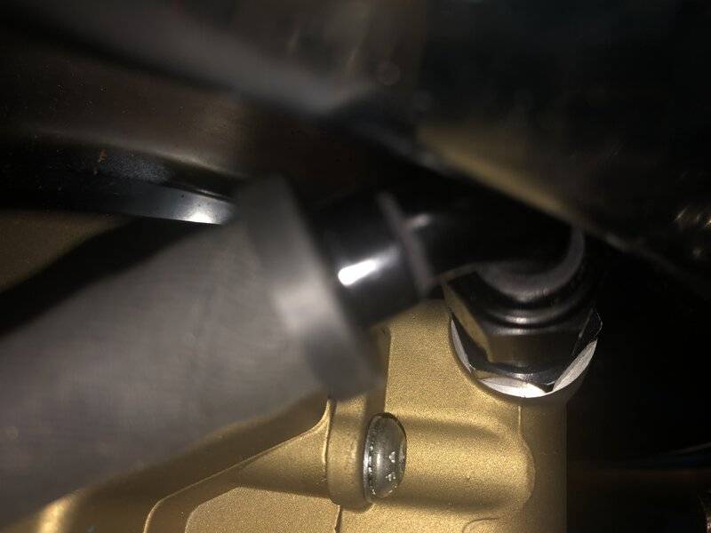

On the power steering leak, close inspection of the return hose adapter revealed the bead flare had a small dent/crease in it making the outside diameter oval shaped, pretty sure that was what was causing the leak because the fluid was getting past the flattened bead.
Went down to a hydraulic shop to see if they could make me a new hose. Unfortunately they didn't have the necessary materials but they gave me a compression fitting and adapters to try and make it work. Still leaks! Perhaps the red, old-style hose clamps that came with the hose are not strong enough? Did I mention I detest power steering fluid?

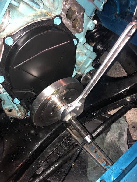

The timing cover, water pump and balancer went in fairly easily. No silicone 'sealing' goop was used on any of these parts, just good gaskets and proper fastener torque. I cleaned a ton of old RTV off all the mating surfaces, the P.O. must have had stock in Permatex or something.
Having the right balancer installer tool makes life easy.

The valve covers still seem to be weeping a little but they are better. I changed out some studs on the corners for regular hex bolts so see if they could spread the load more evenly. Who knows if that actually did anything, I'm just clutching at straws.

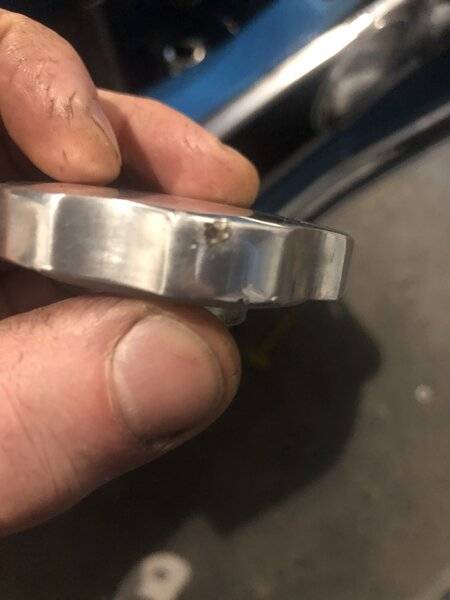

Had one loony thing happen on the way home. Was driving along a county road at about 30 mph about to get on the highway when I heard a pop and what sounded like something rattling around underneath the car. Right then I noticed something in my rear view mirror that looked like a golf ball bouncing off to the other side of the road. Seemed like something in the road so I kept driving up to the next light.
As I am coasting up to the light getting ready to make a right onto the ramp, the car began to stall like it was running out of fuel and then backfired really loud with a car right behind me. Crap! WTF just happened? Flashers on, I get out pop the hood and ... the overflow tank cap blew off? Really? Aaaahhh, that was the thing under the car that looked a like golf ball because it's round and shiny.
Left the car on the curb and walked about a 1/4 mile back up the road to look for the cap. Found it laying in the grass all scratched up but in tact. That was a new one for me! Thinking I may need to use something with a lower pressure rating than a 16 psi cap?
Anyway, after my twilight hike along a busy roadside was over, I put the cap back on, got in, turned the key and she fired right up. Took it easy the rest of the way home but all seemed normal. Crazy.

I fought valve cover leaks for years and then eventually figured it out. The Mopar cast valve covers are very difficult to seal to a cast iron head for two reasons. First off, the cast iron heads typically have a very poor casting surface. If you put a straight edge on them you'll often find voids and gaps. Second, the Mopar cast covers are designed wrong. They are too wide. If you don't believe me just flip them over and measure the rail then measure the rails on your head. The guy at MP who designed the covers wasn't smart enough to use the correct dimensions. About the only way to get that combination of parts to seal is to use the super thick FelPro gasket.
I gave up on all that mickey mouse junk and designed my own valve covers. They never leak and I can reuse the gasket over and over.

Between leak mitigation procedures, I managed to get started on the passenger bucket seat cover. Got the bottom cushion done but then I ran out of hog rings. Summit has packs of them that come with the correct tool (I have one but it's a single use throwaway and it sucks) so that'll be arriving with the valve cover gaskets. So far so good on the install, no major hassles. Everything else is prepped, just a matter of making the time to finish it.
