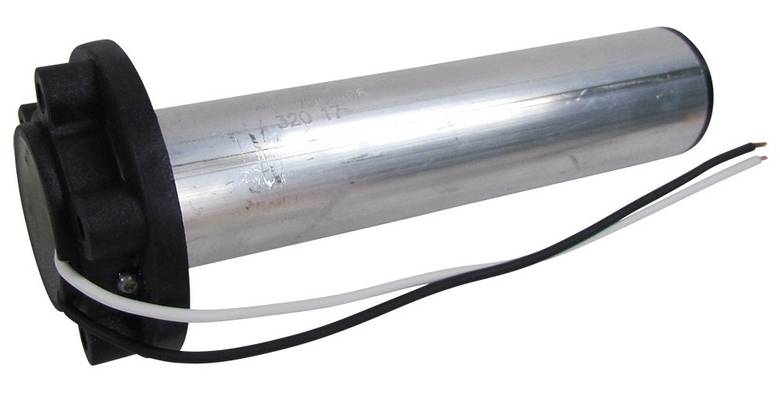

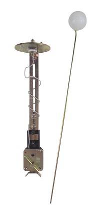

On your fuel level gauge issue.... You have the Holley tank which I'm guessing means means you have a five bolt style sending unit?
If so and you have this style sending unit...
I've had about zero luck getting a decent reading from that sender....
So when I saw this style sender was available I gave it a try.... Right out of the box it was a night & day difference... Since then I've installed three more of the tube style senders & every time it's been a positive experience....
You need to know your tank depth & the Ohm range...
Oh, BTW your car looks great & I feel your frustration.... BTDT...

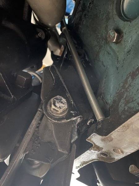

OK, so I got the dipstick tube from my friend today and thankfully managed to get it installed properly. What a hassle.
It wasn't used like he said but "NOS" which of course meant he wanted more for it. His definition of NOS is a little loose too since it wasn't "1968 NOS" but rather from a dealer when these were still available back in 2003. I actually worked at the dealer where it was purchased from for a year and the parts guy was our mutual friend. I was a little surprised that he didn't specify it was a more recent part to begin with because he is usually very clear about stuff but it's fine, it worked out in the end. He's a kooky guy that can recite part numbers off the top of his head but despite his rain man aptitude for parts everyone respects his unmatched knowledge. Besides, he just happens to always have what I need. Gotta take the good with the bad as they say.

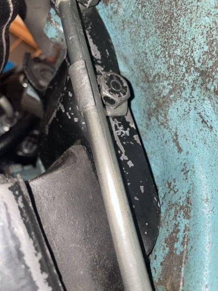

This particular tube is from a later model car, like '70-'71. The mounting tab was in the wrong place for my application, I think this one is supposed to mount to the outside of the exhaust manifold and not the motor mount bracket. The tube is also much straighter than the '68-'70 ones which have more of an S shape. This later one seems to work a little better with the headers though.
One thing I learned today about installing these indicator tubes is that you really need to grind the bottom down so it's very thin. Even though I did file the previous one down, I didn't go far enough. This time I started with emery paper and kept test fitting to see if it would go. The emery paper was taking too long so I went to 80 grit sanding rolls on my air grinder which did the trick. The emery paper was closer to a polish than material removal. Once it's thin enough it conforms to the hole and is much easier to get in. It was sealed with RTV.
It was a hassle to get the mounting tab in the right spot. I cut it off from the original location (which was too high up) on the flat side and then re-shaped it with a hammer and dolly to conform to the tubing. Came out OK. The mount bolt is close to the tube so it had to be pried over while knocking the bolt through with a drift. PITA. I have to either tack weld or braze the tab on then this stupid dipstick ordeal will be done and I can button things up.
Here's the tab that was cut and re-used.

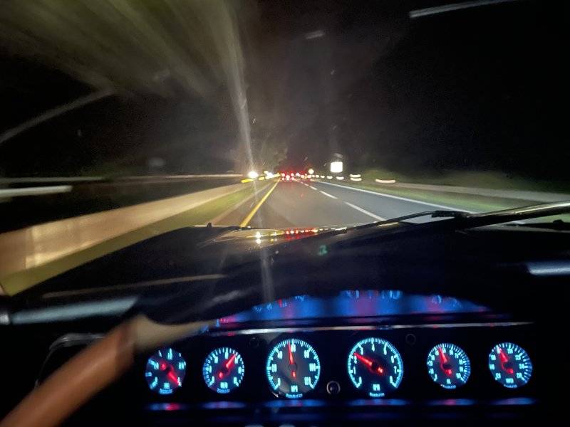

Regardless of cost, the thing I really like about digital gauges is the LED lighting, it makes a huge difference. I can't say from first hand expereince whether this is fact or not but it's hard to see how even newly-restored factory gauges with incandescent bulbs could offer the same level of illumination.
One of MANY features I like about the RTX gauge system is the color options. I had chosen the red backlight for the VHX setup I had that I sold because of red not having a negative impact on night vision.
With the spectrum of programmable colors available in the RTX gauges, including different day (lights off) and night modes, I have a bolder, more colorful daytime combo of needle and backlight and the mostly red night (lights on) mode.

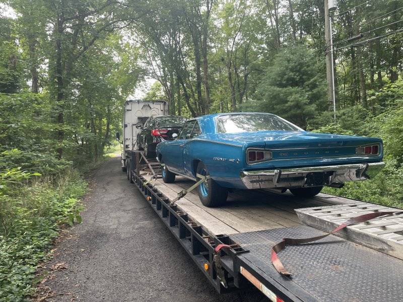

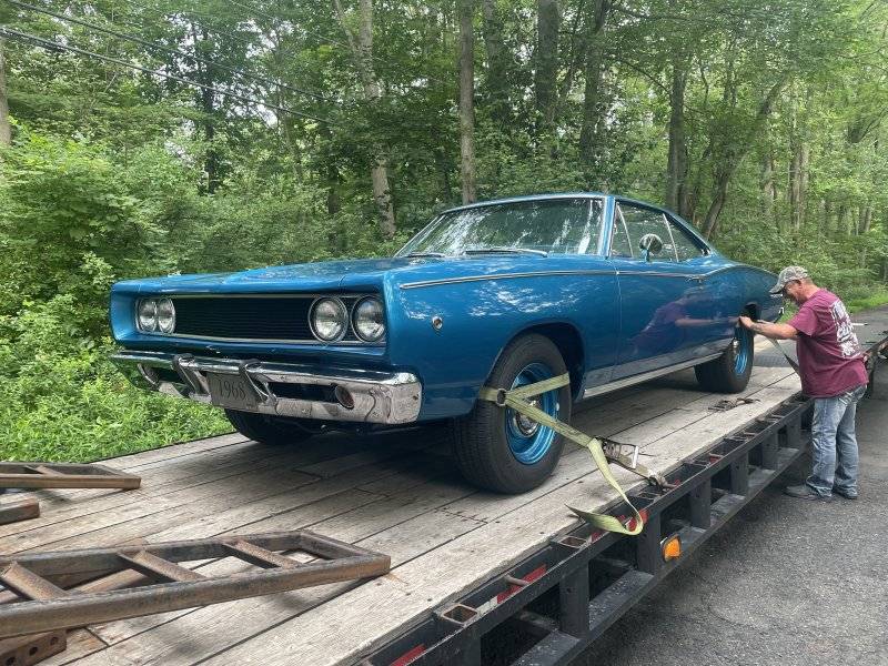

Getting loaded up and heading out to the new owner.
Strapped in, ready to go. Tough maneuvering a big rig around my neighborhood, had to go out and stop traffic on a main road so the driver could turn around.
Goodbye friend!
