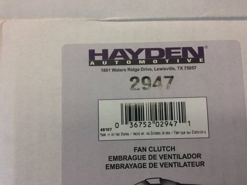

I'm talking a $350 radiator and YES, a Hayden fan clutch, a 7 blade fan and shroud. BOOM. It works.
Just about everything that one member wrote is wrong or far more expensive than necessary. Where are you going to find a "Mopar" fan clutch anymore? Isn't Mopar Performance out of business now? The 3G Hemi has been out for over 20 years and it used a different type of clutch. That is what Ma Mopar has focused on.
I seriously doubt that Ma Mopar still makes a fan clutch to fit our cars. If anything, it would be outsourced like 99% of the stuff that they sold through Mopar Performance.
Here is a winning combination: 26" ECP/Speed Cooling radiator, factory shroud, Hayden 2947 fan clutch, 7 blade stock fan and a Flowkooler pump.
I've driven in 110 degree Sacramento heat with the A/C going and the temperature doesn't go over 200. No boil over either. I've had this setup for 5 years with thousands of miles with no trouble. I always run an even mix of anti-freeze and water. Check out the scale here:

So, doesn't Hayden manufacture that fan clutch ? I thought so.
