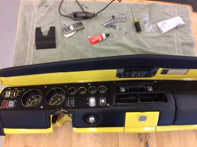

still working on the dash...

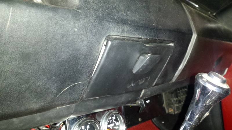

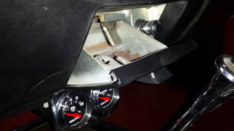

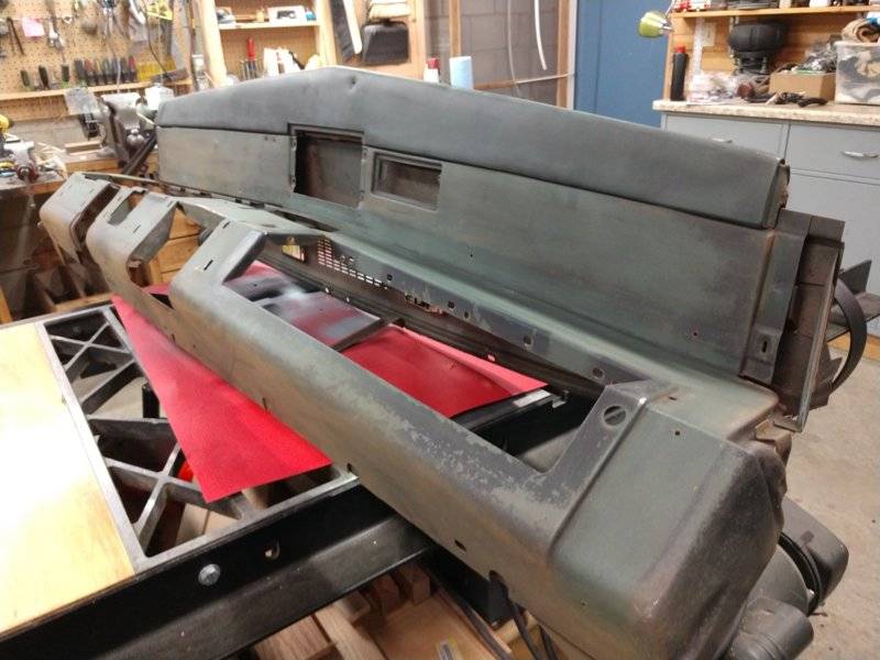

Trying to figure out what I am missing the ash tray....is there a padded cover for the outside insert piece thingy?
Need to go ash tray part shopping...View attachment 686724 View attachment 686725 View attachment 686726

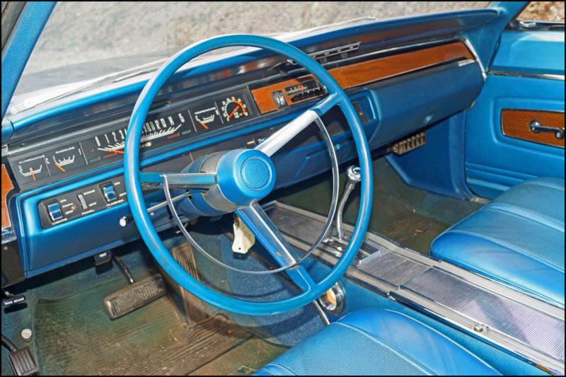

On my car, 68 Charger, that metal face plate is flush with the dash pads and does not have a pad over the top. The GTX is probably different. I don't know which one you may have.

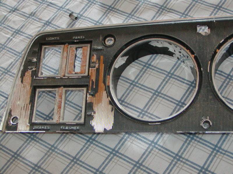

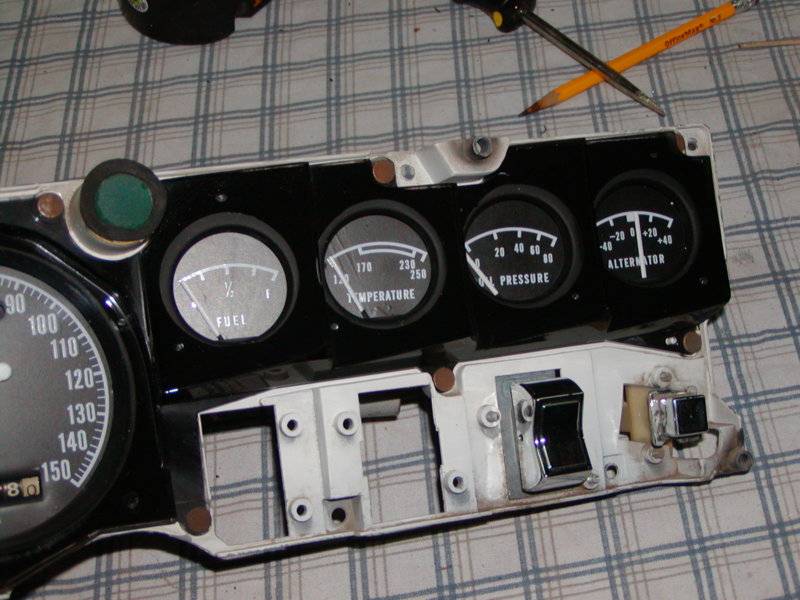

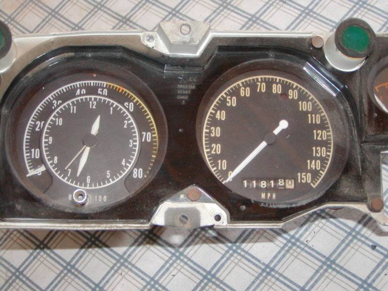

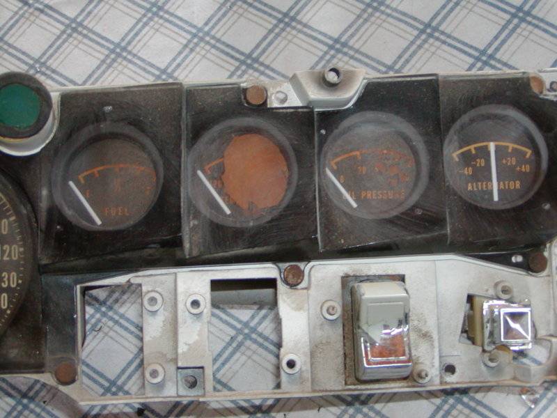

Started with this:

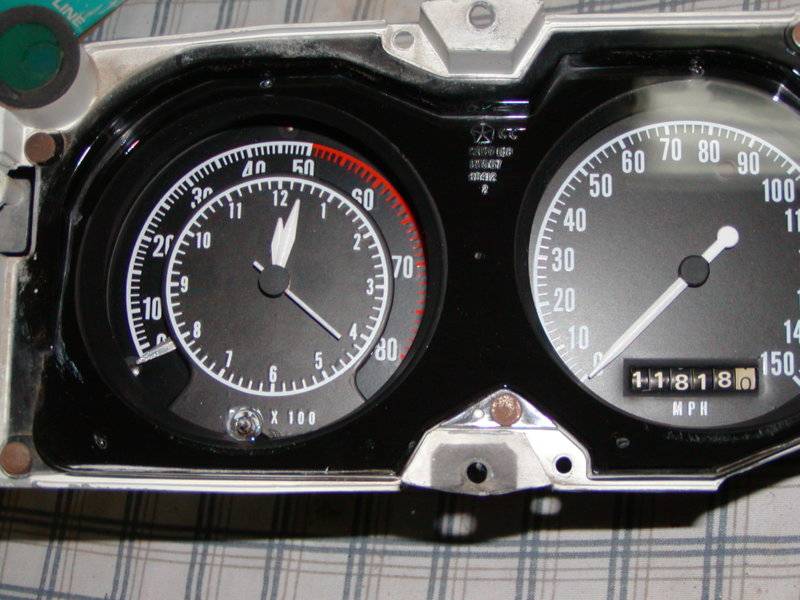

Purchased paint for the needles, chrome switches and faces for the gauges. Also installed quartz movement in the clock.

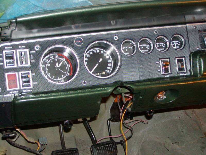

When done:
Very time consuming and tedious work but all I had to buy was the materials.

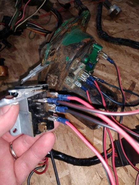

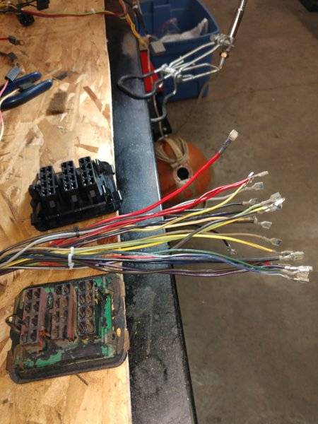

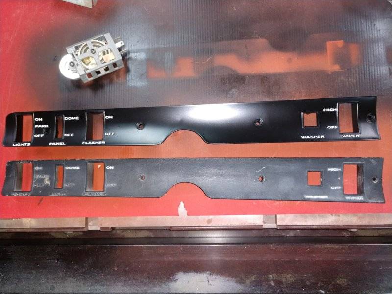

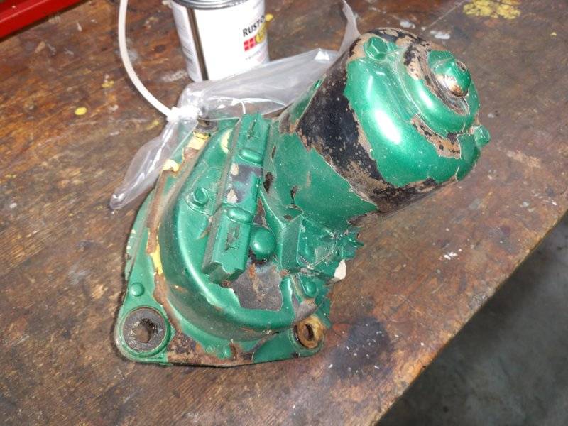

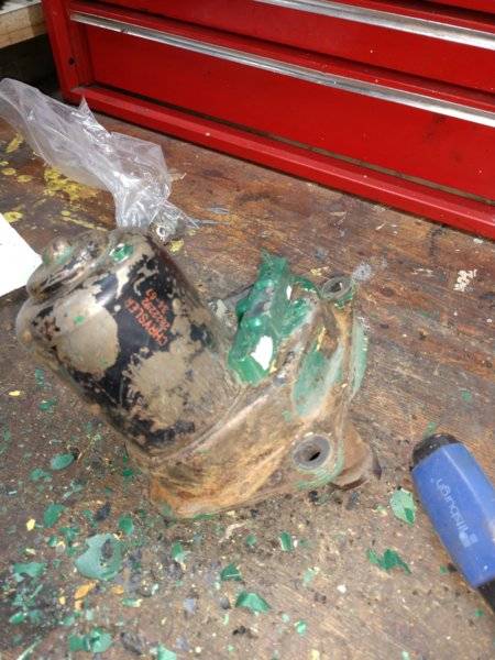

So update.....been working on the dash, switch panel, wiper m
otor, wiring, etc.

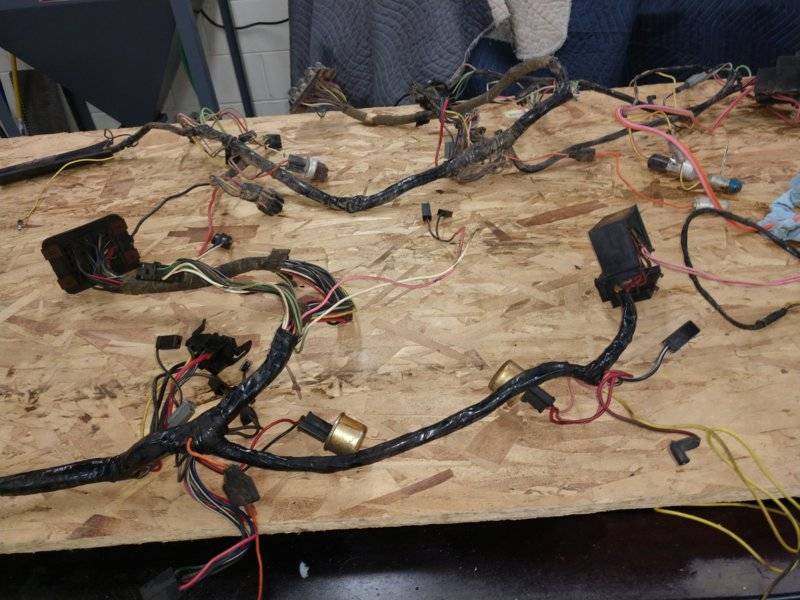

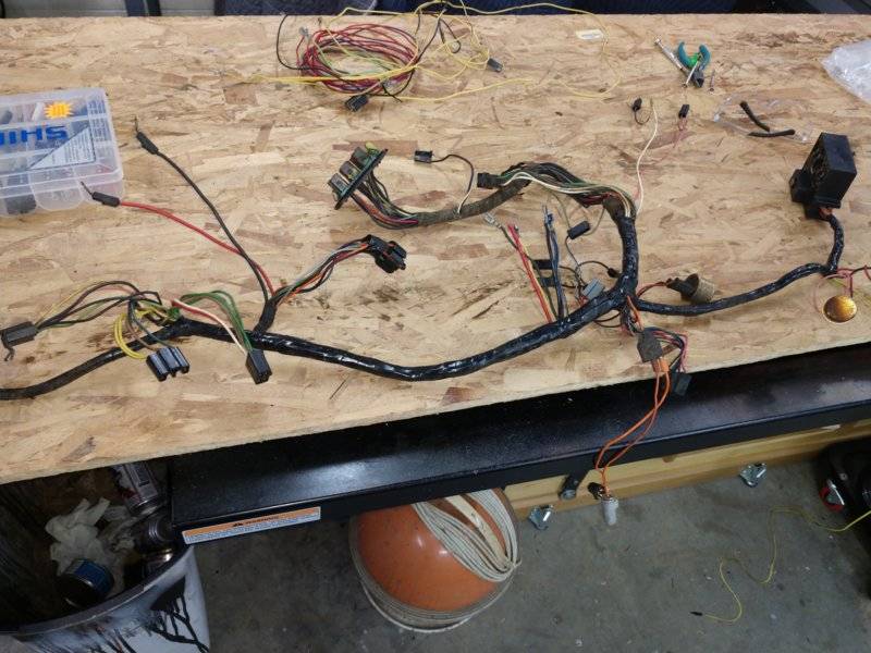

Getty ready to unwrap the 68 harness for my car. I already unwrapped the 69 harness and extracted all the wires I'm going to replace in the harness I'm restoring for the 68.

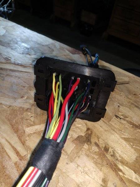

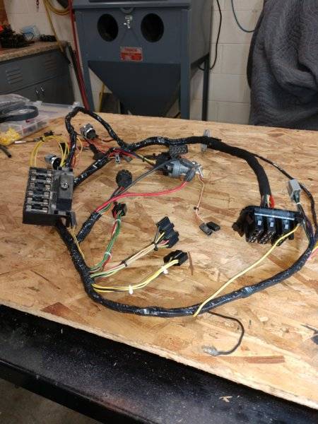

So progress and near completion sans a few details to finish on dash wiring harness.....I converted it to a 4 speed harness by routing the backup light wires through the bulk head connector. Swapped a half dozen or so wires out of the donor harness, new firewall connector, several of the packard 56 wire terminals replaced, new dimmer switch and flashers
New engine harness purchased....heat took its toll on that one. Contemplating rebuilding the headlight and tail light harnesses as I have the supplies and two harnesses to work with, but we shall see.
