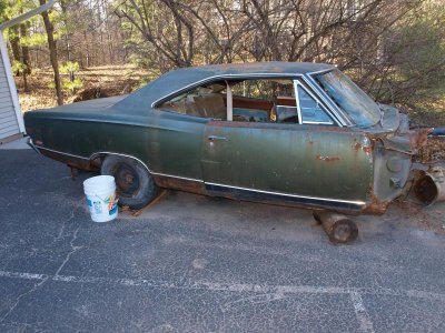

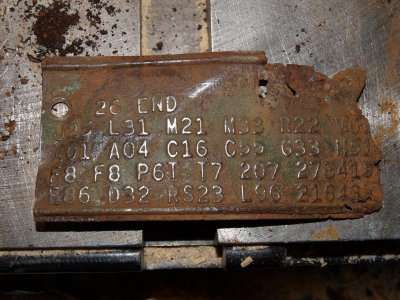

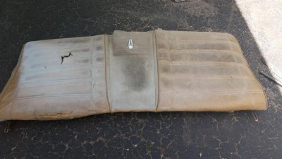

Your fender tag reads like this. Yellow with a white over green vinyl bucket interior, 440, green upper door frames and green accent stripe. Early built car on August 23, '67, b4=buckets, h7=fender turn signals, R1=economy am radio, X2=tinted windshield only, so it was a non ac car. 3.23 non sure grip rear axle, 1-9=either wide sill moulding or lower body moulding , 2-5=is probably drip rail moldings and 7-8=is wheel lip moldings. Since a console isn't called out I'd say it was a buddy seat column shift car.
One crank was available in '68, they were all forged.
If you could post any info up that you know on the parts car or even get it into a registry along with the one you're building that would be great too.
