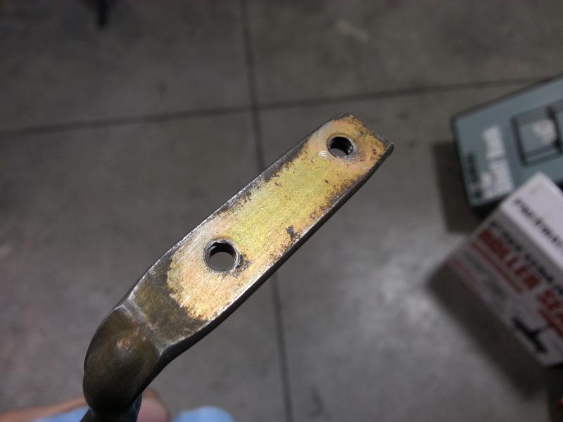

All of the restored headlight bucket arms I have seen were painted grey, so I would have thought they were unpainted originally. Maybe shoot Mr. Cranium a pm as his 68 is really detailed nice - he might know for sure.
Your car was T5? Really? Want to trade? I just love that color on these cars.
I ended up noticing the preserved plating that would be covered by the plastic of the headlight doors, looks like it's got to be some type of cad plating so I ended up just satin clearing it after some cleaning to preserve what was left of it :shruggy:

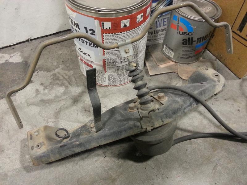

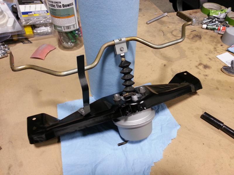

Did sneak a little work in though, one vacuum pod assembly down, one to go! :icon_cool:
Damn before I saw the headlight pods set up I thought that was some funky Charger sway bar. Nice work though speedy and good on you for getting out with the little woman and seeing a cool concert .. he's a car guy btw
Yeah it was a really awesome show, definitely planning on seeing him again next time a tour rolls around. We had seats about 10 ft from the stage, dead center, so it was a great time for sure. He even did the decapitation and huge Frankenstein thing, wish I could've met him to BS about cars and stuff though. Him and Joe Walsh are on my list of people I want to meet at some point in life haha
Oh yeah, I didn't tell you I upgraded to that newfangled space-age 1/4" sway bar? hahaha I probably should've posted it with a pic of the whole thing put together in the first place lol

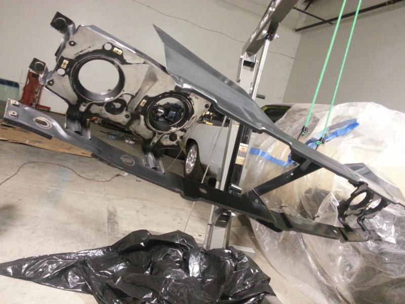

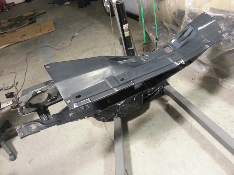

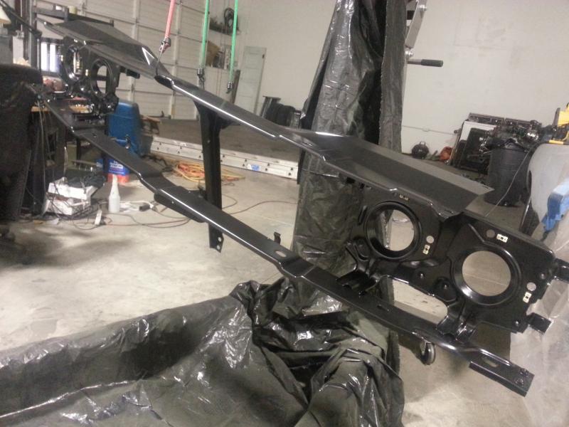

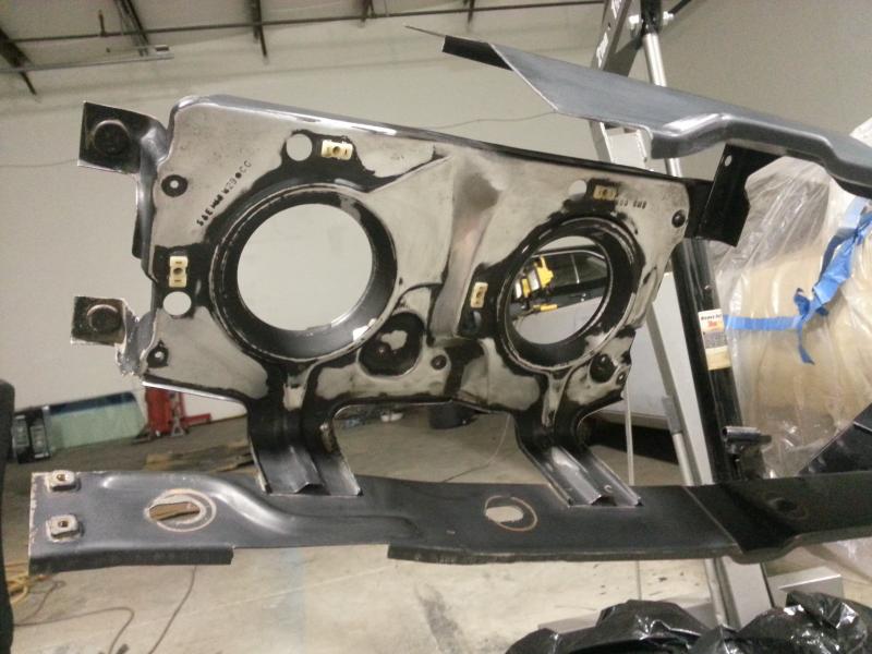

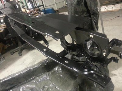

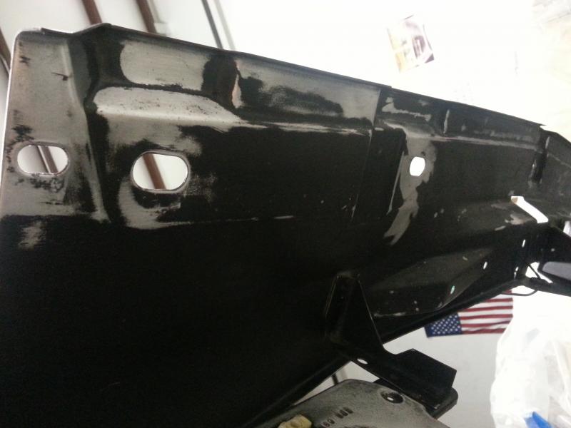

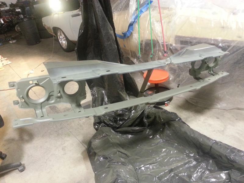

Well it was a busy, cold holiday weekend but I finally got the gas turned on to the shop, heater cranked, and the grille frame all fixed up, sanded down and painted. Had to straighten the outer tabs on each side that were tweaked pretty bad and the wide vertical piecethat goes down the middle had a bit of a bow to it. Nothing some gentle convincing and a pair of vicegrips couldn't take care of.
For once I remembered to do the smart thing and test-fit it before paint haha

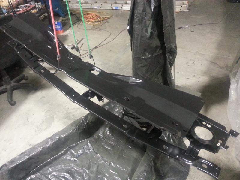

Didn't have too much surface rust, so I just took a wire wheel to wherever there was and sanded down the rest. Don't mind my ingenious cherry picker/ bungee cord hanging system lol

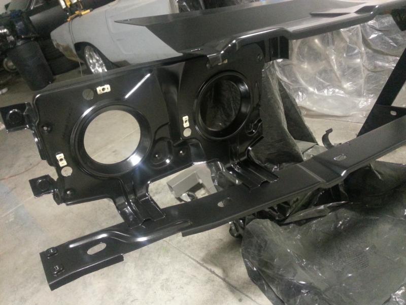

Then the usual program, some etch primer..
..and topcoated with some satin chassis black. On to the trim and hopefully thowing this thing back together soon :icon_pray: hope all you guys had a righteous turkey day

Grill frame looks brand new. Love that satin paint. Is that Eastwood spray can?
You are doing some great work and I appreciate your ingenuity and steadfastness speedy! Nicely done young brother
Panel looks good. Ingenious people must run in crowds cuz I use bungee cords hanging from nails on my cross braces when I need to paint several parts.
Thanks daytona! The paint is actually the satin black chassis paint from the Martin Senour line I get at the local napa. Sprays really smooth and is pretty damn tough too :icon_thumleft:
Thanks guys! Gotta do what you gotta do, and bungees definitely come in handy for Macguyver'd up painting setups lol. For anyone that's repainting their grille frame, it probably would've been easier to spray it hanging vertically on end like the factory did, but didn't think my engine hoist would go high enough, and it was too damn cold to open my shop bay door and hang it from that lol
