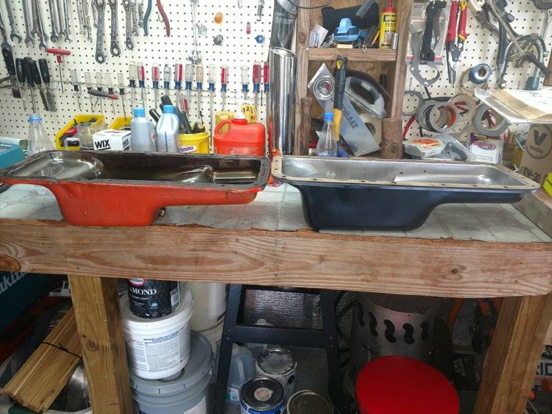

Lots of good info here thank you gentlemen. That $89 pan from 440 source looks great, I think I'm going to go that route. I was considering a windage tray but the motor has run this long without one might be best to leave it as is.
I just recently got that repro 6 quart pan and IMO it's a bargain at $89. Very well made unit
and fits with ease - and you can get their pickup with it if you like, but know that the stock 4 qt.
pickup works just fine with the 6 qt., too (same dimensions on both).

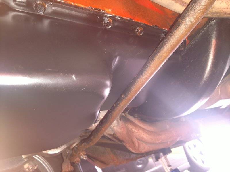

Does your stock center link fit underneath? That's an issue with the current 6 qt pan I have... rubber mallet fixed it though
Yep, fits perfect. It should, after all - it's a direct copy of the factory hemi pan.
It gets the additional capacity laterally rather than by being deeper.
