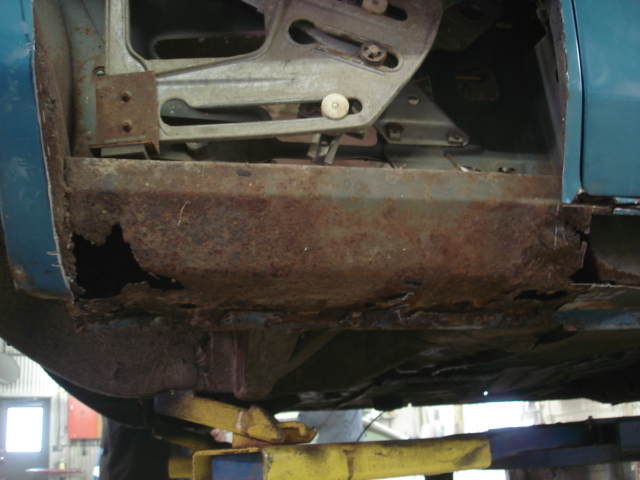

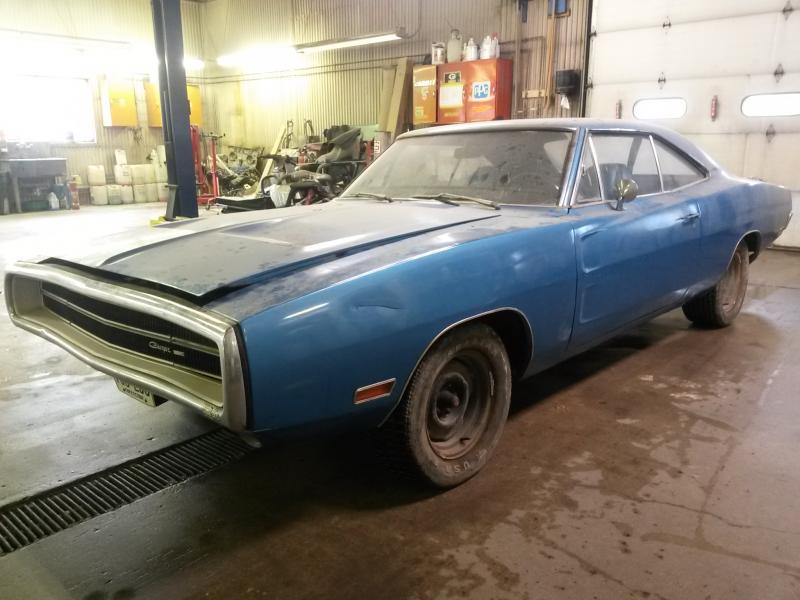

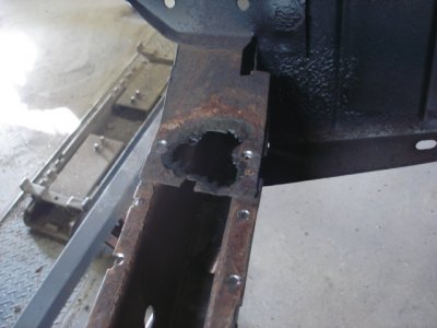

We are doing on a '70 Charger restoration at work. It's just a regular 383, auto. Have it stripped down on the rotisserie waiting to get media blasted. After it gets back from blasting we'll be making a long list of parts to order.
Have a question on the inner rockers. Is the piece of innner rocker available from AMD? Can't find it on the site.

I wouldn't care if they did make those. I'd rather fabricate my own for a fraction of the cost.
Give Jeff @ 521 Restoration a call. I got lucky and mine were ok, but I remember Jeff telling me he had them if I needed them. They come in 2 pieces just like the originals. He had to use them in one of his own cars. I don't see them listed on his website though.
Thanks for the replies. Wouldn't take much to bend them up be figured if I'm ordering a semi load from AMD might as well throw them in the truck.

Car left for the blaster today. Should be back early next week.
That grille looks nice!

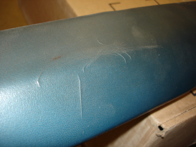

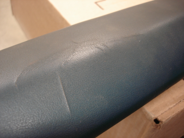

Getting the dash tore down and the dash pad has some cracks. Was looking at a few sites and there seems to be a big difference in price. Legendary shows them for $492 but Herbs has them for $117. Herbs calls them caps, is that just a fiberglass or plastic cap that's hard? B/E&A has them for $254.

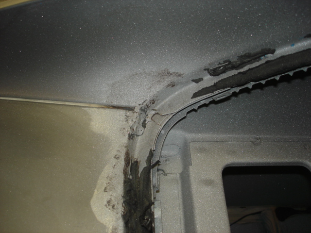

Pics of cracks.

I have a dash cap on mine. You have to look close to see that it isn't OEM. The raised areas have to be shaved down so the dash cap doesn't have any ridges in it.

you're car looks like it requires a full rocker panel..
The part that you inquired about is part of a full rocker from amd.
Althow before amd came about we used too fab them.
Thanks! The pics on the AMD site don't show very well.

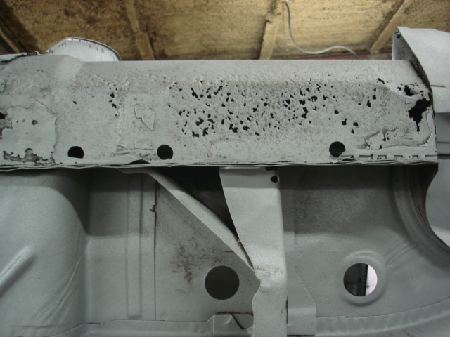

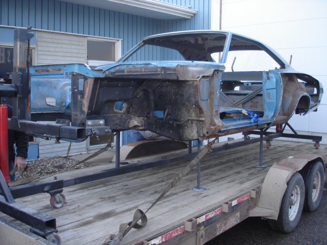

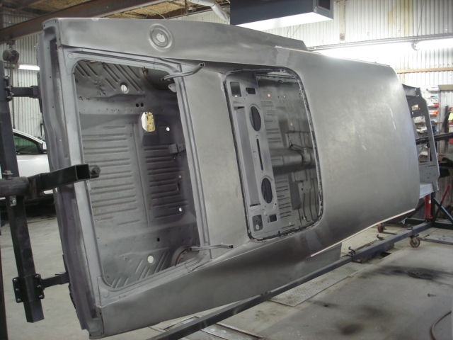

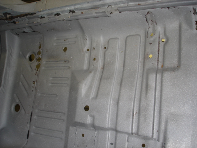

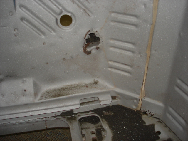

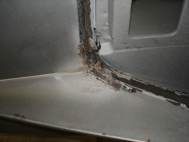

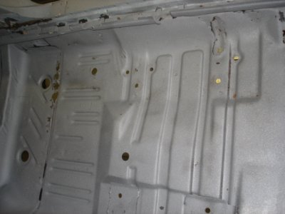

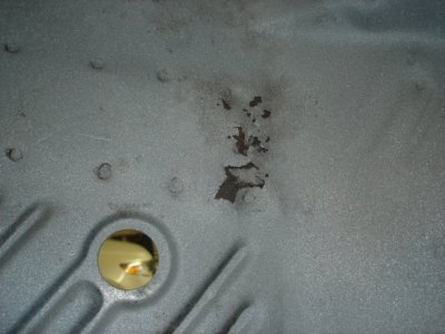

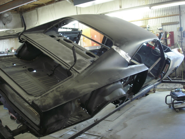

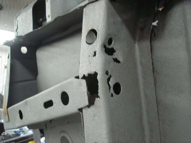

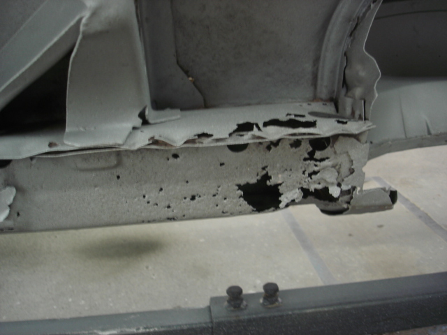

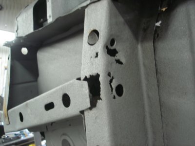

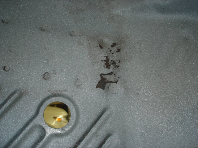

Here are a few pics after the blaster. Whoever painted it last had sprayed the underside with some nasty thick undercoating. Knew once that was gone some sins would show. It's going to need both front floor pans, and the truck floor is peppered with holes. Second pic is the torsion crossmember.
The rear window was in better shape than expected.
DSC01012.JPG DSC01021.JPG DSC01022.JPG DSC01023.JPG DSC01024.JPG DSC01025.JPG DSC01027.JPG DSC01028.JPG DSC01029.JPG DSC01030.JPG

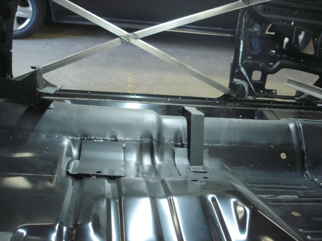

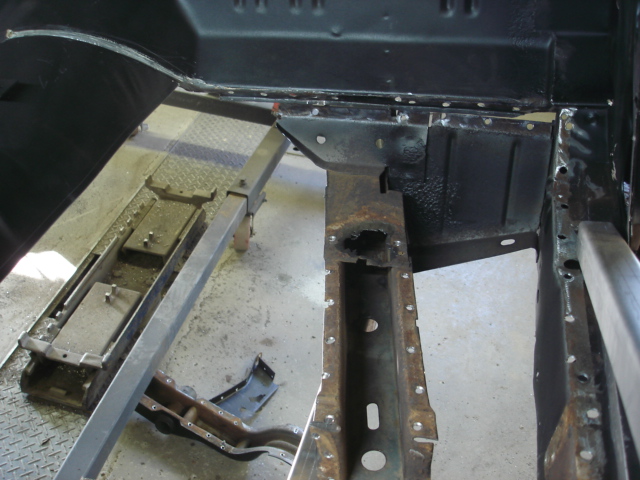

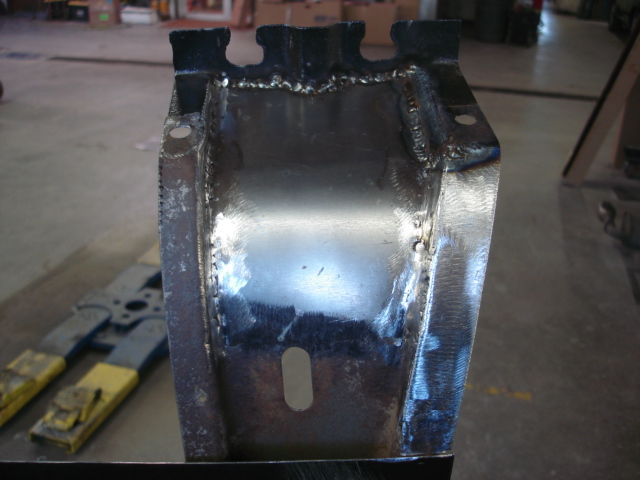

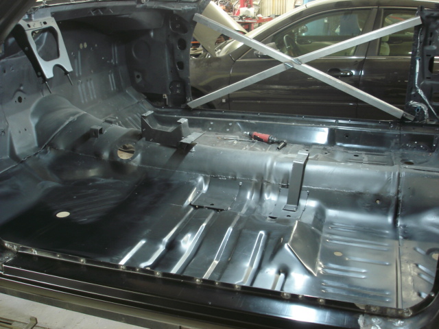

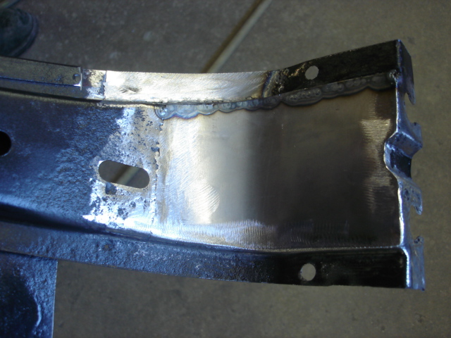

Been plugging away on the Charger. Have the front L apron installed, front floor pans and torsion bar crossmember installed. Started on the rear wheel houses now.
This car is going to be a driver. I'm on the fence to what to do with the underside. Seam seal the seams and spray it B5, spray it with Lizzard Skin then B5? I dont want to leave it black.

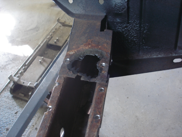

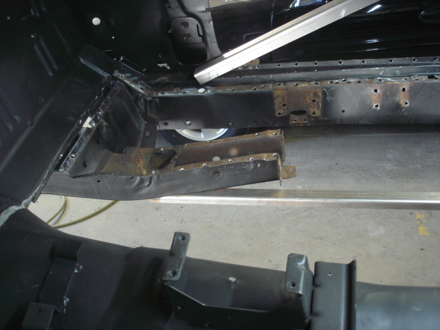

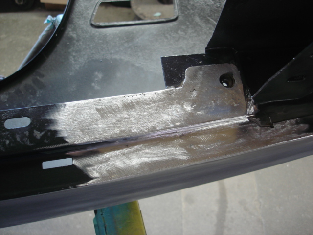

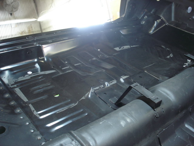

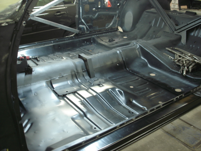

Here are some pics.

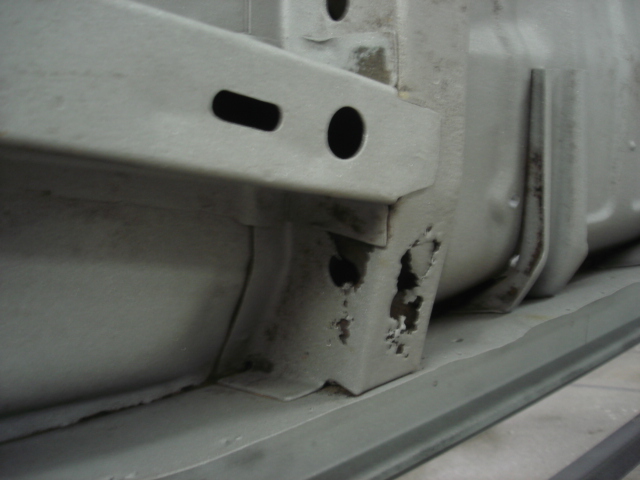

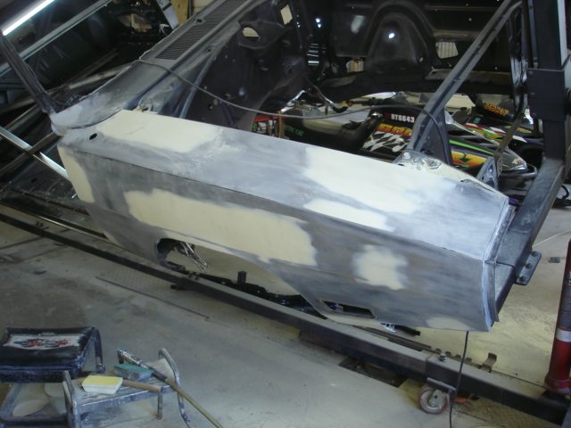

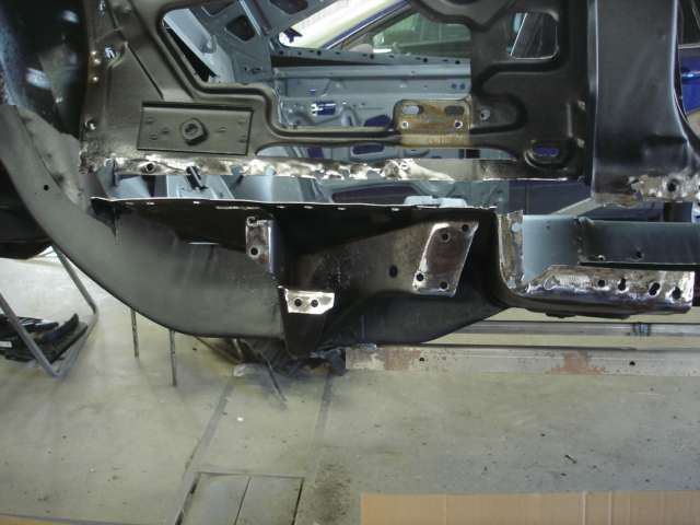

Fender and inner structure repair
Passenger side floor pan removed
Pass inner rocker removed

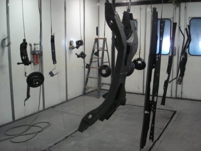

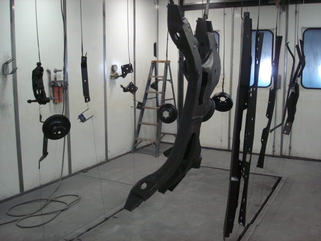

Part hanging in the booth getting epoxy primed
DSC01157.JPG DSC01159.JPG DSC01160.JPG DSC01235.JPG DSC01236.JPG DSC01237.JPG DSC01240.JPG DSC01258.JPG DSC01259.JPG DSC01260.JPG DSC01261.JPG DSC01262.JPG DSC01273.JPG DSC01274.JPG

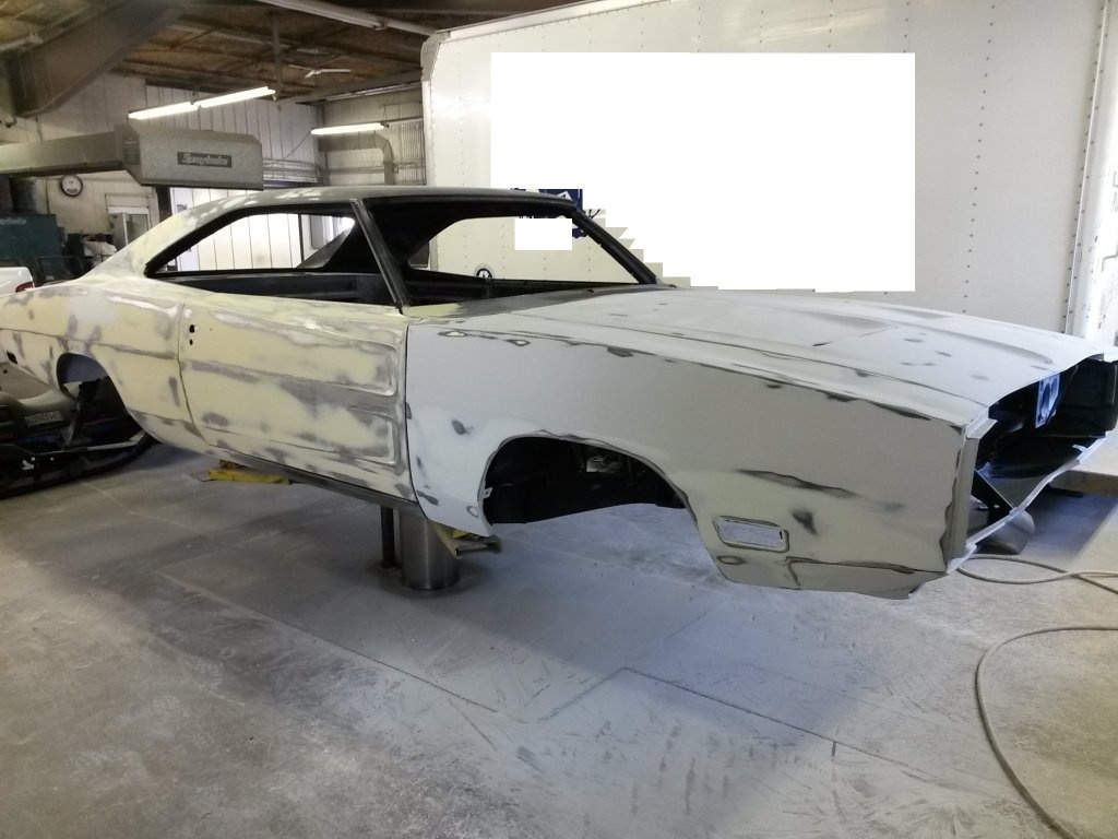

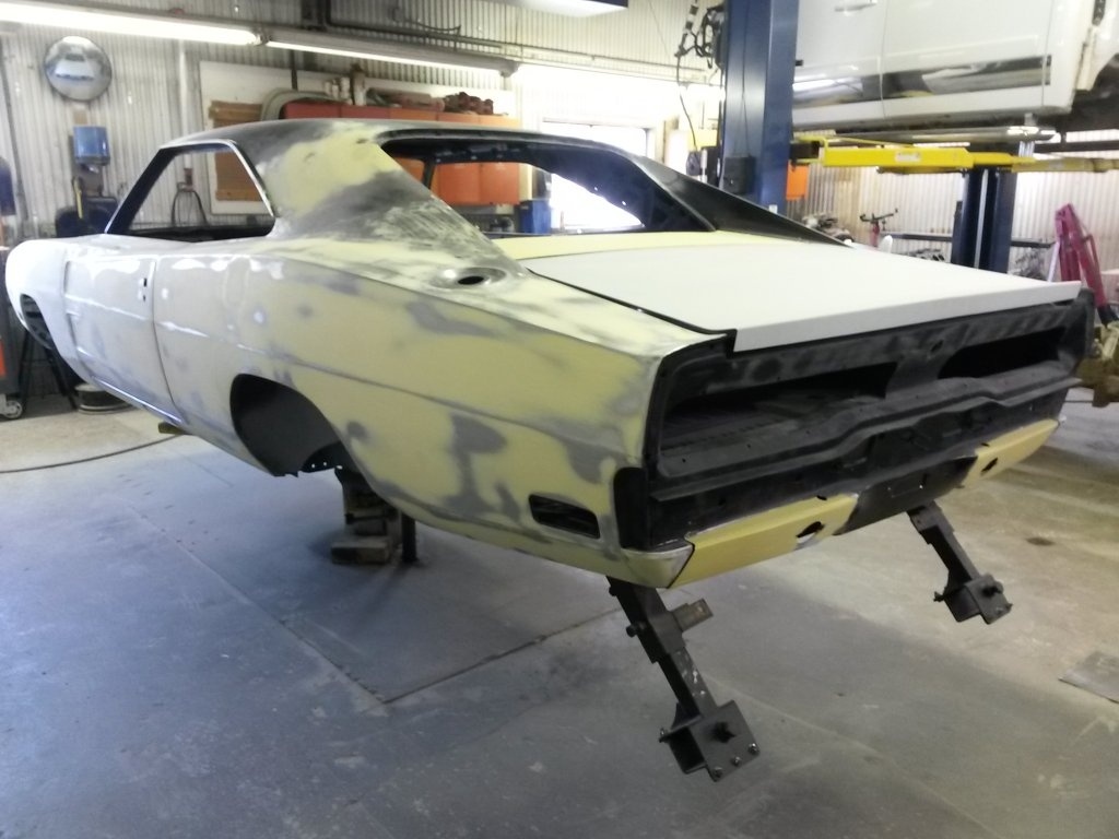

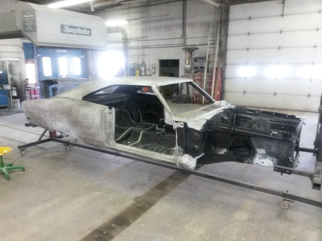

It's been awhile since I've updated. We waited a few months on a back ordered R qtr from AMD. All the metal work is completed and has had one coat of primer thats been blocked out. Another coat of primer on now.
Interior is going to get sprayed with Lizard Skin then top coated.
Car was originally B5, but we did a spray out of both B5 and the new B5 blue for the newer Chargers. Waiting for the customer to decide.

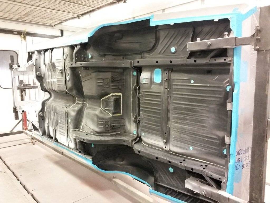

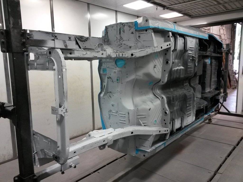

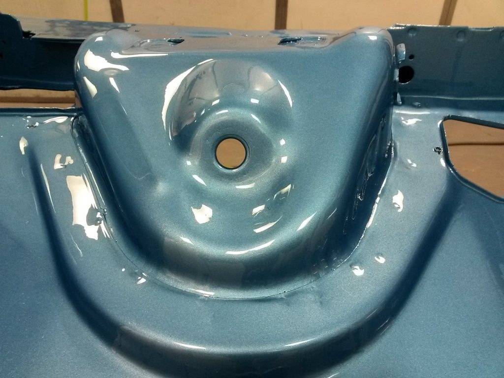

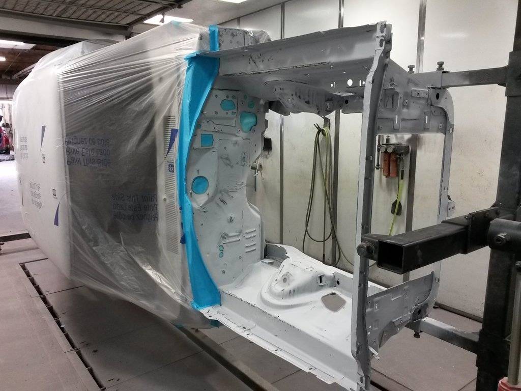

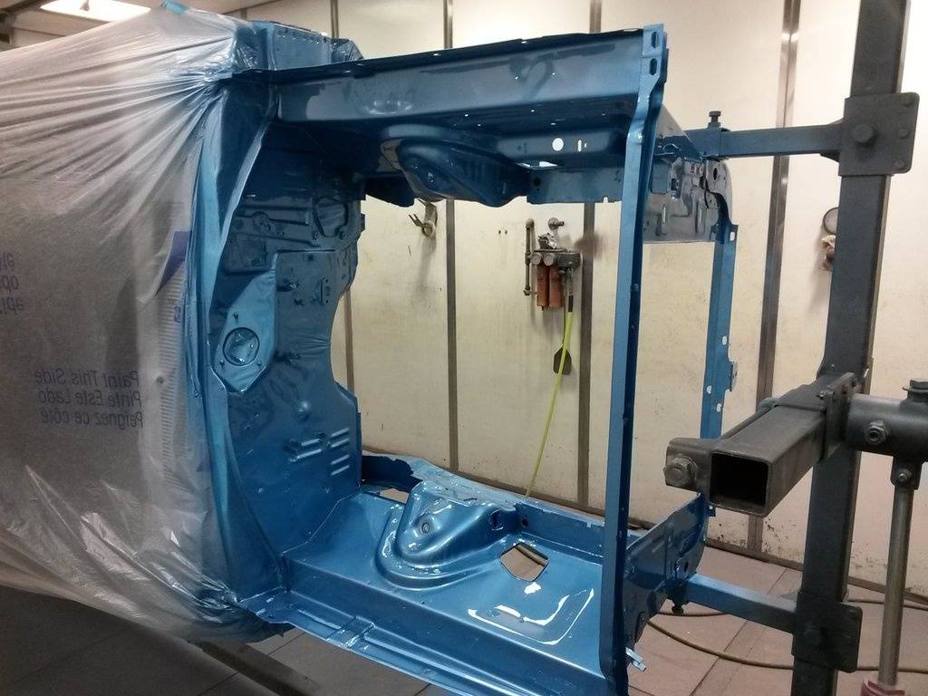

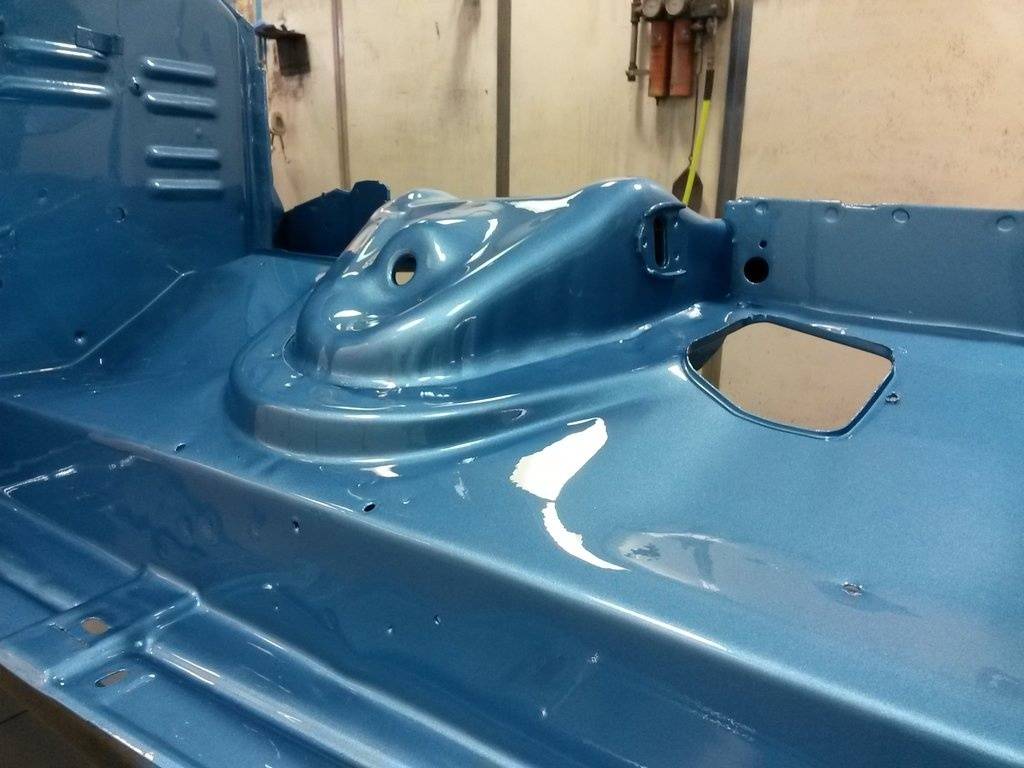

The Charger progress is going slow but it got rolled into the booth to get B5 sprayed in the engine compartment and underside. Customer decided to stay with the factory color and not the new PQD code. Engine is ready for paint too.
We have B5, layed out nice and smooth. This is PPG Envirobase paint.
