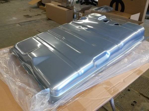

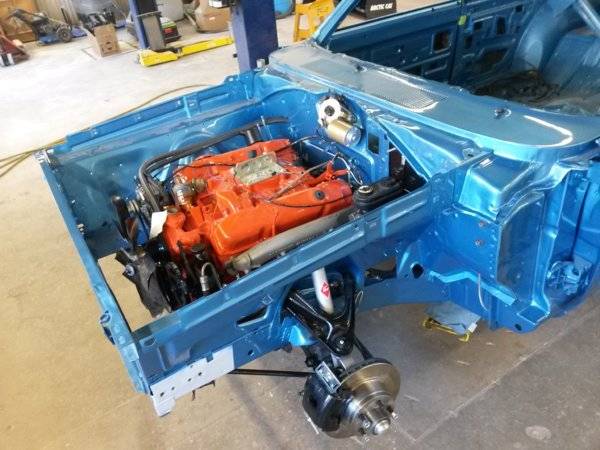

Not much has changed with the Charger project. A large order was placed to Legendary for interior and to Summit. We are putting a Holley Sniper on it. Ordered a Tanks Inc EFI tank, pump and sender. Steering gear is at Firm Feel for a stage 2 rebuild.

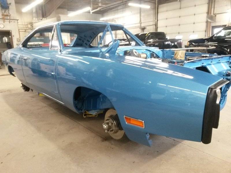

Car is now a roller. We are going to wet sand and spay another round of clear on it. Once that's done the engine can go in.

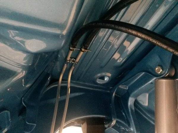

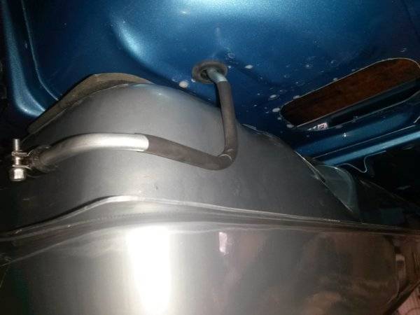

Here is some updated photos. Motor is in, fuel tank mounted, lines run.

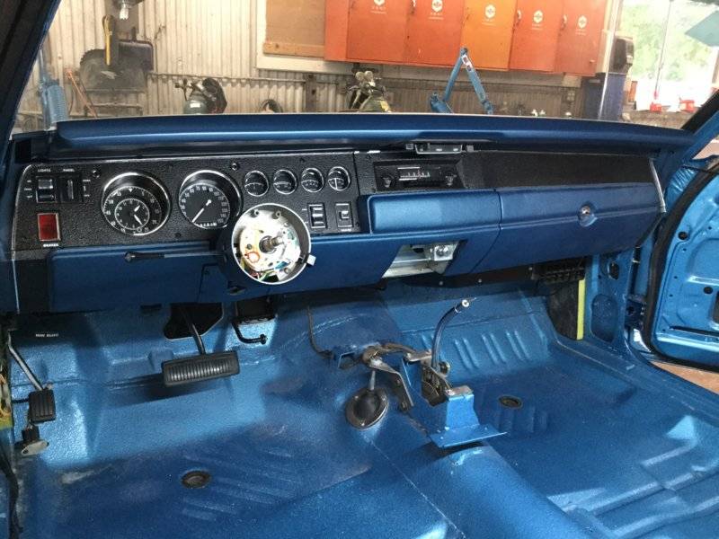

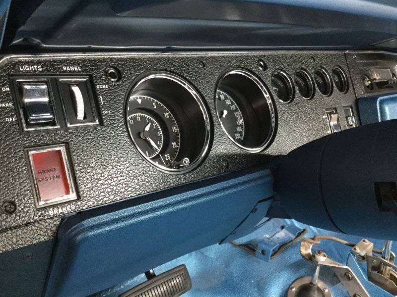

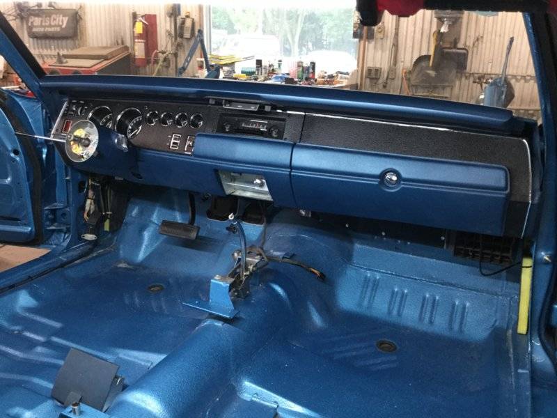

Been working on the interior, man these blue interiors are a lot of work. So many different shades and textures of blue. Been working with David at Performance Car Graphics, he got us the correct paints for it all. They also rebuilt the instrument cluster too.

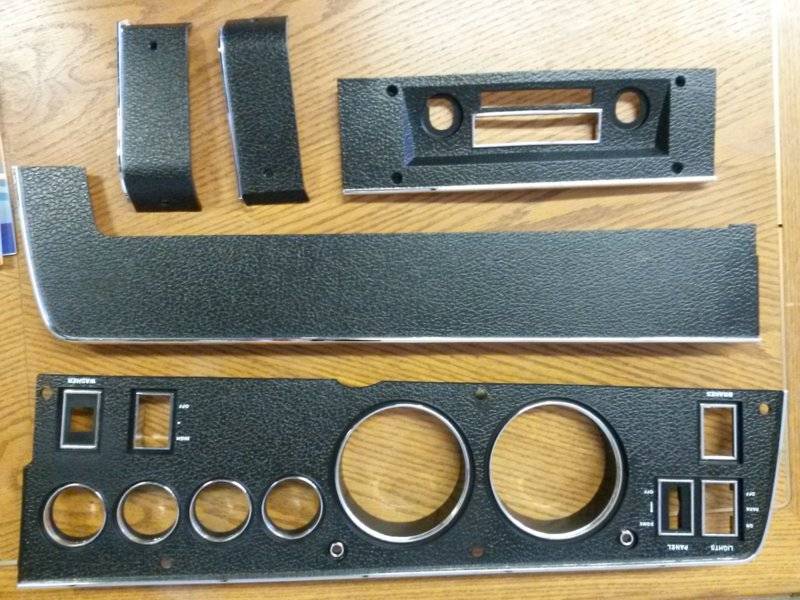

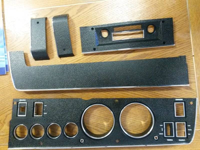

Dash frame and plastic are painted, installed in the car. The dash bezels were sent to Vacuum Orna-Metal to get refurbished. Center console has been painted, top plates polished and black has been painted. The original wood grain inserts were in great shape so they were re installed. Seats are done waiting to be installed.
Side glass is installed, waiting on the windshield and back glass until we get the headliner installed. Was not impressed with the quality of the AMD glass.
Wheels will be Magnum 500's. Planning on 275's on the rear and 235/70/15 on the front.

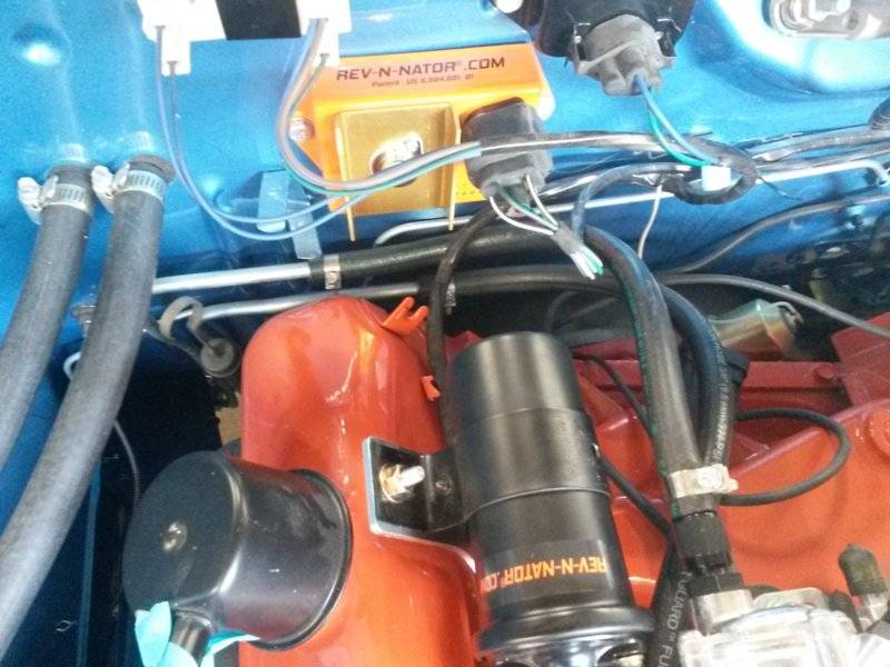

Need ignition system yet. Plans are to go with a Rev-N-nator, Firecore dist. The Holley Sniper wont be controlling the timing.

Got the original dash trim back from Vacuum Orna-Metal today. Stuff looks great! My pics dont do it justice.
Headliner install next week.

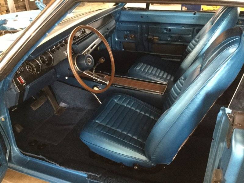

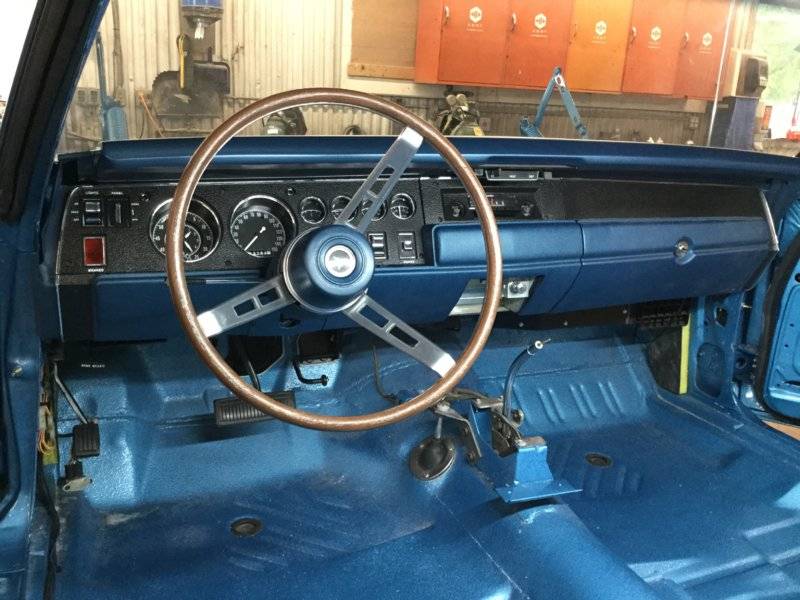

Got most of the interior installed. Still waiting for some dye from Performance Car Graphics for the upper door and qtr pads. Dave has been great to work with. They also rebuilt the instrument cluster.
Front seats and console installed.

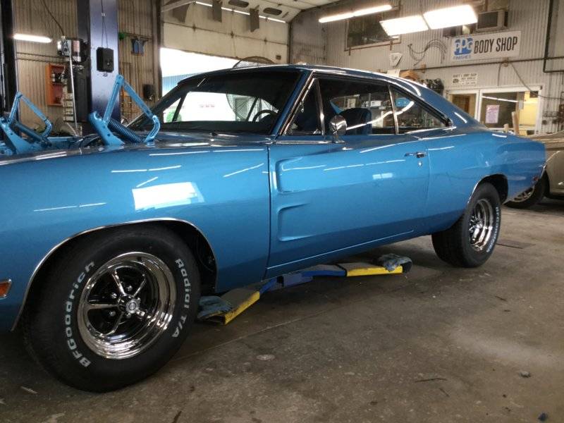

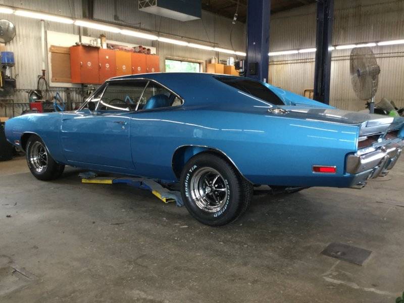

Had to throw the wheels and tires on for some inspiration. The HD rear springs sit a little high yet, hoping they settle a little.
The Sniper isn't controlling timing so we went with a Rev-N-ator system. The new ECU is modified so Sniper can get it's tach signal directly off the back of the ECU. Used an AR Engineering coil bracket to move the coil away from the Sniper, so hopefully we don't have any RFI issues.

What did you go with after for tires sizes? Mine are 235 60 15 in the front and 275 60 15 in the rear, I feel mine is still raked a bit high in the rear, however I do not have the rear bumper or glass installed and no fuel in the tank, that may all bring it down a little
I just noticed you were going to use 70 series up front where I used 60 series, perhaps I should go to a 70 series
Yep went with 70's up front. They are the same height as the rears. When I took those pictures all I did was crank up the torsion bars until it looked OK. Still needs an alignment and more parts installed up front.
