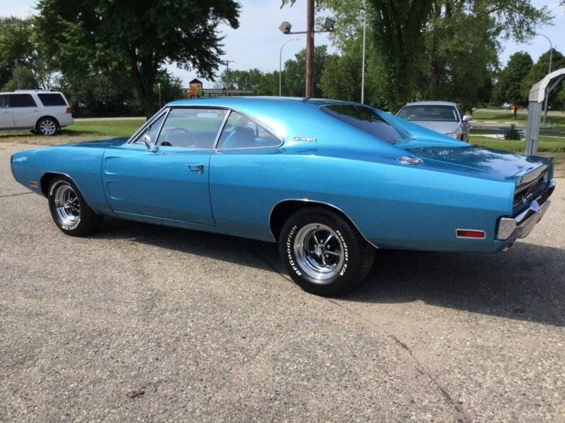

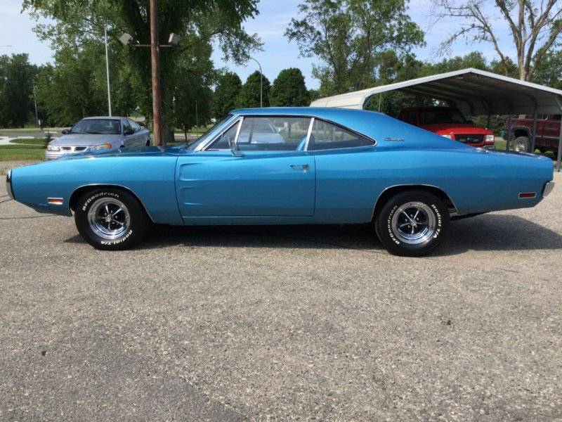

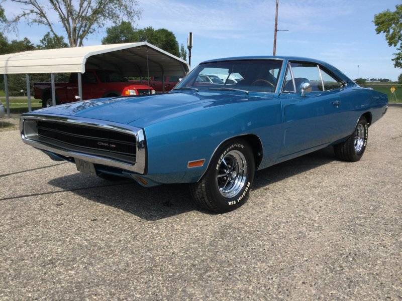

Yep went with 70's up front. They are the same height as the rears. When I took those pictures all I did was crank up the torsion bars until it looked OK. Still needs an alignment and more parts installed up front.
Thanks for the info , car looks great. I think I’ll swap mine out for 70’s. The tire shop said they will exchange them since they haven’t been used yet
