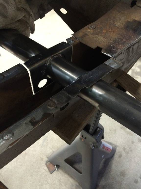

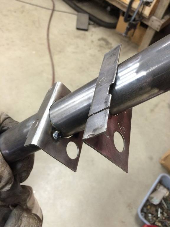

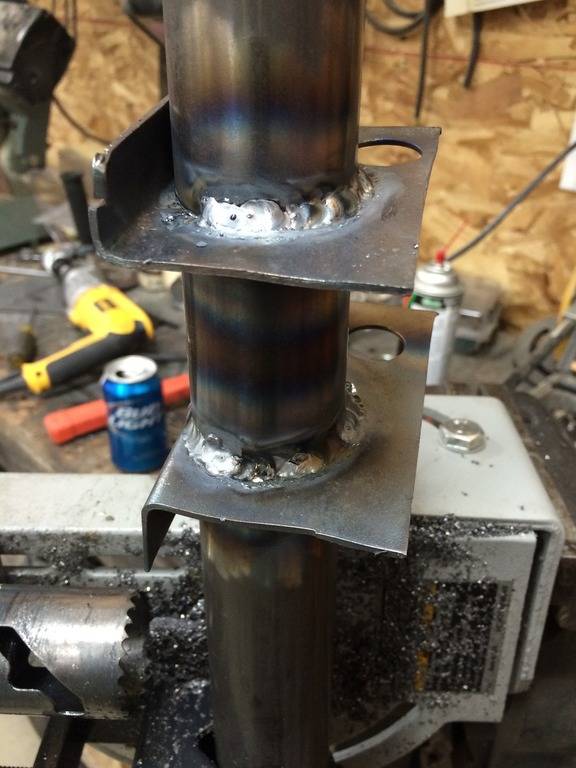

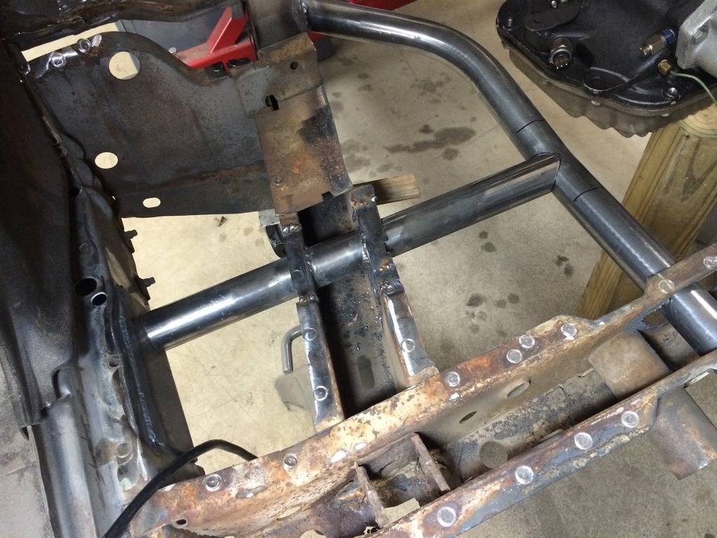

Did a little more work to the floor bars today. I fitted the pieces of the original frame and tacked them onto the tube.
I tig welded the pieces to the tube inside and out. The TIG torch is giving me fits as it would shut off the gas flow if not held right. Time for a new power cable.
Here's what it looked like when stuck back into position.

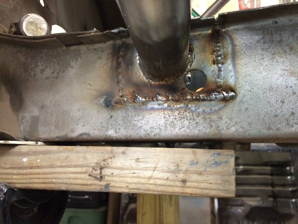

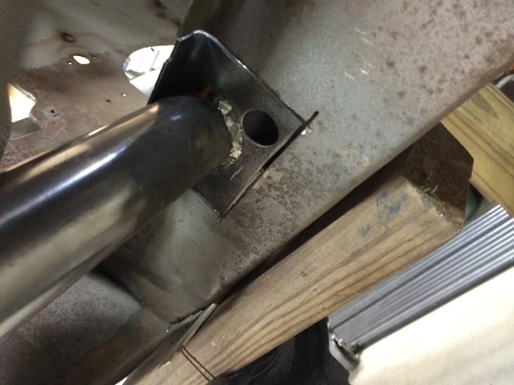

And...........from the outside of the frame. The little hole was factory. I decided to leave it. Holes weigh less....lol.
And welded. Once I grind the welds, you won't know how it was done.......... well, anyone reading this will.

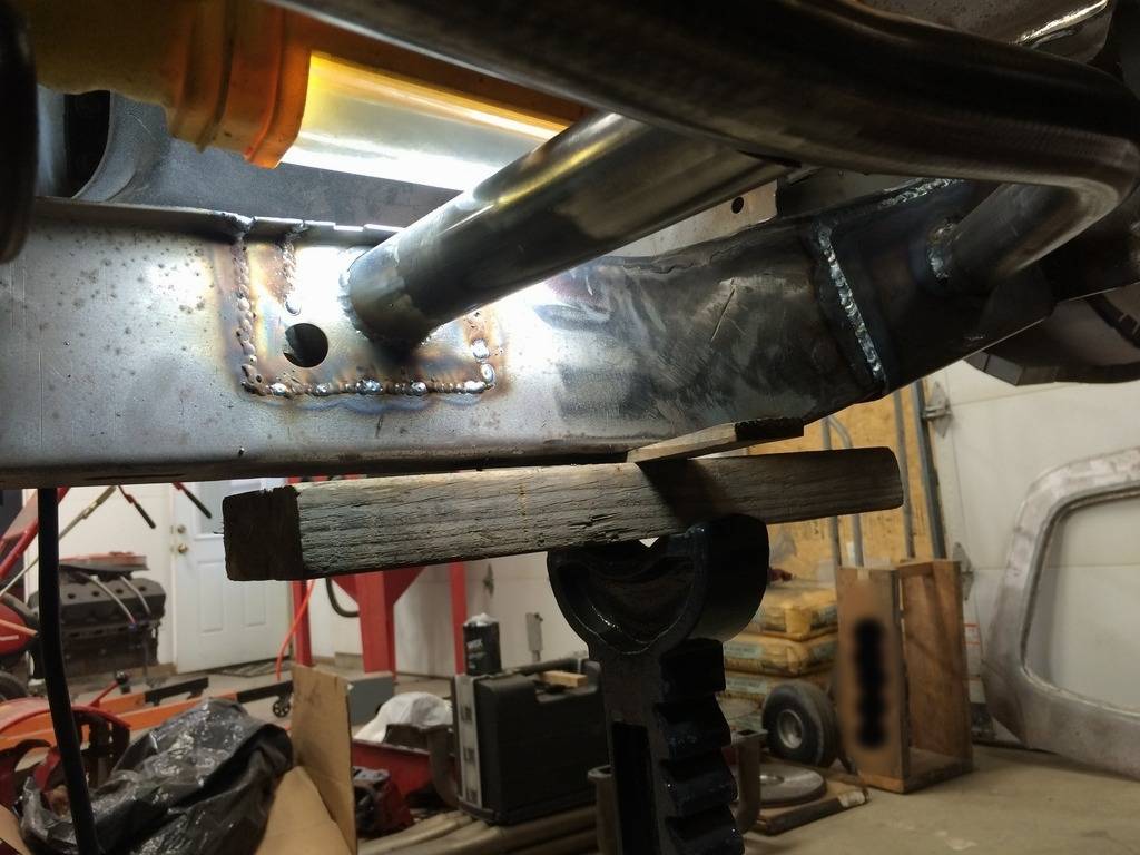

And the other side..........
Overall view.... now I'll finish the passenger side, weld everything out, grind the sheet metal welds and then cut out the factory torsion bar crossmember. I have a new chromoly tube trans crossmember going in between the inner frame rails. Once I get that in, I can finish up the motor plate, mid plate and limiters. Once that's done, I can finally pull the block out and get going on the engine build!
