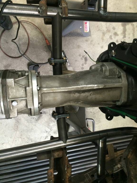

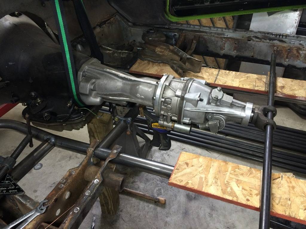

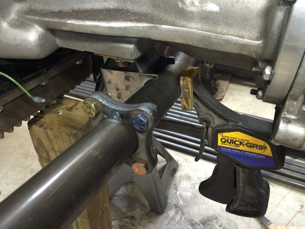

Been working on the floor bars and transmission mount.
I have never been a winged car fan. I know I'm Crazy! But DANG!!! (Joe Dirt), I know I'm gonna LOVE this bird when it's done.
And welded it into the car. Then I hacked out the rest of the torsion bar crossmember. There are still a lot of bars to go in this thing.

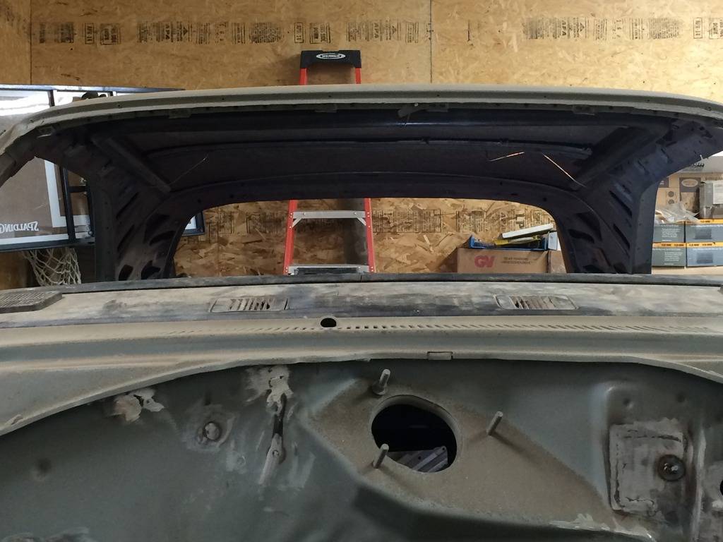

Bent up the upper "halo" so that it tucks in tight. There's still enough room for the headliner but it should be tight enough to run the factory rear view mirror and sun visors if I so choose.
Here's the front view. Nothing I hate worse than a cage hanging in your face....
