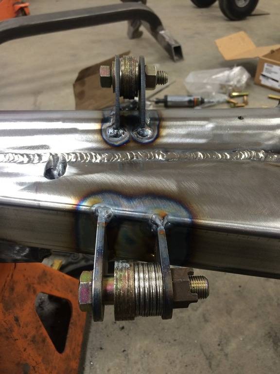

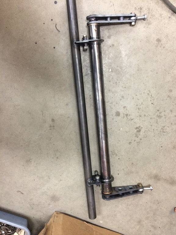

I finished up the shock tabs and anti roll bar tabs last night. The ARB tabs ended up where my brakes lines originally were prompting a relocation of those. My original plan was to run studs out the bottom instead of U-bolts. The problem with this plan is that studs won't swivel if pinion shims are used so I went back to U-bolts. Using these necessitated some holes in the back brace. Anyway, it's all reworked and going to the powdercoat shop today.
