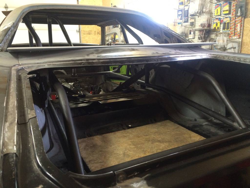

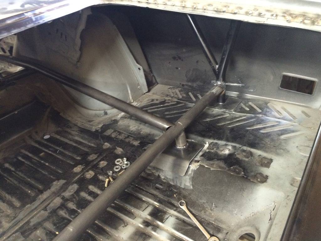

I got the rear cross bar in today. It's all welded out and welded to the wing supports. Had to do that while laying in the trunk, TIG foot pedal between my knees. What a clusterflock, lol.
I still need to weld all the plates to the floor, but that will be tomorrow's project.

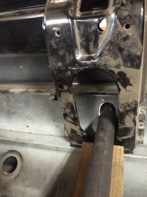

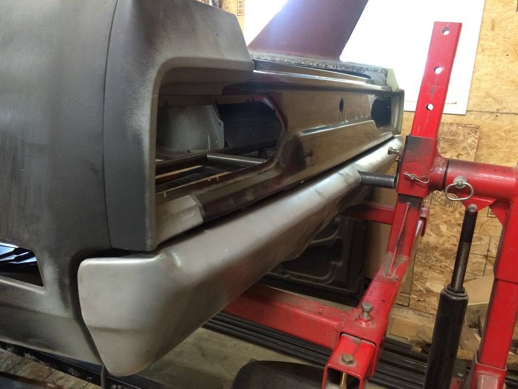

.....and exits the bumper. The tube will get profiled to match the bumper. I did it this way to retain the factory gas tank filler and flip down license plate.

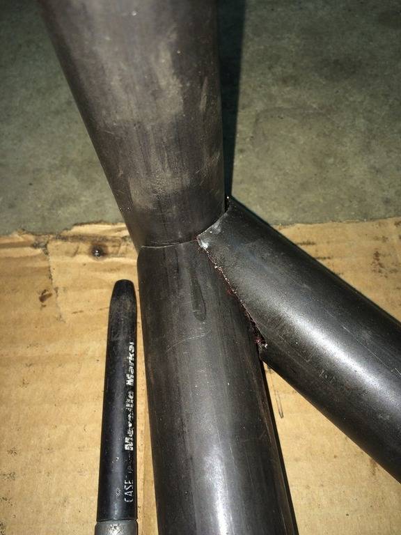

The rear joint was tricky to cut where three tubes all met but I got it figured out.
So you worked the tig pedal with your middle LEG??:thumbsup:

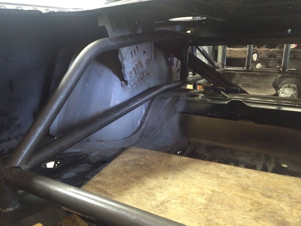

Both rear frame rails are in. I still have to weld in bracing and weld out everything else before they can go in permanently.
man mike its looking sinister already. the bars look spectacular. maybe summer 2017 our projects can meet up. i can't wait to see this car.
