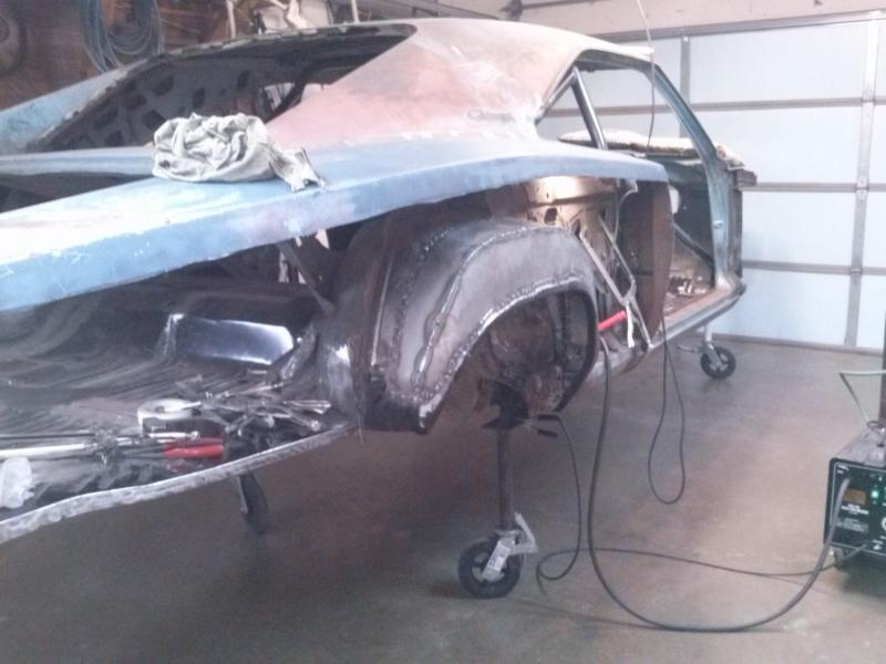

Sounded like you were talking about opening up or maybe dehumping the wheel wells for your outer vertical tire clearance. 747 and I both did that and there are plenty of pics of how we did it. Someone on here did it with the quarters on, I forget who tho.
I already mini-tubbed them and dehumped them but what I didn't do is round out the top or raise the top of them to get more clearance on top of the tire for the lowered ride height. It's gonna be a real pain to do it now that all the metal is back on and the cage in.
I definitely need to consider doing this mod.
