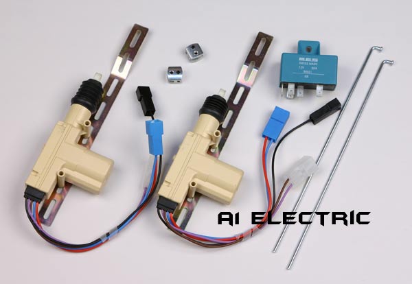

Power door locks
That would be cool to have! One day im going to have to break down and buy my wife one of these systems, Handy!
