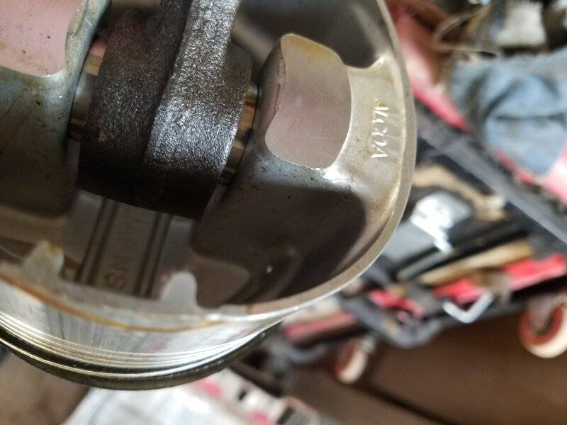

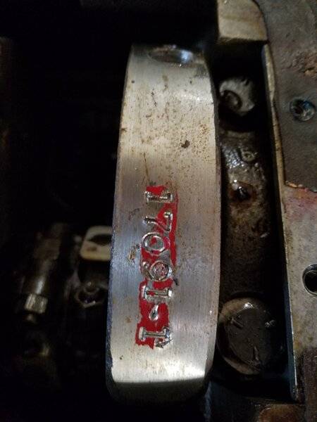

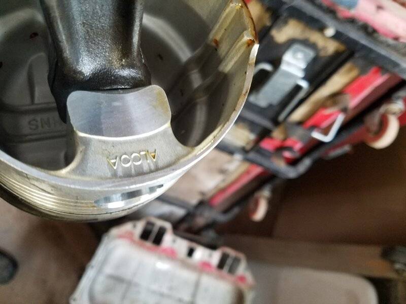

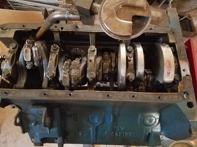

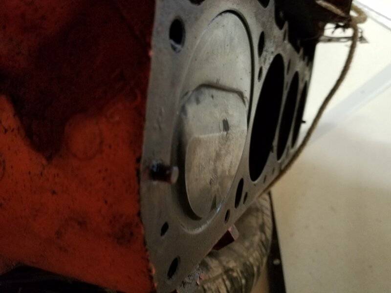

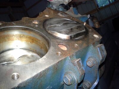

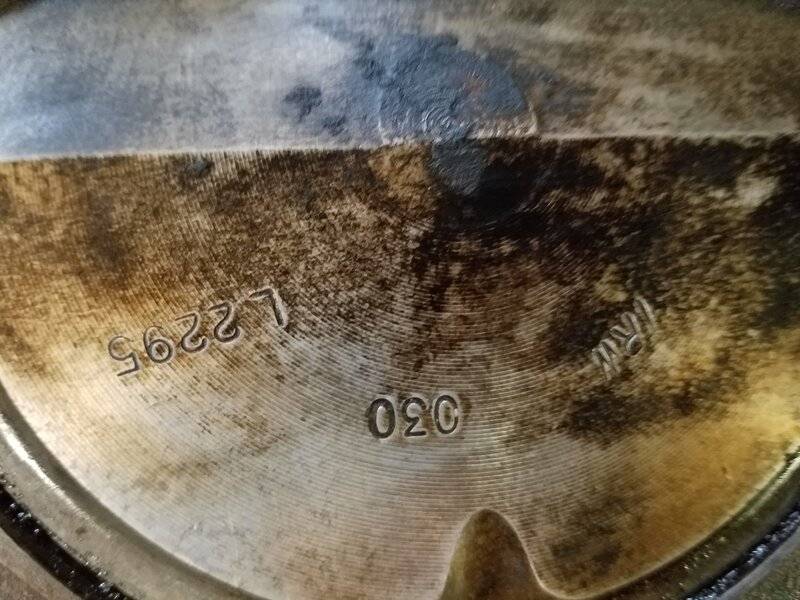

Here's the pistons in the 413 and the crank had a number stamped in it nothing stock but the block.The 440 needs a good deal more parts and work. The 413 bearings crank and rods look new as do the pistons, I was thinking about putting 906 heads on the 413? You can see how high the pistons are above the deck,name on them is Alcoa ,Jahns stamped pistons and push rods are light as a feather?oil pan and sump deepened

413 sounds better. Looks balanced. Is there a ring ridge? If not, or just little, you could hone and go for it with new rings. I’d use the 906 heads with the crane valve gear. Compression looks evil, I’d use thick head gaskets and a big cam or it’ll knock Badly.
No ridge atop I can still see the hone pattern in the cylinder walls
Sounds promising. Could be a hone, some rings, cleaning and measuring away from a short block. Depends on your priorities and what you want out of it. If money is no object you can just go build whatever you want or if every drop of power is essential then go with the 440. For all the 413 naysayers remember that in 60’s form a 383 magnum was rated at 335, a 440 magnum at 375. This is 2/3 of the way in between. Those heads and valves don’t get any bigger as you add more cubes. Hotrod over the years has built both in dead stock form as well, the 383 and 440 were only 20 hp apart in that comparison.
Agreed cost is always a concern for most of us. However sometimes you need to take inventory of what you really have. The 413; The pistons aren't Alcoa. That's an aluminum company. They are Jahn's. By the the looks of them, pump gas is out of the question. Could the tops be milled? Maybe, the thickness needs to be checked. The ports on the heads are huge next to the intake. Will it seal? Is the porting any good? How about the guides and valve job? You need to pull the valves and look. It all looks like it was done decades ago. The 440; These pistons can be milled to make them flat tops. Think pump gas. How are the cylinder walls? What is the piston to wall now? How does the crank look? What cam is in the 440? What kind of shape are the heads in? It looks like both would need a timing chain set, gaskets, etc. Home honing lapping the valves, new rings, bearings, lifters, timing set, and gaskets may get it done. Perfect? Nope, but it may be feasible. Or maybe not. You need to to a lot more detective work.

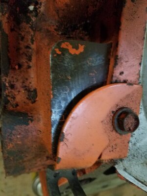

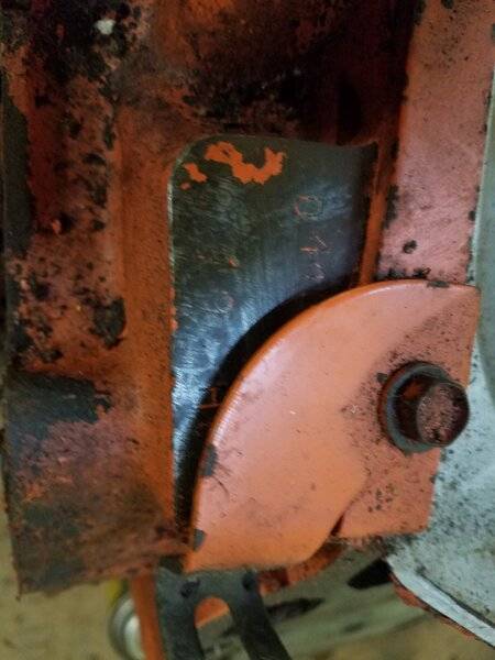

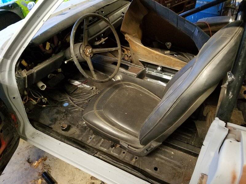

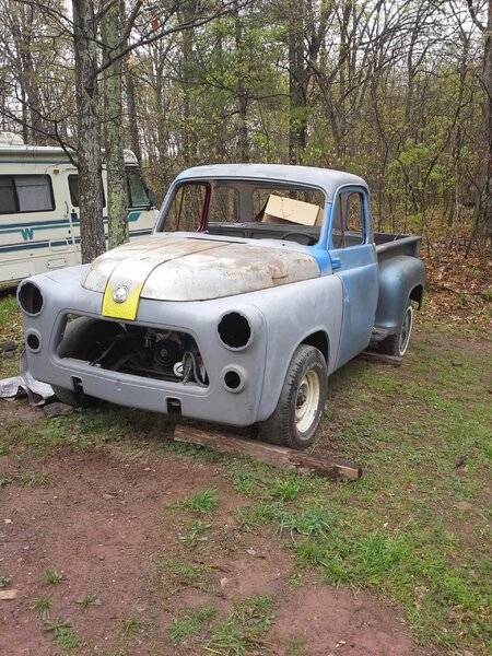

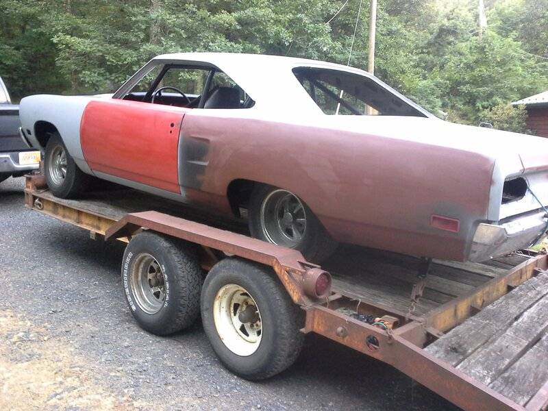

I'm going to use both engines one for the beeper which is tubbed, half cage ,floor stiffened with tubing ,the picture those are 10" wide tires on 15 " cragars and the other goes in my 55 dodge truck which is on a 72 step side frame and chassis not tubbed just stock.Truck more a cruiser,road runner car show driving around shorter and occasionally I hope a trip down the 1/4 no tracks close by.Both 727 auto builds ,i have brand new tci 3500 stall converter for the car.
