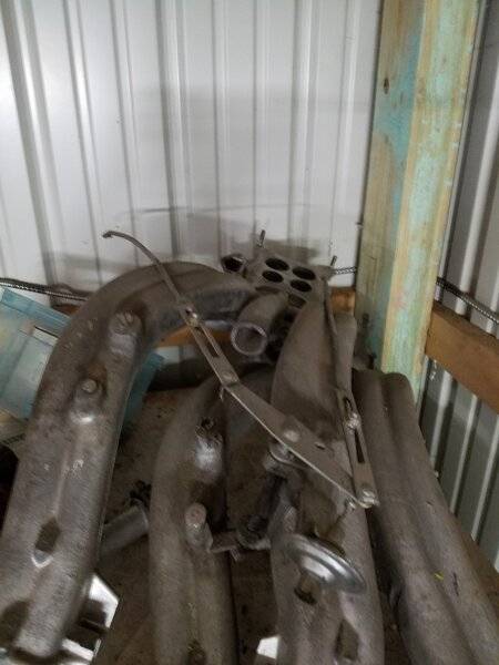

Oh yeah forgot the truck gets this intake
