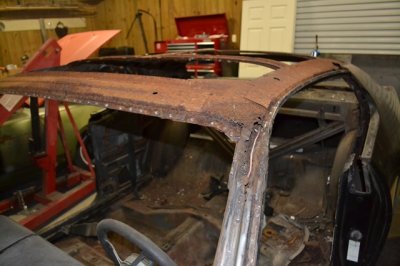

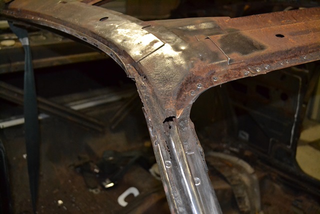

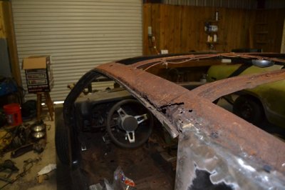

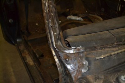

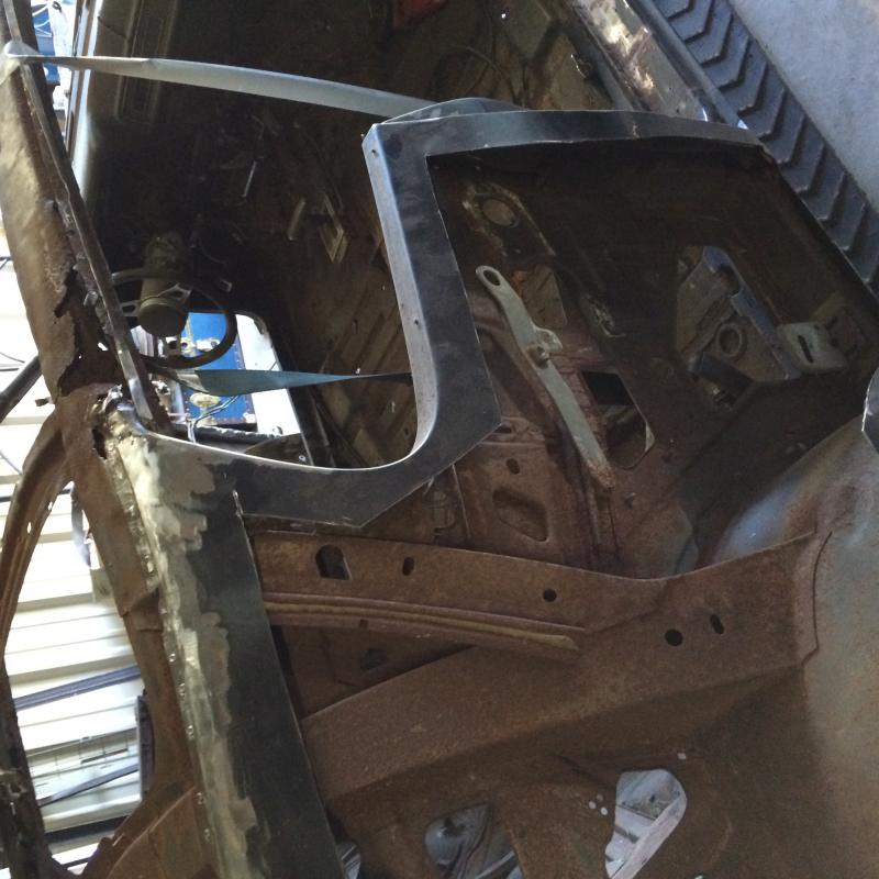

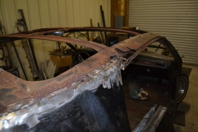

Here are some more pictures that show how bad the roof and A-Pillars are.
The parts car roof is completely solid from the C-Pillars to the A-Pillars. I am thinking the best approach is to just take the complete roof from the factory seems. What do you think?

get all the hard parts you can get from the donor car. take it apart and clean it up good, and USE IT. its a good thing to have a donor. not just for parts either.

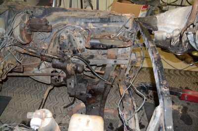

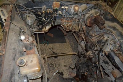

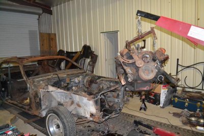

Engine is out, and it's was a first time for me. What a PITA it was doing it by myself - was quite a learning curve getting that thing out.
Dash will come out this week sometime and then I will get to removing the rear quarter panels. There is a restoration shop here in Texarkana that is going to handle the actual roof swap - I just don't feel like my skills are at a level where I won't screw it up.

The roof swap isn't really too hard to do if you can weld. It's basically a matter of drilling out a million spot welds and placing the new roof skin back in place. Plus it gives you great access to the inner structure.
You can do it !!!!
You can do it !!!!

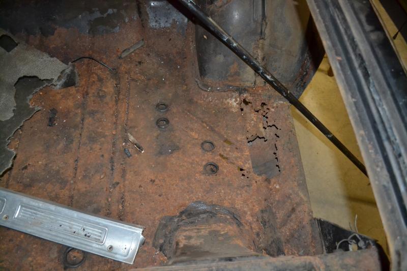

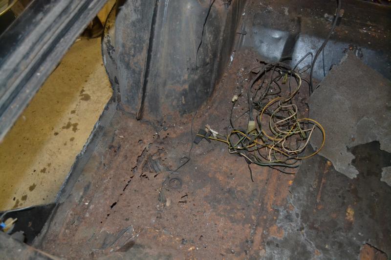

The problem I am seeing is the inner structure is rotted through in many places. I am going to work on getting the quarter panels off to see how the factory connected the roof. My welding skills are ok, but I really don't want to screw this up.
If your doubting yourself then definitely make the jump to let the shop do it. It will give you a breather to get other things done while you wait. Its tedious work if you can afford to pay to get it done then do it. They have the huge investment in the tools and equipment to make the job right and make you happy. Get as far along as you can and open up what you can so you can get the numbers on cost in advance and this will let you decide what parts you want to tackle and the parts you want them to address... Looks like a fun but albeit a stressful project. In the end look at the bright side how many people can drive a car and say " I built that"...

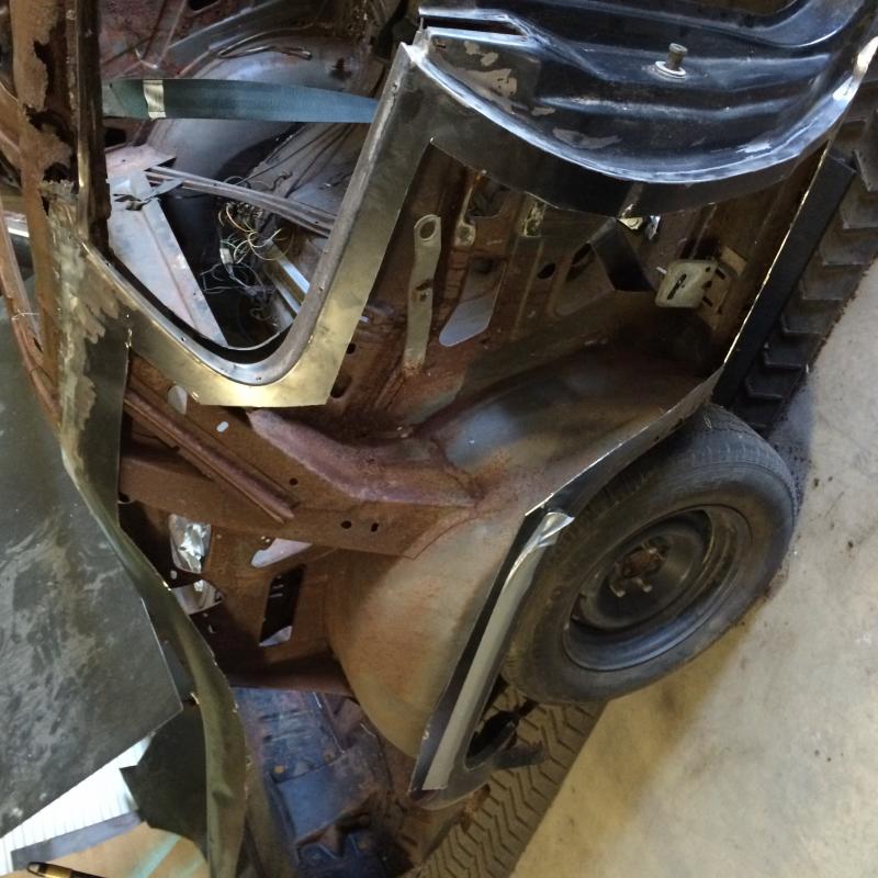

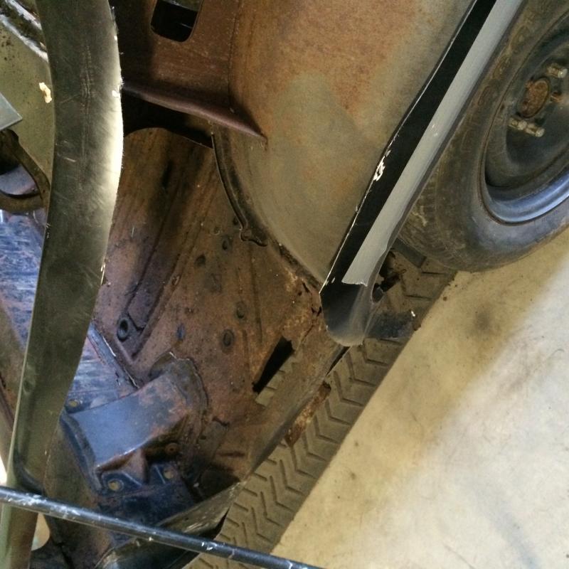

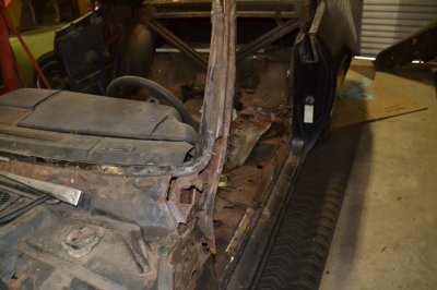

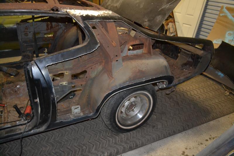

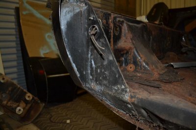

Started removing the quarter panel today. I don't get much time during the week, but I find just a couple hours working on the car after my shift ends, takes all the stress away.
Craig
Looks like you made some good progress. Tinkering with my cars is relaxing for me too. Keep it up!!!! Looks good !!!!!
I think I am going to get a portable blaster so I can clean some of the areas I am working on. With all the rust in certain areas, it is hard to see how certain parts come together. I appreciate all the comments, and when I look through some of your own restorations, it motivates me to try things that are a bit out of my comfort zone. I will probably still farm the roof swap out as planned, but I plan on starting on the back half of the car first, starting with the trunk & extensions and repairing the rot around wheel well areas. I also have some issues on the tail panel section that I need to address, and I will probably take the whole piece from the donor car instead of trying to weld a bunch of patches in.

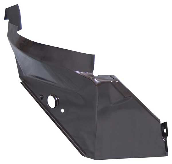

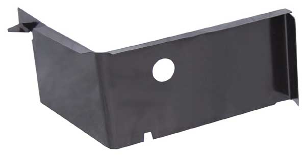

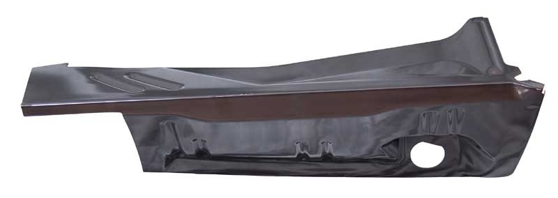

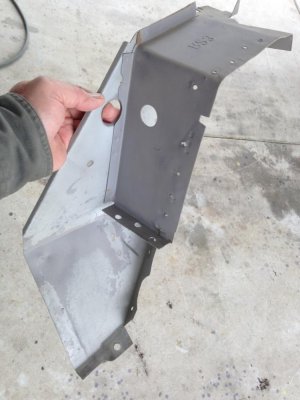

I bought new AMD trunk extensions for my car. Do yourself a favor and get these parts too, since they have to come out in order to replace the extensions.
This is actually two parts that are spot welded together from the factory.
http://www.autometaldirect.com/body...uarter-panel-reinforcements-c-23_145_302.html
They are called quarter panel reinforcements.
872-1471-1L left side @ $44.99
872-1471-2L also at $44.99
try the link again, Sorry.................

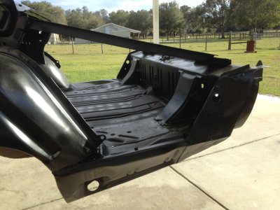

840-1471-L Trunk Floor extension, $139.99
and how they all fit together.

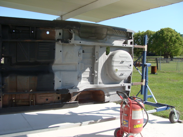

I use a small portable blaster that holds 80 pounds of material. You will need a good compressor to keep up with it. There are numerous posts on here about that. Just make sure you wear the proper protective equipment and don't use silica sand.
Hope this helps you brother...................... Don't hesitate to ask any questions.

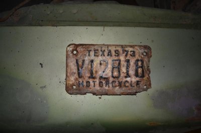

I broke out the plasma cutter the other day and in 5 minutes was able to cut the outline out of the other quarter panel ! I also found an old motorcycle plate in there. Pretty interesting the things you find.
