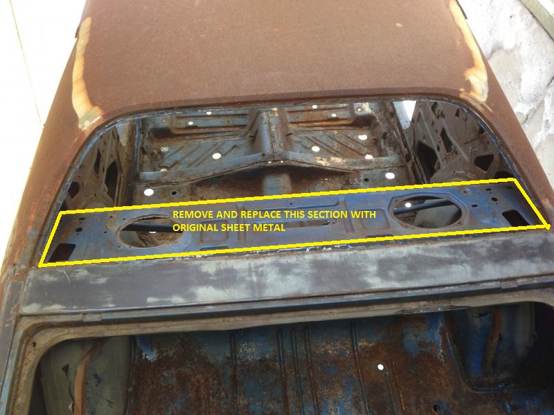

Changing out the package tray too !!!!!!!!!!
I have some really nice package trays available too.
It looks like I can now change out my package tray as well, thanks to Moparmarks. Great place here on FBBO!!!!! I'll definitely be posting some photos of this ....................

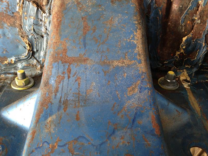

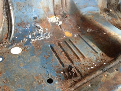

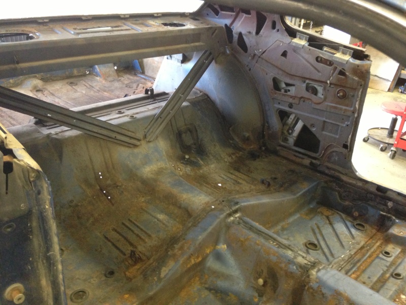

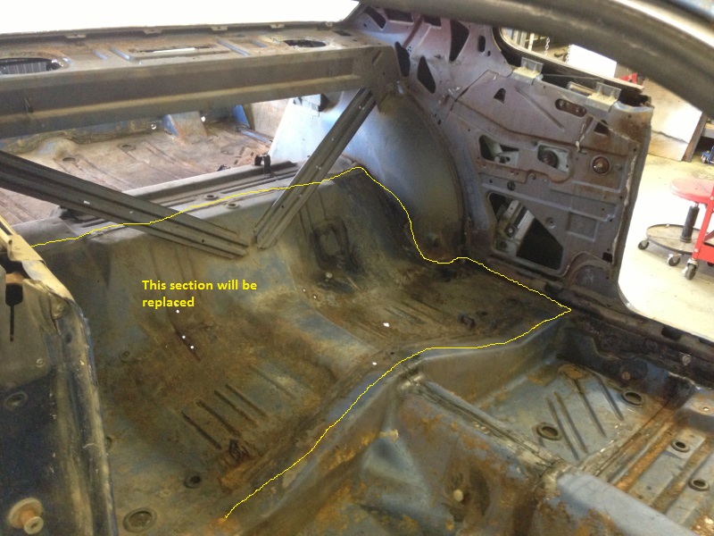

How bad is the passenger side under seat pan on your 71?
I can't really see anything in the photos.
The reason I ask is because I have some localized rust damage in one spot on my pass side under the rear seat. It actually looks like my car slipped off a floor jack one time and crushed the area... allowing water to sit only in the kinks.
If yours is solid right there I might be interested in it.

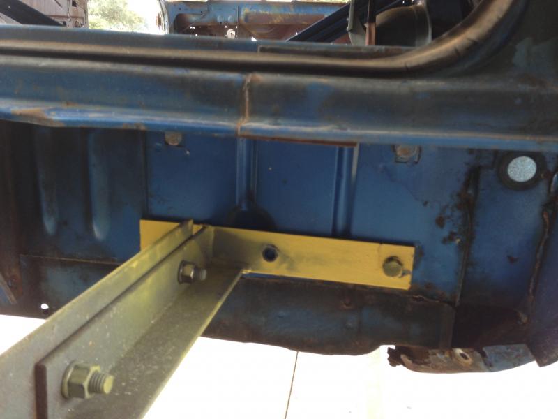

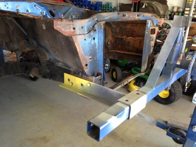

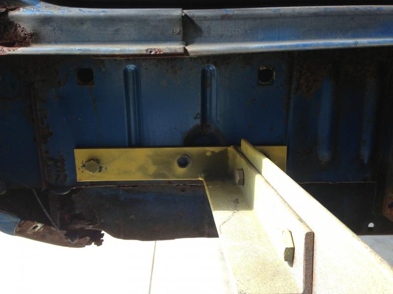

Rear Mounting on Rotisserie
Great info on the power washing! I might give that a go myself. Could you post a pick of how your rotisserie is bolted to the rear bumper mounts? Is there any metal inside the trunk added for support? Thanks!
Here are a few photos. Sorry it took so long to post them. Hope it helps you with your car.
Sorry, mine is pretty bad in that spot. The pictures with the rust holes I posted above are of the passenger side.

Your welcome. Tomorrow I will try to post a few photos of how the rotisserie is attached on the front end of the car for you.

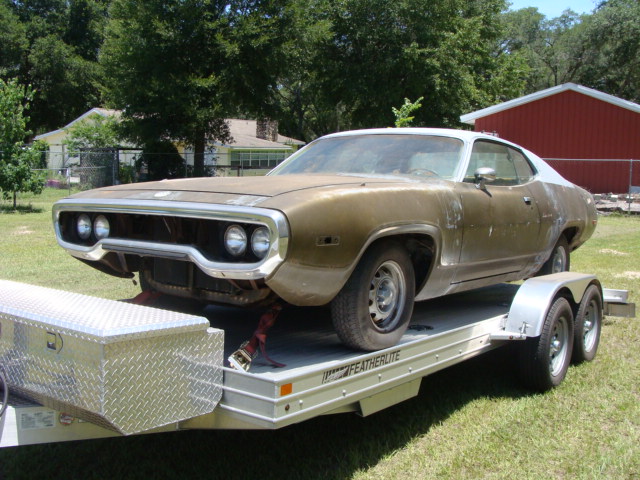

I spent the last 2 days removing all of the bolt on sheet metal parts and front disc brakes from this 72 Satellite that I originally bought for a parts car for this project.
I need these parts for my 71 Road Runner.
The more I remove from this car, the better the body shell looks. This so called "parts car" is 10 times better rust wise than my "Dirty Bird" is. I mean the floor pans, firewall, inner fenders, frame rails, trunk floor, etc..........all rust free. But she will need a full OEM style driver side quarter panel, from previous damage and rust issues. The passenger side quarter could probably be fixed with a lower rear patch panel. The roof has been blasted down to bare metal after someone removed the vinyl top and chrome trim.
The 318 with automatic runs good and the AC is still holding a little Freon!!!!
Someone years ago removed the original carpet and body plugs, which saved her from rusting.
So I vacuumed the inside of the car so the floor can be easily seen. I have been replacing all of the bolt on sheet metal with the old parts from my 71.
This car is just too good to cut up. I have a clear FL title for it registered to me.
I'm planning on trailering the 72 Satellite over to the 'Mopar's with Big Daddy" show to sell it at the swap meet, and score some new AMD parts for the Bird while I'm there.
It will make a very good solid body restoration candidate for someone else. I would keep her, but I still have my 2 Challengers to restore.
Now I'm really glad I decided not to cut her up for parts.........
It's a good show and is always on the first weekend of November.
Maybe I'll see some of you all there.

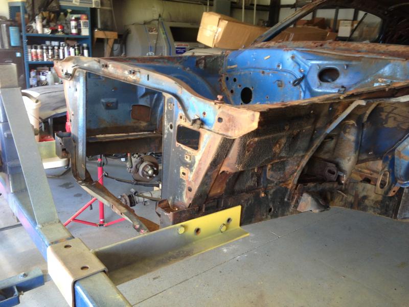

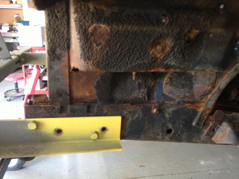

Front Rotisserie Mounting
AWESOME!!! Thanks again :VB toast: :VB toast: :VB toast:
Here are the pictures of the front as promised.

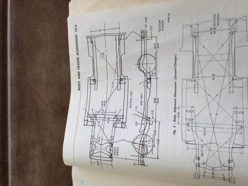

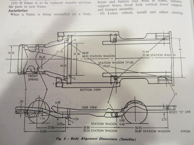

Does anyone have the factory frame dimensions for my RR?? If so could you please post them or send them to me in a PM???
Thanks in advance.
My book is for 72 Dodge and I'm not 100% sure if the 72 Charger has the same dimensions as a 71 RR.
If anyone knows for sure please feel free to chime in.
Thanks.

Thanks for the dimensions. I compared them to my 72 Dodge chassis service manual and they are identical. I had a strong suspicion they were, but was not 100% sure.
