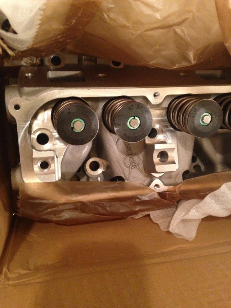

I have a new set of 440 Source "Stealth" aluminum heads that I originally bought for the 71 RR. Now it looks like they will get installed on the Stroker engine. I've been thinking about doing some mild pocket work on the ports, gasket matching the port openings, upgrading the valve springs and retainers, then CC'ing them before they are bolted on.

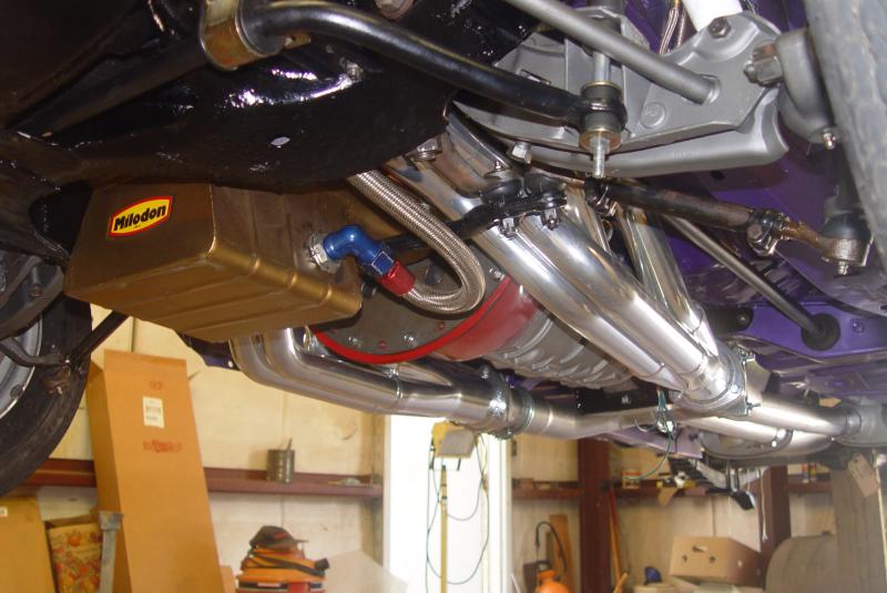

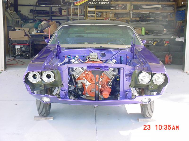

Here are a few more pictures of the Challenger during it's assembly. I ended up re routing the fuel line braided plumbing and swapped out the cast Indy valve covers for a set of MP ones.
The skinnies are not on the front any more. They were just to roll the car in / out of the shop. It has a Milodon pan with external lines and swinging pickup. TTI 3 inch exhaust, Dual Disc clutch with a Lakewood housing,
and a 6 speed manual trans!!!!
Back when we started this project in the early '90s, we were the 1st people in the US to get a 6 speed gear box for a Mopar. We had to fabricate EVERYTHING !!!!
Now its available in a kit from several sources...............

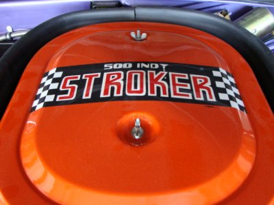

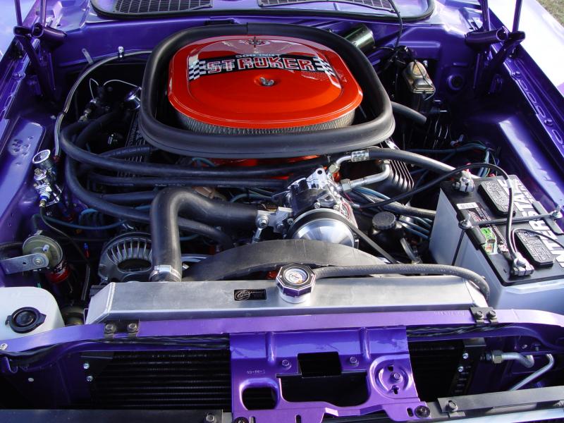

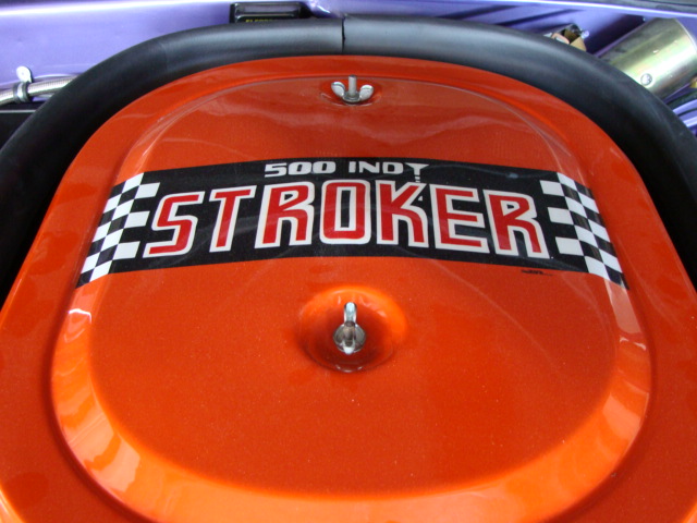

My next door neighbor is a pin stripe / air brush artist. I asked him to take the original font and style from a 440 "Six Pack" air cleaner decal and make up something cool that would be a little sneaky too......
Notice it says "500 Indy STROKER" and incorporates the INDY logo with the "valve" as a letter "Y".
I cant tell you how many times people have walked past the car looking it over and as they walk away the air cleaner hits them. Then they come back and look at it again............
I think my neighbor nailed it pretty good. Its all free hand and air brushed. I cleared over it when the art work was done.
